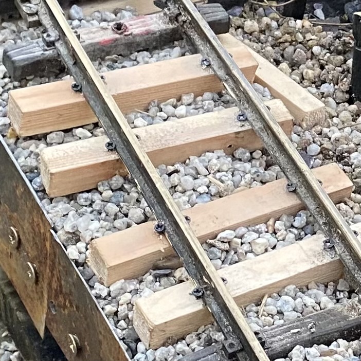

That’s almost exactly what I ended up doing but with M2 self tapping screws for the first bit. I used panel pins for the next bit but without the half moon shape (because I didn’t think of it). Two more places to do still
I’ve now sorted out the warp visible in this The sleepers here are about a foot long and extend under the siding embankment. Their job is to try to pull the kink out of the joint. Partially successful, I’ve no way of fixing them to the slabs so I’m relying on friction

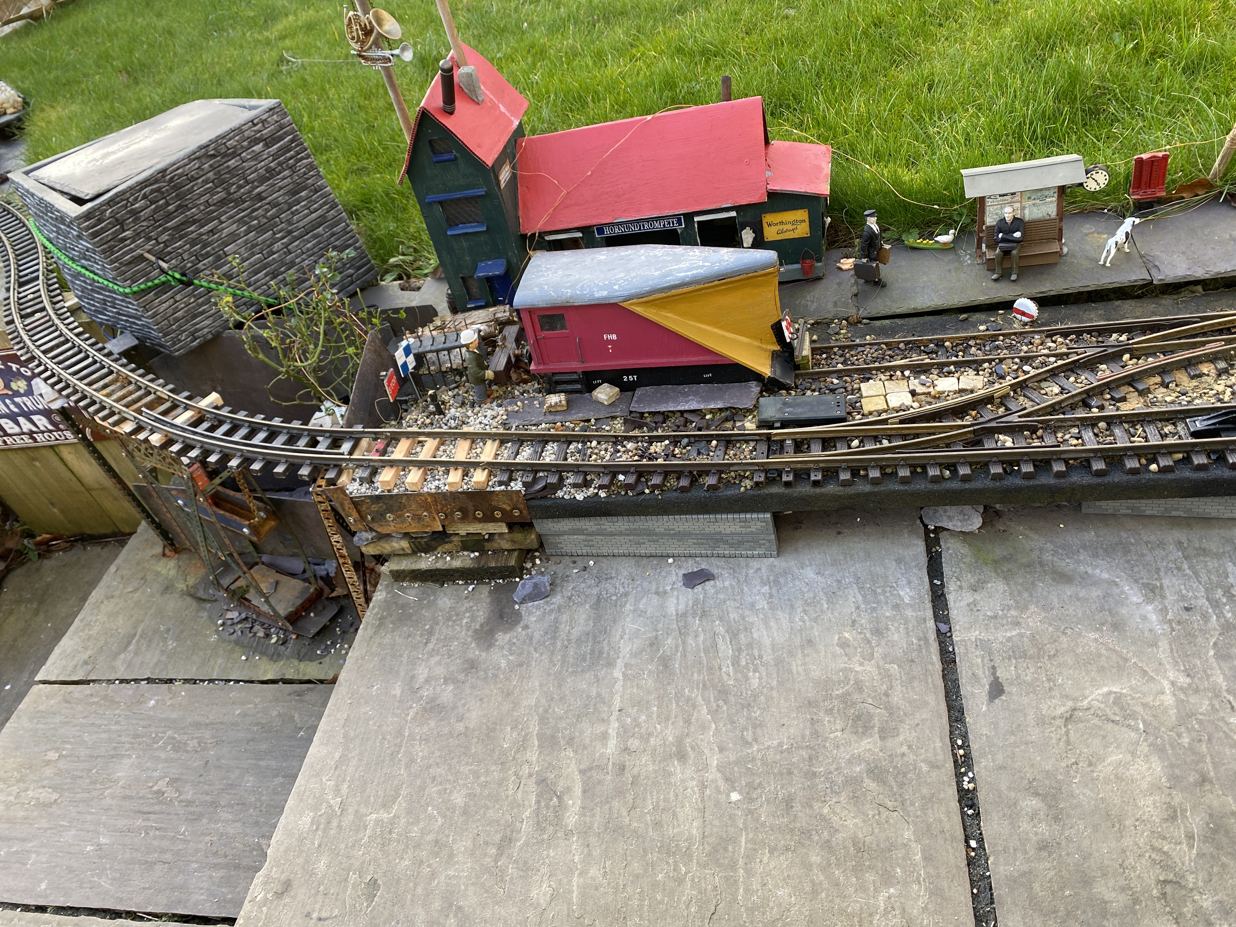

It would, but there isn’t room. It’s not a massive problem though, it’s only a headshunt extension and at the end of a baseboard. The track is floating nicely on ballast and I’ll reconfigure the station when I replace the plank it’s sitting on.
I had to take the main line lot out again this morning as they had slipped out (I thought they might) so not only was the kink back but the hump that appeared was working better than my actual uncoupling ramps!

If I was faced with that problem I would bite the bullet and replace the section with a new piece of rail.
The issue I see is that there is a straight piece in the middle of a curve that has to be bent to fit the curve.
If you put a straight edge down the middle of the track at the end of the curve and the straight on the opposite side you will see that they do not line up which if trying to put a straight piece in the middle will give a kink.
I would cut the rail near the buffer remove the piece back to the joiner near the end of the curve and insert a piece of rail that is bent to continue the curve into a transition.
If I have to join rail in the middle of a curve I solder a joint in place while the rail is straight then bend it, when I fit it I secure the rail on both side of the joint to help relieve any tension at the site.
Sometimes lifting track even though it is a pain is the best course of action for permanently solving a problem.

It’s smack in the middle of two flexible track sections and also smack in the middle of a granite slab! I can live with it; it doesn’t cause any problems. Just looks messy. We had literally just had the (tiny) garden extensively remodelled and landscaped to what we’d wanted for 20 years when I was given an LGB starter set. I have to work round what’s there. Of course, if the railway had come first…
