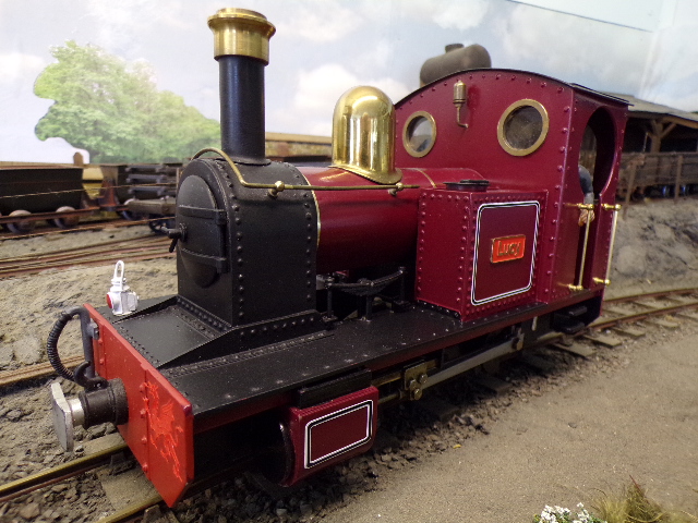

Sir Clothem Cap wrote: Sat Dec 02, 2023 8:55 am Wow, I'm missing a trick with the lining. I find using it on live steam is fine as the tanks don't get too hot
This is the last one I did. The whole thing is 3D printed, even the nameplates are 3D printed in resin and just painted.

That is veeery impressive Steve, you are tempting me now! :lol: I'm not sure that the amount of lining I do would justfy the cost. Is it much use for anything other than railway lining and lettering?
How do you do the designs, is there special software?

That looks great Steve, another useful tool for railway modelling.

philipy wrote: Sat Dec 02, 2023 10:19 am That is veeery impressive Steve, you are tempting me now! :lol: I'm not sure that the amount of lining I do would justfy the cost. Is it much use for anything other than railway lining and lettering?
I use Tinkercad to do it and export it as an SVG, which is what the Cricut uses to cut files, as well as laser printers. When exporting as an SVG it takes whatever is on the base layer as the cutting shape, so it's just like exporting it as 2D, I am sure Sketchup and the like have similar features?

Peter Butler wrote: Sat Dec 02, 2023 10:40 am That looks great Steve, another useful tool for railway modelling.
Thank you Peter, I am glad you like it. I could not justify the cost for railways alone, but the wife has the Cricut for cards, vinyl cutting etc, so it makes sense to make it a multi purpose machine, or at least that's my excuse, lol :lol:
