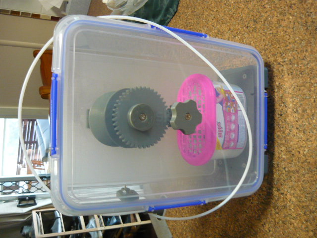

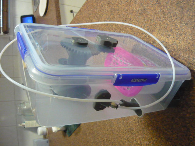

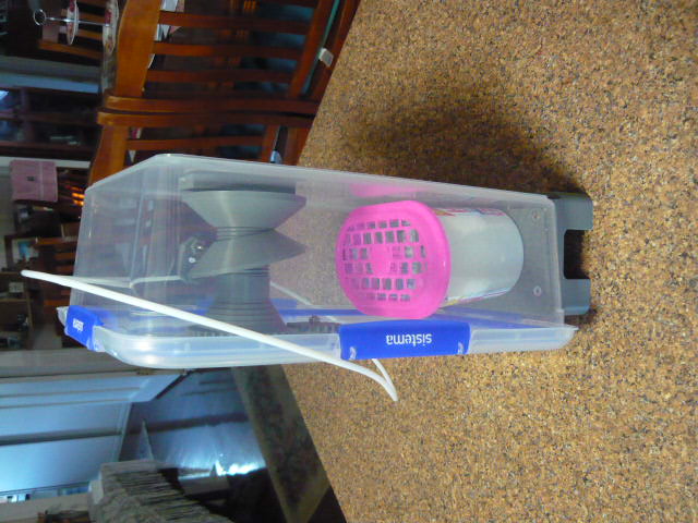

- GAP
- Posts: 887
Re: DIY Dry Box for 3 D Printing
I had printed the parts for two of these dry boxes and once I had them together I realised that the rewind mod would be very handy.
https://www.thingiverse.com/thing:4787740/files
Note; I did print a 7mm wedge to straighten up the box so it did not have such a lean toward the back (bottom of the box) and it stood up straighter.
After printing parts for close on 30+ hours, I had all the parts to build my first dry box with a rewind feature.
https://www.thingiverse.com/thing:4909334
The parts for a second one are on the printer and should be ready in 10 hours (tomorrow morning).
Mod time was about 10-15 minutes.
This has been by far the largest print I have done, but it was worth it.
Price wise I will use about half of a $30 reel of filament, $7.50 each for the box and the dehumidifier pack, so for about the cost of a roll of filament I have a box where I can store reels till they are spent all nice and dry.
Any future builds will have the geared spindle as standard, I had to replace the original so I now have 2 spindles spare that I looking at re-purposing.
When putting into a slicer you will have to take parts from both Thingaverse pages
Overall I am very pleased with the boxes as they will suit my situation perfectly.
Of Note there are a couple minor niggles that can be worked around very easily they are;
1. Sistema have changed the design of the food containers so that the clips are now on the lid so the locating slots on the base plate have no where to slot into.
2. The recommended bolt for the rewind handle is to long at 40mm I found it fouled the side of my filament rolls so I cut mine to 35mm to give clearance (35mm lengths are available)
https://www.amazon.com.au/SECCARO-Stain ... B07QHVK39C
Front showing gear on the spindle RH Side showing filament outlet and the plug that seals off the PFTE tube when the box is not in use. LH Side showing the dehumidifier pack
