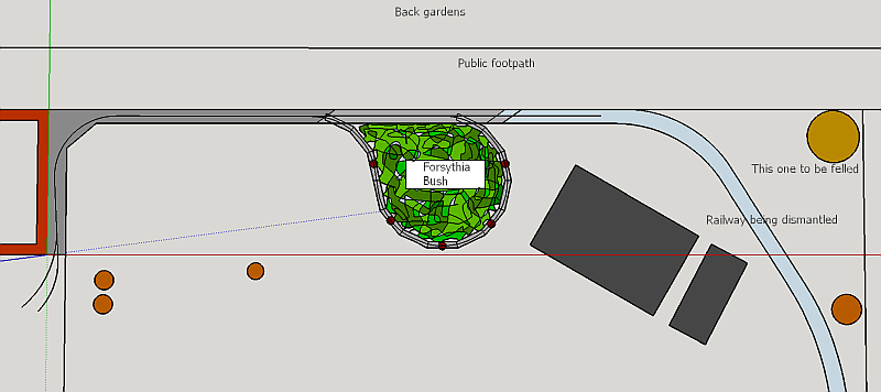

So I said to SWMBO that I didn't know what to do and might rip it all up. To my surprise she said, "No don't do that, can't you just cut it short? What about taking down the old shed that you've always talked about doing?" . Just cutting it short doesn't really work, I'd just be left with a 10metre long siding! However there is a large Forsythia bush in just the right place to put a loop round - the straight track runs behind it at present and adding a 4ft radius loop goes round it nicely.
So thats what I've been doing for the last couple of weeks: Shed taken down and disposed of, a lot of vegetation trimmed back, the guttering on the end of the garage altered, holes dug for track supports, decking boards cut up and screwed together and roofing felt fixed to the top. So now I'm about ready to start tracklaying! :woo
That is of course why I was asking about sprung points in my other recent post.
This might make my ramblings a bit clearer!
Screenshot 2023-06-29 07.58.07.png (76.64 KiB) Viewed 130355 times
Still a lot of tidying up to be done of course.
This is Phase 1, because of course I no longer have a continuous run - although in practice I haven't had one for several years because the track distortion made it impossible. However, Phase 2 involves some major civil engineering at the other end of the line and the plan is to raise Lower Bench station to the same level as the rest of the line and join it back on, to create a loop at that end as well. Watch this space, but not too closely!

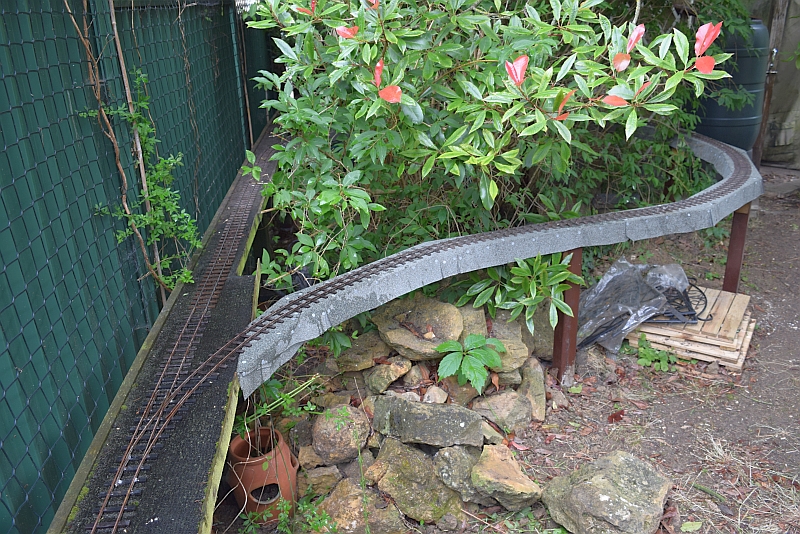

You may have seen my other thread regarding sprung points ( https://gardenrails.org/forum/viewtopic ... 83#p174283 ) so I won't go into that again here, except to say that I have now used fixed point blades and all trains will be going round the loop one way.
...and showing the track going round the loop.
