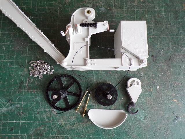

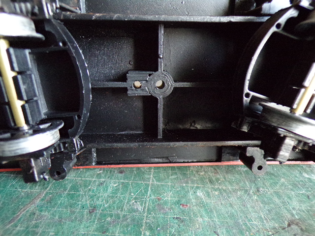

The four bogies have now been stripped down to remove the axles and wheels (very neatly running in brass tube and clipped into 3D printed holders, similar to Swift Sixteen). Also, the magnetic couplings have been removed, simply because I don't use them and now is not a good time to replace all of my couplings!
In fact, they are incredibly powerful and automatically locate perfectly with each other.
I have managed to remove the magnets on two of the couplings and attach a standard buffer in their place....
You can see the bogies have now been painted, lightly weathered, matt lacquered and reassembled.
The magnetic couplings between the two trucks have also been replaced with a brass bar to permanently couple them together.
More parts have been disassembled in order to get a better paint finish (I hope!) ....
It's a real adventure but most enjoyable.
(two of my friends are proud owners of these models now so it will be interesting to see them running together)

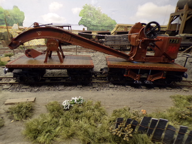

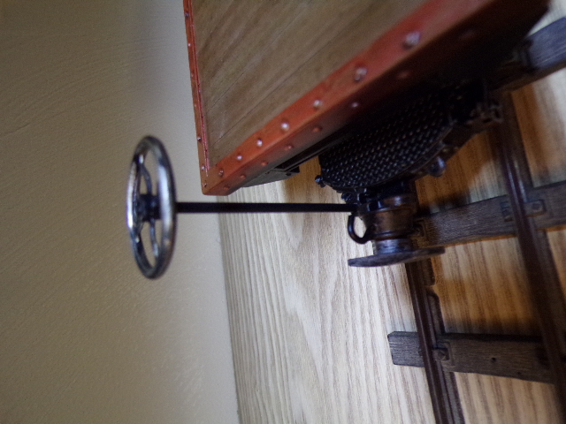

More modifications have now been made, including diagonal stays which connect the lower part of the counterbalance weight to the top of the winding drum housing. Also, a hand-wheel brake column on the bogie behind the counterbalance. Both of these features I found on a detailed drawing which was posted on 'G Scale Central'....
Due to the fitting of the brake wheel it became necessary to move the crane pivot point forward by 10mm to allow the bogie to swing without striking the weight box....
The outrigger screw jacks had to be cut down slightly allowing them to be fully retracted within the width of the wagon. They are held in place by pressing up under the flat-bed and behind the edging strip I fitted earlier....

That certainly looks as if it means serious business, Peter. Love the colour scheme.
The additions look spot on!
Very nice that Peter, loving the colours too. Hard to see how they can produce one similar or as good as yours.
That looks excellent!
Does it run well?

Thanks Andrew, and others.Andrew wrote: Fri Jun 09, 2023 9:48 am That looks excellent!
Does it run well?
- perhaps you could measure the height when you get a chance?
In answer to your questions, yes, it does run very well indeed. I have added a small amount of lead sheet to the underside of both trucks and allowed the bogies a little slack! Even the first test run, minus crane, was a great success. With the crane mounted it behaves extremely well with the jib rising and falling on its drum support. I will probably add a guide on top of the jib support to keep the jib centred as it negotiates curves. I also added a large diameter steel washer as a slip-ring under the crane pivot point, so it is now smoother in operation than plastic to plastic.
The overall height of the crane is 9' 10" (16mm scale), which is the top of the gear wheel operating the jib lifting gear.
Still to come are the four pads which go under the screw jacks to stabilise the crane when in use. These are not supplied so are currently in production on my workbench.

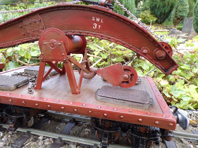

On this point I'm ahead of you Rik... not ropes, but chain! The 'pads' are also in place and represent solid timber 2'6" x 1'6" x 4" thick, each with 'steel' banding and carry handles, as per the drawing previously mentioned above. I doubt there is space for a toolbox as well.ge_rik wrote: Sat Jun 10, 2023 7:14 am...... maybe some extra ropes and straps for lifting????Peter Butler wrote: Fri Jun 09, 2023 2:42 pm Still to come are the four pads which go under the screw jacks to stabilise the crane when in use. These are not supplied so are currently in production on my workbench.

Finishing touches... to ensure the jib remains central on its support barrel I have fitted a bent brass rod. Before this I noticed the jib would slide to one side when rounding curves but not return to its central location. The full sized crane would be locked in a static position and the jib would move very slightly off centre, however, our curves are more severe and the crane must be allowed to slew otherwise derailment would surely follow!
This simple device works perfectly and is hardly noticeable. It still allows full operation of the jib without interference, if required, although I doubt very much whether mine will ever be asked to perform its tricks...
The final thing was to stow the hook in a fixed position to look tidy, nothing more!

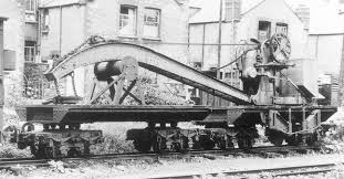

Attached is a photo of rhe prototype.
No sign of a toolbox or straps on the match truck. Dont think the cranes got used much! Best wishes
