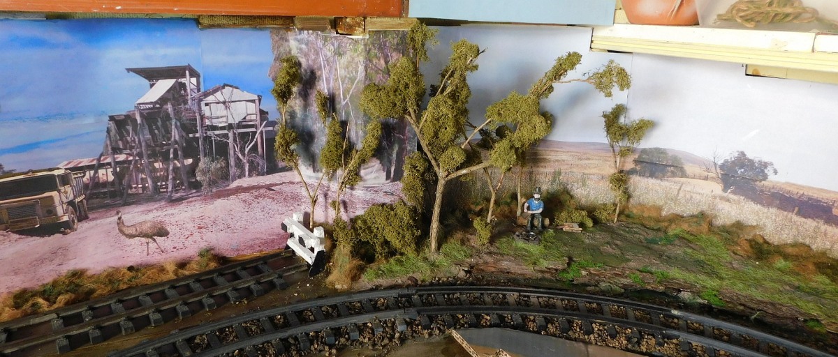

5. And the final segment is the old mine loader. It is another cutout as is the emu.
Then there is a short Aussie bush scene backdrop to transition to the farmland backscene on the north wall. The buffer stop, lichen-trees and swagman are all real 3D to hide the transitions.
6 corner transition.JPG (231.47 KiB) Viewed 40247 times
