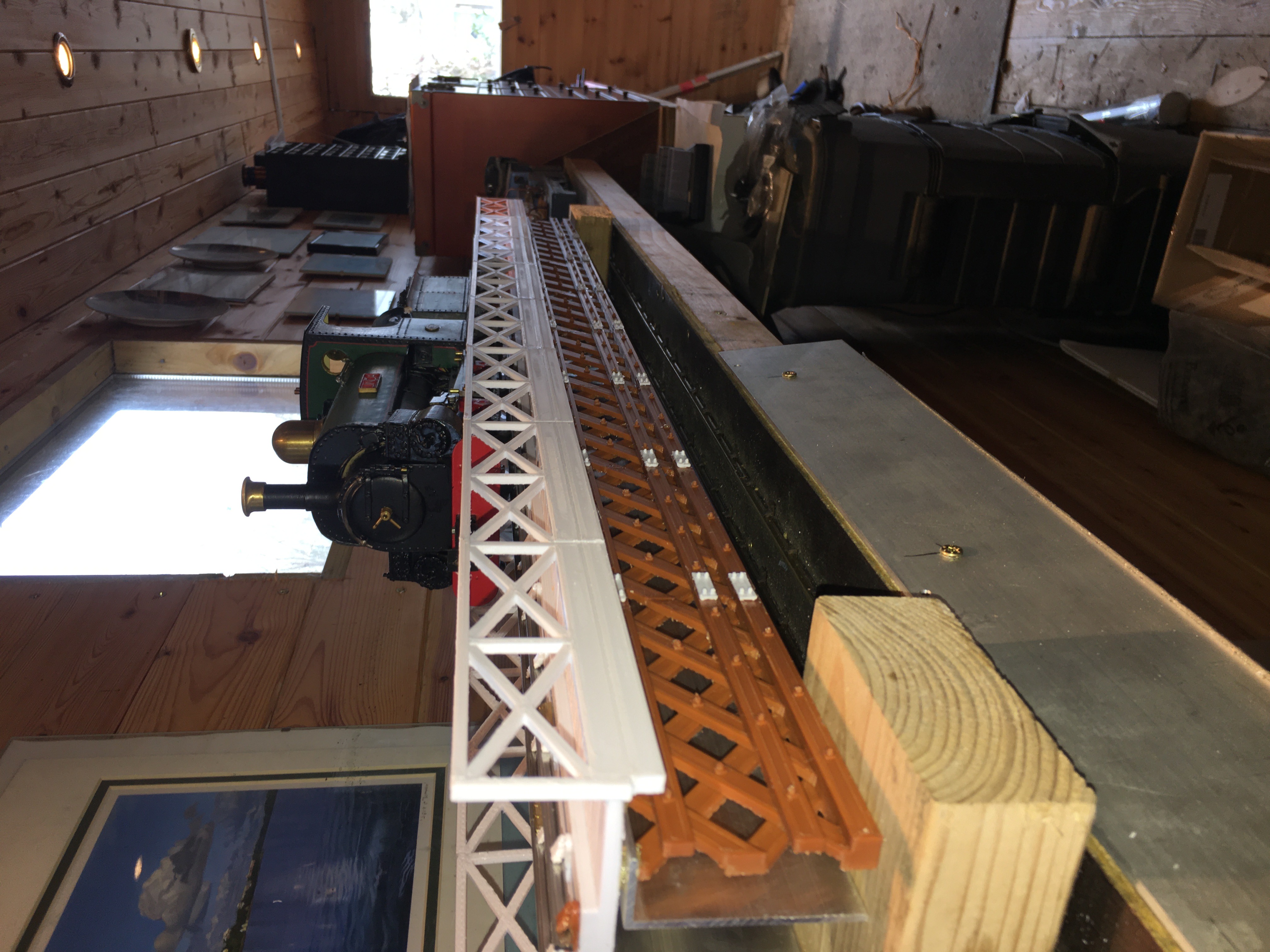

Both sides are covered in the lattice work. I have some deck printed. The rail fits in the chairs and it the deck fits in place. Rolling stock flanges miss the chairs as well:
However. The gauge is a bit tight. 31.25mm instead of 32mm. I think the deck would be better if it were a bit thicker as well. So I have modified the design and will start printing again. It will take a while as each piece of deck takes 8 hours to print. I think I will wait until I have 4 lengths ready before fixing it into position.

Trevor Thompson wrote: Thu Mar 09, 2023 12:11 pm I have some deck printed.
That really looks the part!

Yes printed in one piece. Had a bit of a problem with the printer - messed up the slicer settings and made the layer height too high, so the layers were not bonded properly on one section. The other section parted from the bed - part of the same problem. All sorted now. So starting the deck again wasn't really a problem. If you want the stl file for the chairs I can add it to the forum.

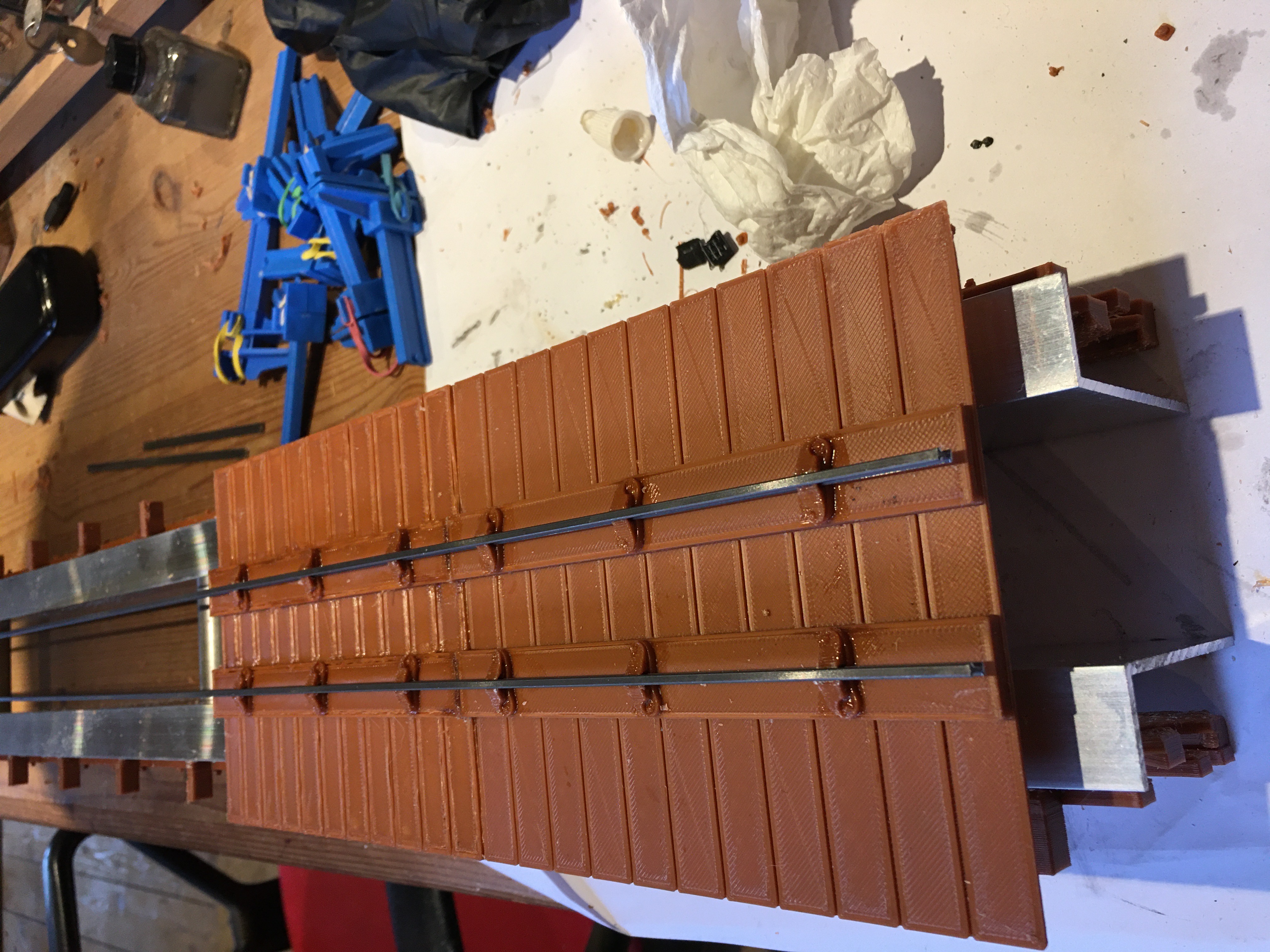

Post by Trevor Thompson » Wed Mar 15, 2023 5:47 pm
The deck is now printed and assembled with the rails inserted:
Excuse the different colours that I have used to print the deck, I wanted to use up what I had in stock before ordering more filament. It just needs the handrail added, and the first section of that is in place.
As an aside it is interesting what a difference the colour makes to the way the filament prints. The white filament seems to require a slightly higher temperature to print properly. I get consistent issues printing white - such as the sides of the chairs fall off readily and there are more stray bits of filament lying around when the print is finished.

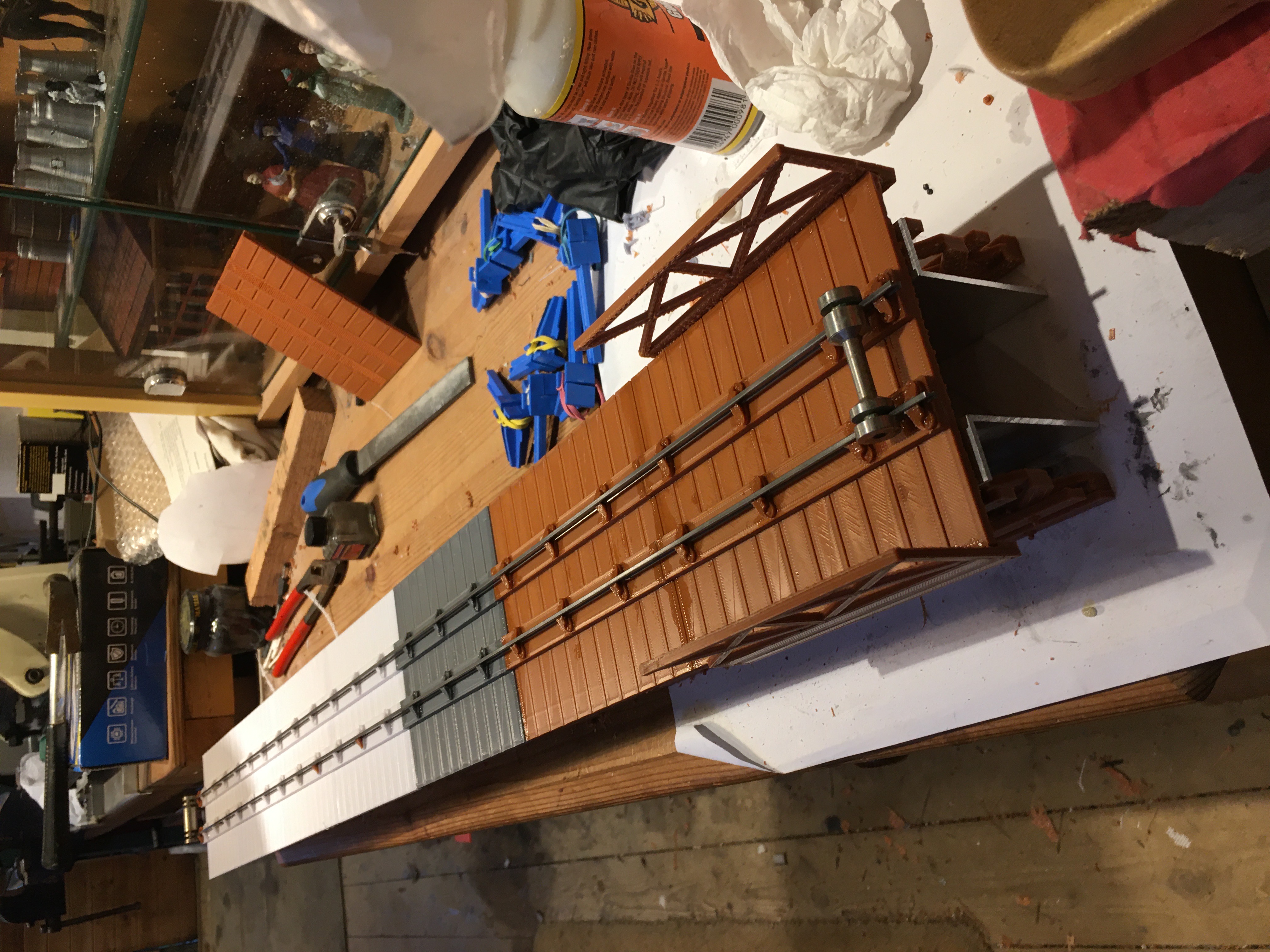

Post by Trevor Thompson » Wed Mar 22, 2023 1:28 pm
The bridge is now complete, apart from painting:
So I can put it aside until the trackbed catches up!

Post by Peter Butler » Wed Mar 22, 2023 1:47 pm
It does look to be a magnificent structure Trevor, a complicated item to build by any other means.

Post by SimonWood » Wed Mar 22, 2023 6:32 pm
Superb! Looks wonderful with Linda giving a sense of scale.
