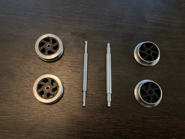

So, I thought that swapping the wheels over would simply be a case of buying the different wheels but it's not quite that easy.
The top photo shows the difference between the double-flange wheels and the single-flange wheels. The double-flange ones have metal bushes and they are a slip fit over the axle, which is permanently glued into the axle boxes. The single-flange wheels are a press fit on the axles and the axle is designed to rotate.
The first suggestion from Slater's was to drill out the axle boxes so that the single-flanged wheels could be used with their own axles. However, when I received the wheels it appears that the hubs are identical, so I wondered if I could use the single-flange wheels on the double-flange axles.
This turned out to actually be a very simple job. The single-flange wheels can be removed from their axles by twisting and pulling. Whilst they are a press fit, they aren't on ridiculously tight so that was fairly easy. The axles that come with the singe-flange wheels then becomes the perfect tool for both pressing out the bushes from the double-flange wheels and re-installing them on the single flange.
I now have single-flange wheels that will fit on the double-flange axle, ready to build the kit as designed. The only additional thing I will now have to do is to add some spacing washers to set the wheel gauge, as the single-flange wheels can't be allowed to float like the double-flange ones do.

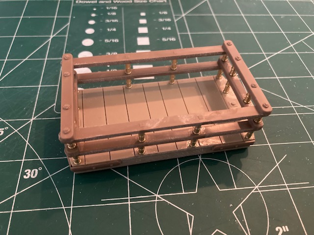

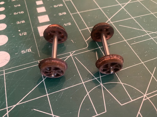

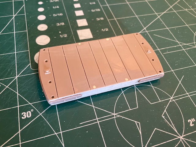

Re: Slaters Wagon Build and Kit Bash
First one (the standard build) is primed. The second one will be built as a flat wagon. This has been done before and is detailed in the link. I will be using metal rivets in the end holes, rather than cutting and re-using the rivets as shown in the link.
One set of wheels have had the rust treatment.
https://www.16mm.org.uk/2022/02/01/febr ... lab-wagon/

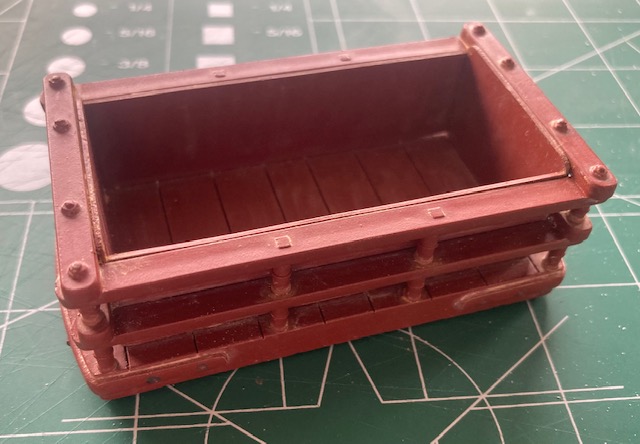

Second wagon converted into a coal wagon with Plastikard. The design of the original wagon doesn't allow the inserts to be scale, so it is just a likeness. It looks better in person than it does in the photo!
