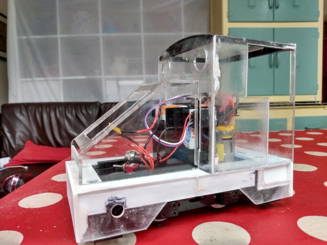

Just a little more progress to report, with the construction of the bonnet this morning. A sheet of plasticard will actually cover the whole front/top, but I liked it that you could still see inside, so I took the photo before it was finished:
KS 6.jpg (106.28 KiB) Viewed 43552 times
Once the bonnet's complete I'll attach it to the rest of the body, fill and sand as necessary and then pause for a think. I want to get a coat of primer on so I can see where further work's required, but first I need to consider how the cab detail's going to work...
Still a long way to go, but I like the shape that's emerging...

It did last night, when I underestimated the power of my daughter's hairdryer which I was using to bend the front of the bonnet. It buckled horribly, so it's off to the model shop for another sheet of plasticard...

Welcome to the lottery of heat forming polystyrene sheet. It's a very fine line between softening the stuff enough to form it and releasing the internal stresses so that it shrinks and turns into something resembling a potato chip. Acrylic is much easier to heat form as it turns rubbery, but doesn't shrink appreciably, when heated.
If all else fails, I've been known to 'plank' sharp bends and use filler and sandpaper to form a smooth curve in polystyrene.

It took some doing, but I think I've got the front of the bonnet sorted. I won't really know until I prime it, but I hope it's going to look OK...
On the original, the hatch seems to have given access to the gearbox (replaced by an additional door in the side on the Sudanese version?), but on the model it will allow me to get to the on/off switch and charging socket.
KS 7.jpg (124.28 KiB) Viewed 43690 times
