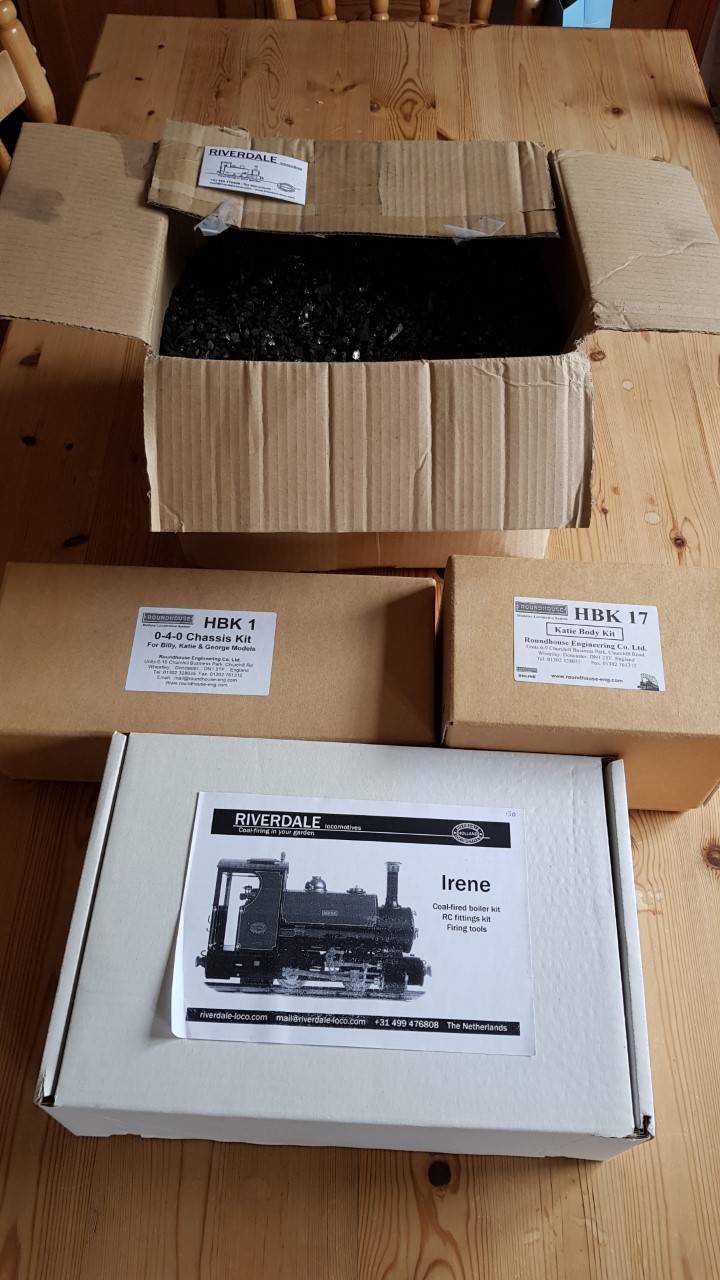

Look what I've found :D I genuinely can't believe it.
I don't actually have the kit yet (it is at my parent's house), so I don't know if it uses the same boiler jacket, but did you paint the boiler itself? If so what did you use to paint it (and the smokebox)?

It's a shame I hadn't been on the forum for quite a while or you might have got it sooner ! Maybe your ad in the Bulletin came along at just the right time to nudge me into clearing some dusty boxes from my shelf. I would have loved to build it but realistically I knew it might never happen. I'm glad I had what you wanted and you will get the chance to enjoy it.

I painted the boiler and smokebox with high temp satin finish BBQ grill paint. I used regular paint with a built in primer on everything else. All parts including the boiler got baked in the oven at 175'F for one hour or a bit more to cure the paint. It was then left alone for a day or so before assembling things. You will get a few scratches in the boiler paint during assembly, I know I did. I just sprayed some of that grill paint into a cup and touched up the scratches with a small brush. I also blacked all the piping and the Regner whistle that is quite visible between the frames just below the boiler. The chassis builds up just like a typical Roundhouse other than some mods you have to make to the exhaust lines so they will go up into the exhaust nozzle. Take your time, read the assembly book from Riverdale a time or two before starting to do anything. Feel free to post questions or pvt message me if you get stuck on something. Mike
