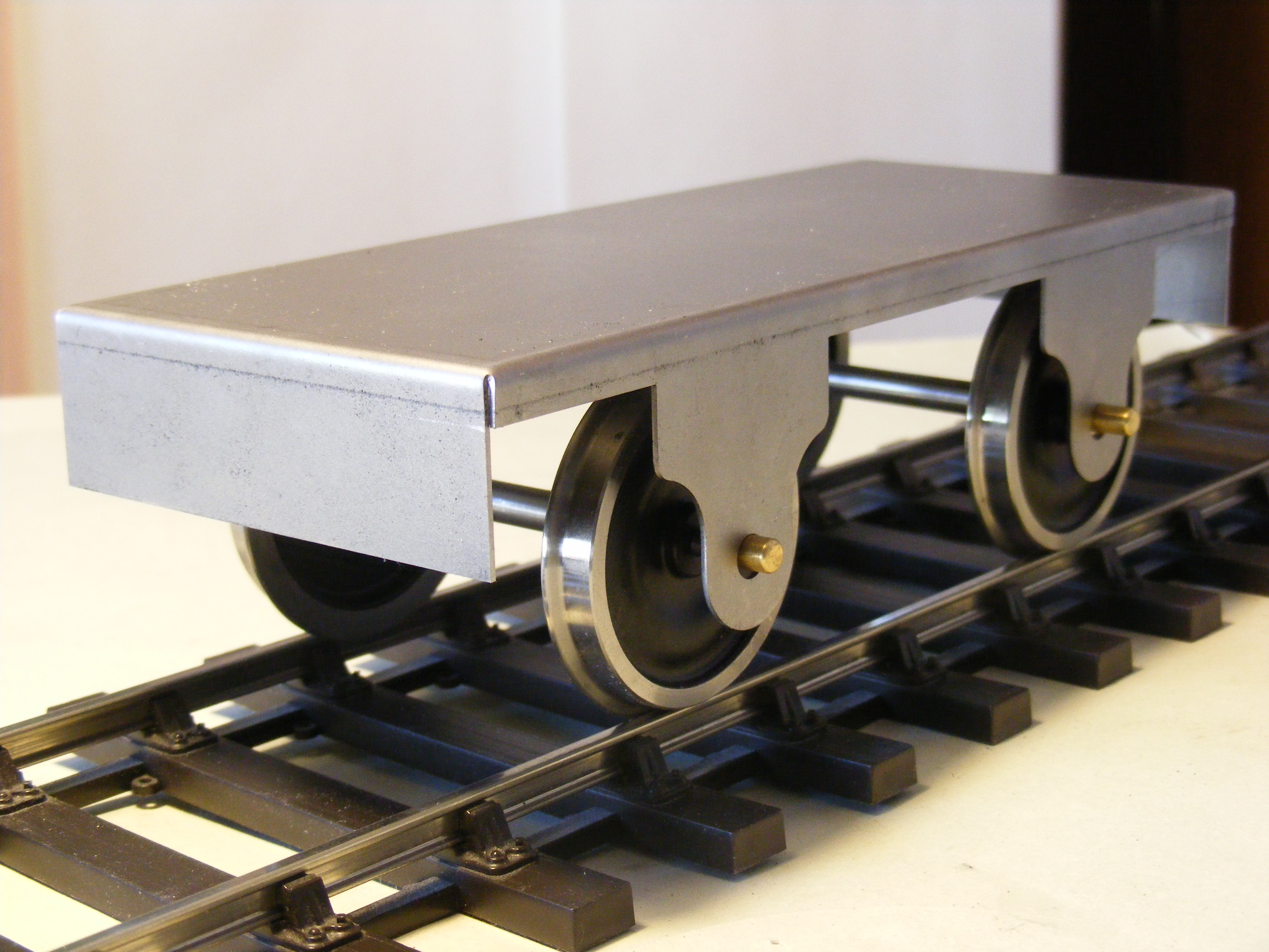

Thought that you all might be interested in a batch of one-piece chassis that I had made. They were made in 1mm steel basically for scratch building anything on four wheels, mainly wagons/vans but conceivably (and with a bit of ingenuity) small locos. They were made locally by Liverpool Laser & Tube Limited (https://liverpoollaserandtube.co.uk) at a cost of £100 for ten plus VAT, by far the cheapest quote that I got.
I had them made for Gauge 3 (63.5mm) but the firm told me that, using the same 3D model as a basis, they could also make chassis for the very popular G Scale (45mm) and possibly other gauges also. What with the state of things financially I imagine that lots of us will be thinking about scratch building and this sort of strong, cheap chassis would make an excellent starting point.
I don't run G Scale myself but would be happy to get a small batch made if anyone was interested. The chassis are folded using an LVD CNC " Robotic Bending System" making them very strong and to a high level of precision (https://www.lvdgroup.com/en/products/press-brakes).
I estimate that 22swg/0.7mm would be fine for the smaller scale and given that steel prices currently are a significant factor, the smaller chassis would be cheaper than my Gauge 3 batch so maybe around £8 each.
Scaled down to 45mm gauge, the approximate overall dimensions would be length 140mm, width 52mm and wheelbase 70mm.
If you would like to put your name down for a sample chassis, please email me direct (not pm) - roligdag@gmail.com.
Wheels in photos not included.
Thanks and stay safe,
Clive
Clive

They do look good, especially at that price. With the demise of HLW as a source of cheap wagon chassis for 45mm gauge, these might well prove attractive.
Shall I repost your message on the G Scale Central forum?

Do we assume the axleguards are flexed outward to "pop" the wheelsets into place?

I also wondered about that..
Also, many 45mm gauge tracks, run some-sort of track power..
As these stand, you would need to use insulated wheel-sets.

Flexing the axle guards and popping in could be an option for solid wheel sets though from what I know about G Gauge, separate axles ( usually 3.2mm) and slide on plastic wheels are sometimes used.
As to wheel insulation, I will leave that to G Scale experts. I use radio control and battery power on my garden layout so not an issue any more.
For further info including how to buy chassis, probably best to watch this G Scale Central thread:-

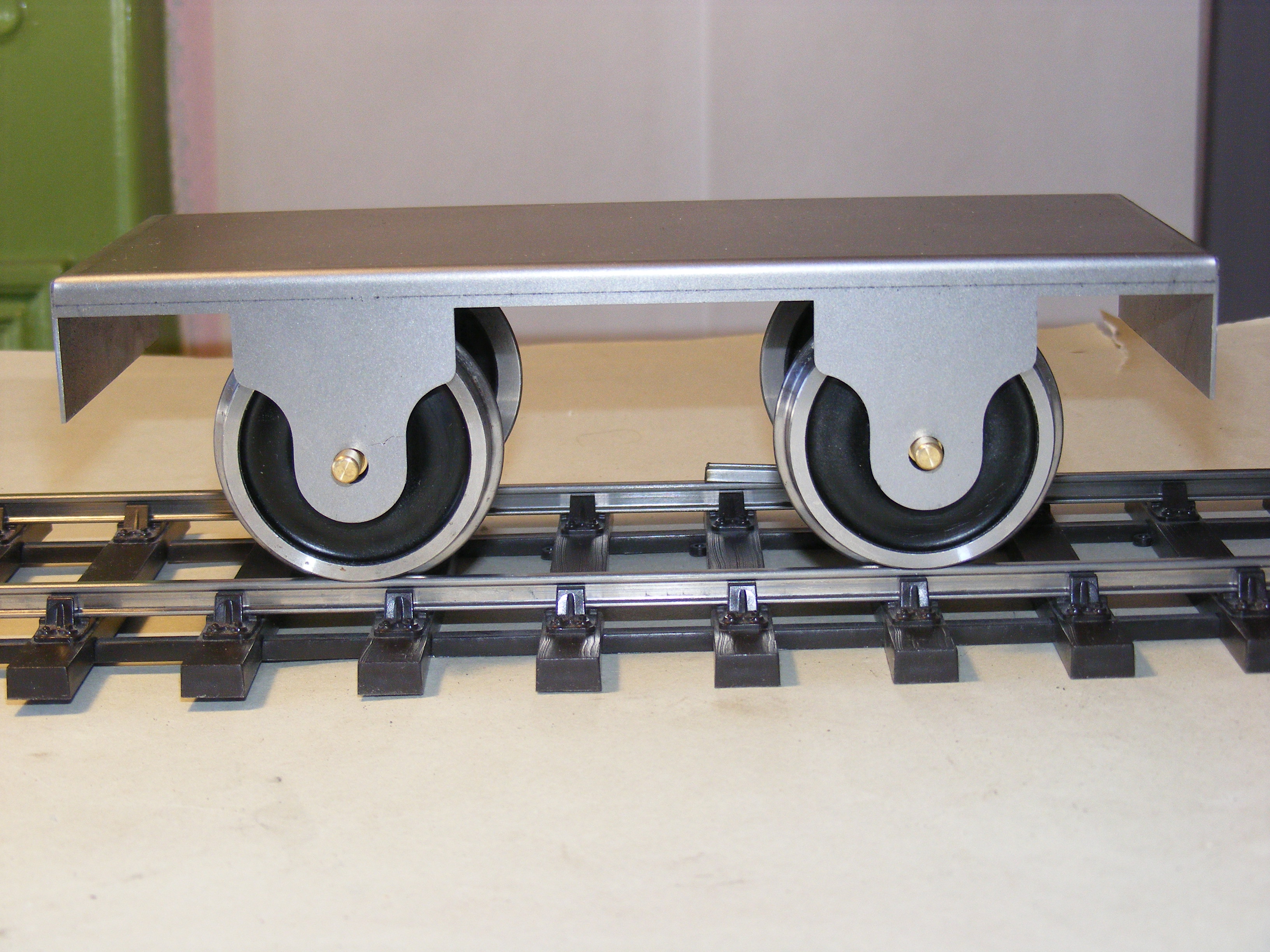

FINAL SPEC AND ORDERING/PAYMENT ARRANGEMENTS
Wheelbase 80mm, total chassis length 150mm. Buffer beams 12mm deep and inner measurement between frames 60mm.
0.7mm steel with phosphate coating. 3mm axle holes.
Price £9 each with free postage for two or more ( postage for one £2-50.) Payment by PayPal only with full buyer protection.
To order, please email me direct at roligdag@gmail.com saying how many you require ( please do not pm.) As soon as I have ten chassis ordered, I will place the order with Liverpool Laser which should mean chassis ready in 7-10 days.
I will then send out PayPal invoices and post out by Hermes when payment received. The chassis will be packed in a box.
Clive
