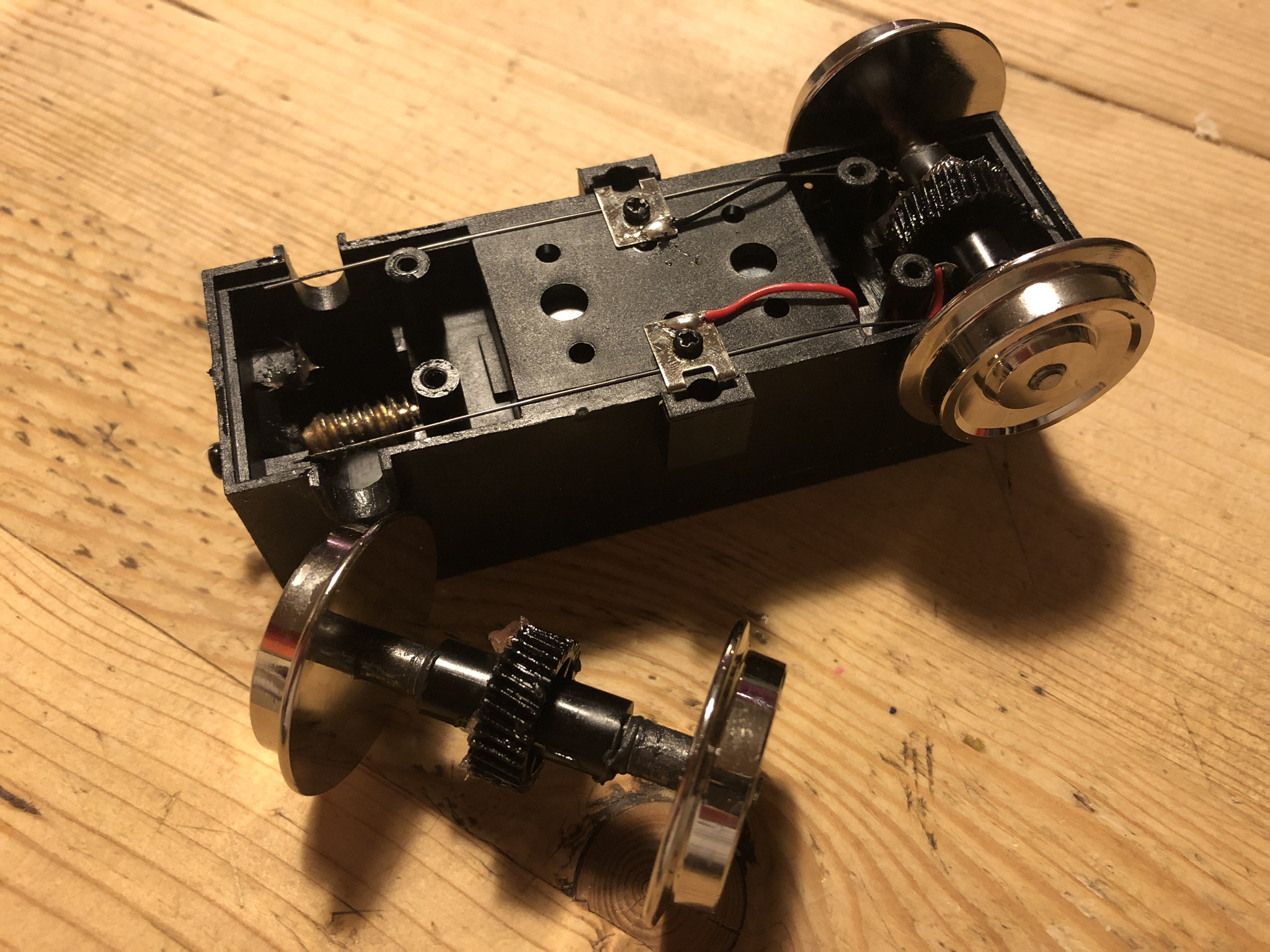

Well, that’ll teach me… Running upside down on the table top does not constitute effective testing of motorblocks — as I’m sure you all take for granted. Once properly installed and all Deltanged up, outside on the track forward (or reverse) progress proved problematic. The power car itself is hardly lightweight (which, in fairness, is how the motorblocks were advertised) — let alone with the trailing coach(es). More grunt required.
A single LGB alternative (unfortunately rather more expensive than I would normally consider) isn’t quite the same size, so new bogies and other modifications are now needed. It won’t sit there making unfortunate fizzy noises without moving, I hope, but I think any notion of three or four car Thumpers is probably out the window.
I had hoped to post a video today…

Thank you. I did experiment with a very similar test ‘mule’ some years ago, as you suggest. I’ve got complacent though, having since made a few overpowered, double-power-bogie locos, largely because it was good fun and (used to be) reasonably affordable to do it that way — and, I suppose, slightly more practically because virtually all my (short) track is on a gradient — much of it somewhere around 1:30.
At present, prior to dismantling, the power car weighs around 2.3kg, without seats or passengers (or chunky Bluetooth speaker delivering thumping bass). Similarly, coaches are presently each about 1.4kg. I hope to have four of them.
The intended LGB replacement motorblock has turned up and, kind of inevitably, due to dodgy guesstimates, doesn’t really fit as I’d hoped (ideal for another project I’m working on though). But strangely, as you also suggest, I stumbled across a pair of very promising, small USA Trains motorblocks (thin on the ground here) which should be just about right, I think. Lengthy DEMUs could be on again!

Whoa! For a moment there I was a little worried. Have I already sabotaged my new motorblocks?
Yes I have! Well, perhaps. Unfortunately this photograph, taken having removed the track pick-up skates, does not show brass bearings.
The first thing I did after opening the box, was to saw off those silly journals, of course. What the hell. Worst case will be that it’ll just last ten years rather than fifty. To be perfectly honest though, I’ll think it’ll be fine. It certainly seems pretty solidly made, plastic or not.
As suggested, I’ve used several motorblocks from Piko in the past (which I’ve never had any sort of problem with) it’s just that in this case they don’t have anything of an appropriate size.
