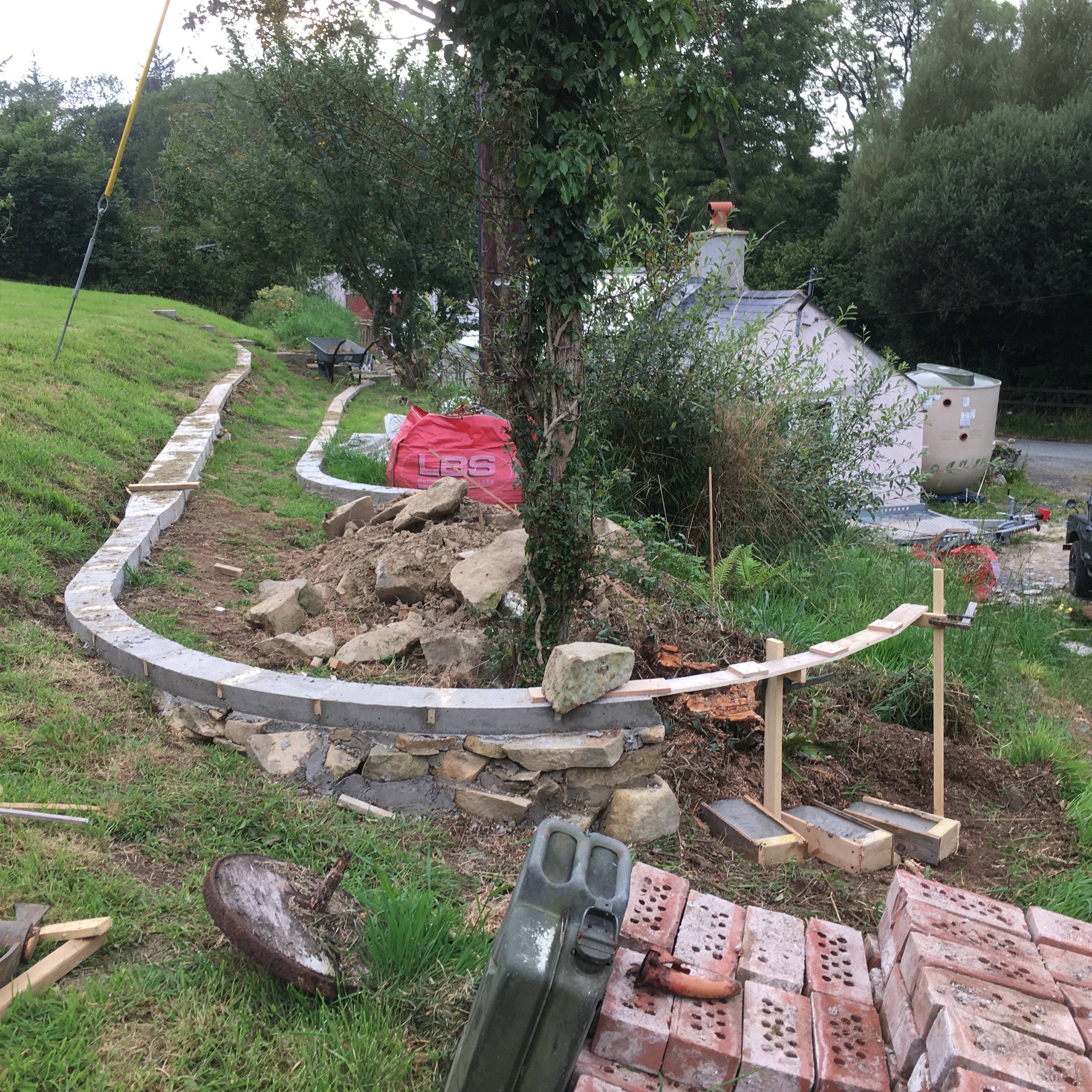

I have now laid the track bed all the way to the void. The last section involved a stone embankment which I plan to cover with soil and eventually grass. It is getting high enough, as the ground falls away to make me think about changing my technique for making the trackbed.
So here is the latest with both ends drawing up to the remaining half circle to be constructed over a fairly steep slope:
It looks like it is crying out to have an North American style wooden trestle viaduct. Not my first choice. The research I carried out looking at prototypes in the UK led me to Brunels Cornish viaducts, the Welsh river crossing viaducts at Barmouth and Loughor, and the slate mine one at Blaenau Ffestiniog.
The ones that are high and long are all wooden structures mounted on top of stone piers. The wooden supports radiate out from the stonework, to support the top deck.
I really don't want to have to cast concrete piers here. Providing a foundation which would stabilise a tall pier has put me off. Each pier would be different - some short and some tall - but no two the same. Making this accurately, on a curve, with a 1 in 80 slope, seems too difficult. I also want to have a result sooner than later, and I think casting piers would take a long time - and use a lot of wood for shuttering. I have worked out a way that I can set out the curve and slope and actually make fit if I do it this way:
So, much against my instincts it will be an North American style trestle viaduct.
How to set this out and make it accurately?

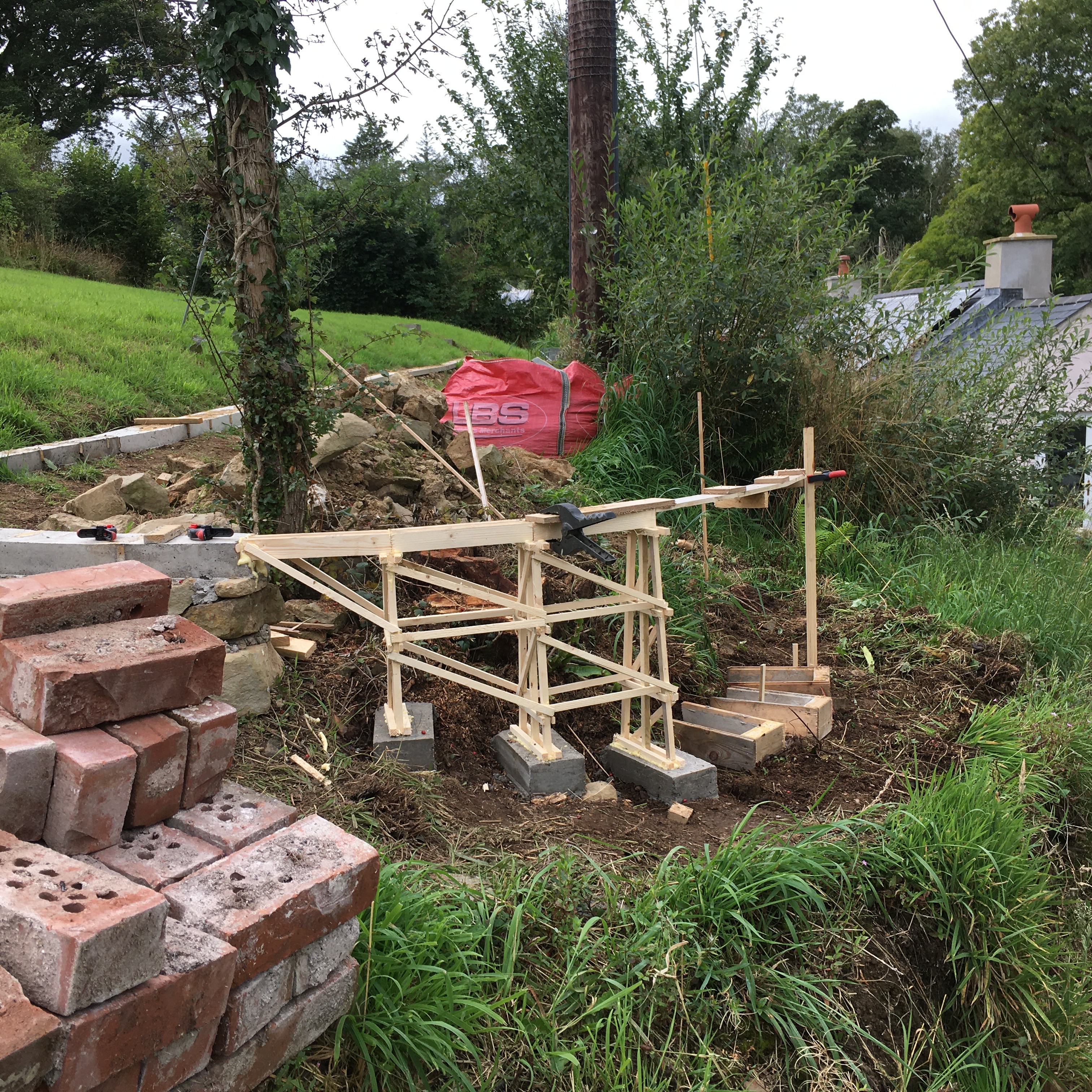

I am going to make it in stages, 3 trestles at a time, so I have made four sections of mock top deck and cut the ends at the correct angle to make them follow a 4ft 6inch curve when joined together. An extra length at the left allows it to be cantilevered of the last bit of concrete track bed. It can be seen in place in the photo. Two uprights clamped onto it allow me to set it at the correct slope and level it across the deck. So that lets me look down and see where the concrete foundations should be made. I made three sets of shuttering for the foundations and set then below the deck joints. The small concrete bases to support the bottom of each trestle can be seen in their shuttering on the right hand side of the photograph.

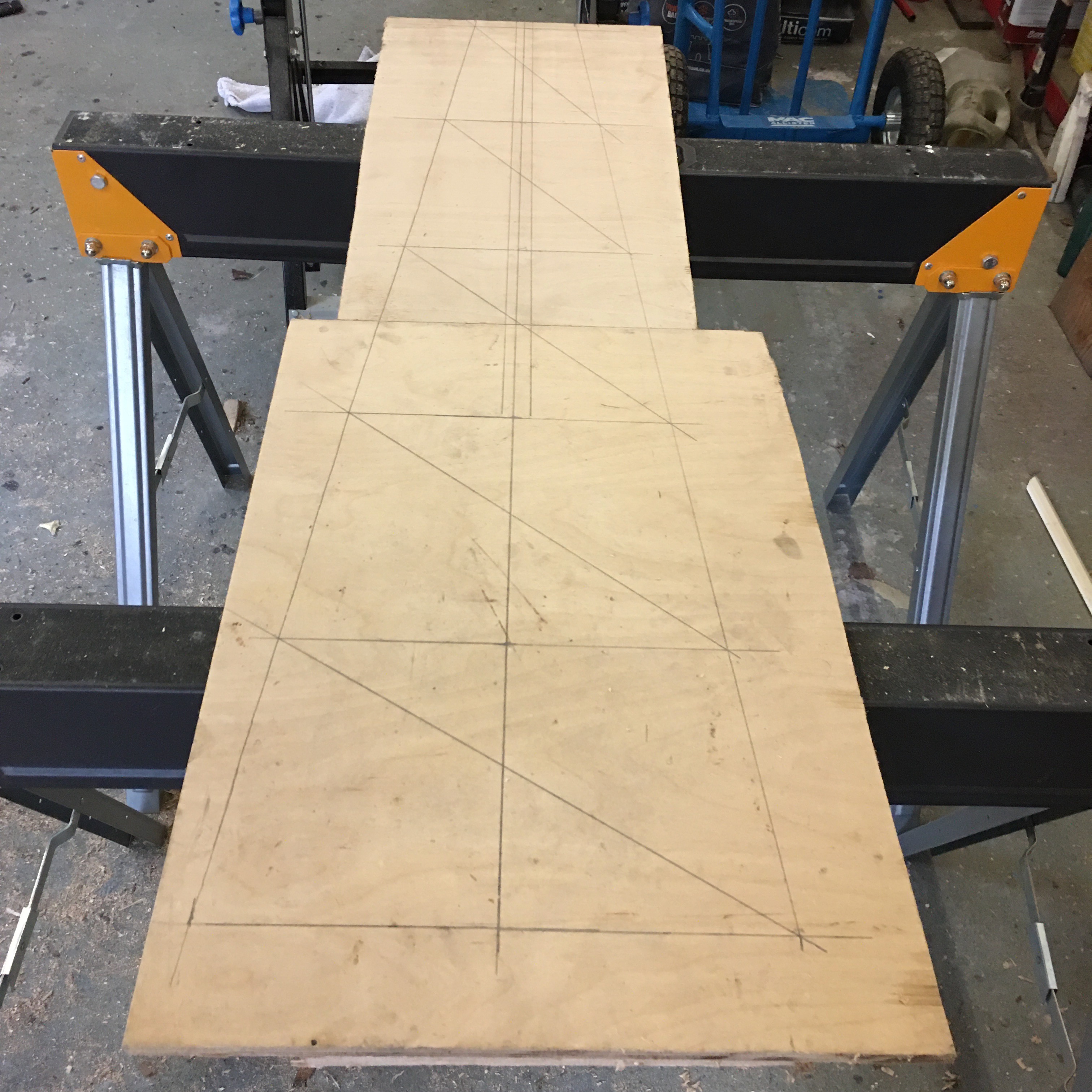

On the basis that each trestle will have the same profile, with the outer legs protruding at the same angle, and the longer it is the wider the base, I have made a template to create the trestles:
So while it is raining, and the concrete curing I can make three trestles. Since my temporary top deck is defining where the trestles will go I can measure their height from the concrete to the level of the trackbed. Just have to remember to take off the height of the real top deck and I know how long the trestle has to be.
The outline is in pencil. By marking the length of each trestle on the template I think I can then make each trestle to fit the specific place it is intended to fit into.
So off to make trestles!

The first three trestles have been made:
and this morning they have been fitted into position:
The template which defines the track bed is really useful. It allowed me to place the shuttering in roughly the right place, and when fitting the trestles allowed me to identify if they were the correct length, and in the correct position. One of them was too long - so I had to modify it but at least it was too long not too short.
I have the same amount of packing between the top of each trestle and the template so they must be the correct length. I am slowly adding the cross bracing between the trestles, limited by the number of small clamps that I have. Each trestle is glued onto the concrete using an expanding polyurethane glue. That should not only hold it in place but form a water proof layer between concrete and wood.
I think this is going to provide a strong lightweight method of getting around the loop. I know the wood will have a limited lifespan - but if the wooden sleepers I use are anything to go by it might last for quite a while. We will see! At least I can claim that it is a prototypical method of solving this problem, a temporary solution which can be replaced with something more permanent later.

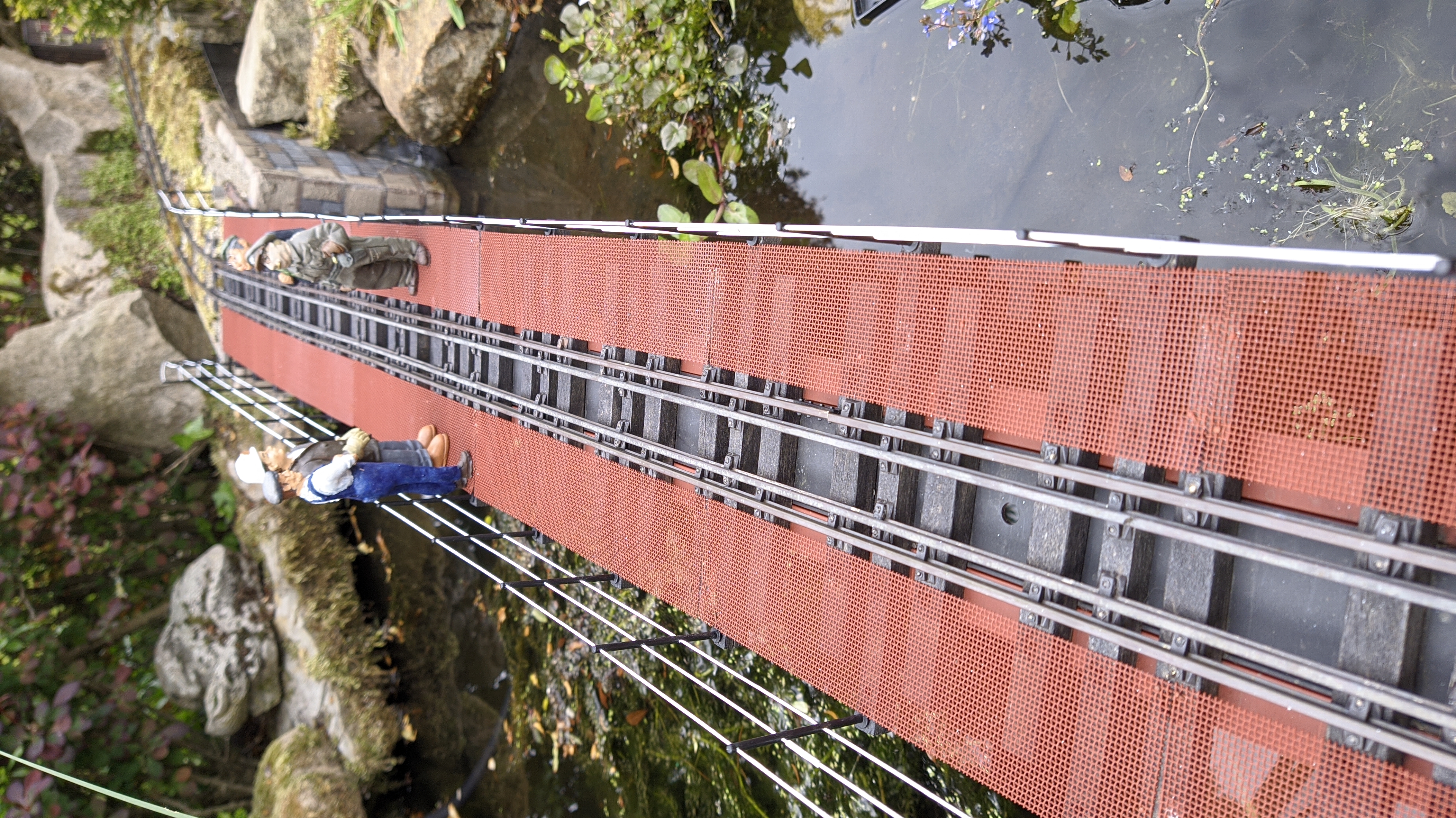

Looking at prototypes I have noticed that a common way of providing a walkway involves some sleepers being longer than normal, and a walkway laid on both sides, with handrails fixed to the ends of the long sleepers.
So my cunning plan involves every other sleeper being long enough to carry a wooden walkway. On the metal bridge further down the line I used wooden slats left over from a venetian blind to form the walkways. The same seems appropriate here. Last time I glued wooden coffee stirrers on top but this time it is so long I am tempted to just fix the slats on their own. I was a thinking of holes in the end of these long sleepers to take handrail uprights (stansions), and thread a fairly heavy brass wire through them, perhaps 1.5mm diameter. I think the walkway and the handrails should act as a safety net.
I am currently glueing my track down with that polyurethane glue before which I use so much of, and I will do the same on the viaduct in particular.
Posts: 1519
Post by Lonsdaler » Tue Sep 21, 2021 6:37 pm
Not a viaduct, but this prevents trains taking a dip in my pond. Brass model boat stanchions on every 3rd extended sleeper, piano wire for the rails and stainless steel fine gauge mesh for the walkways. Lollipop sticks only lasted a couple of years. The check rails are largely cosmetic, but may be a good idea on a curved structure.
