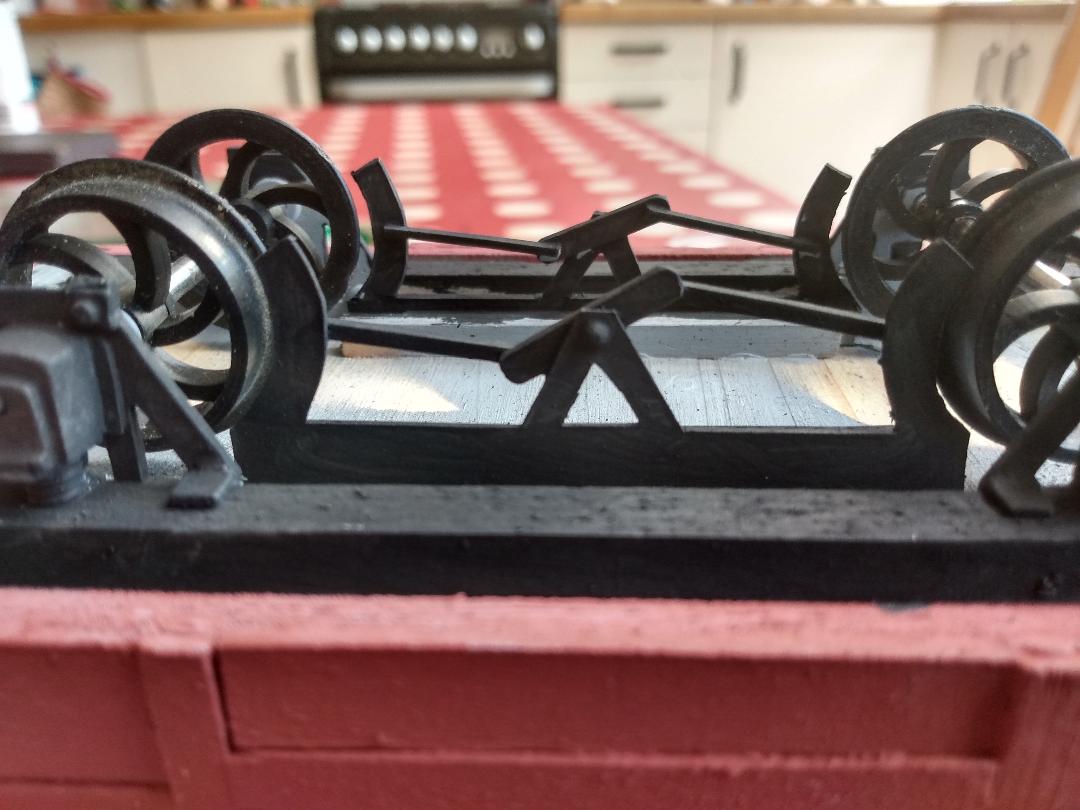

Here we go!
It's pretty simple. I add the wheels first, then make a template out of cardboard, starting with drawing round the wheels. That template, subsequently transferred to 1mm or thereabouts plasticard, features curvy bits representing the brake shoes, the V hanger and a long bit that joins them together that will be hidden by the solebar. The push rods are added from scrap bits of plastic rod, and the swivel-y bit that joins those to the V hanger is another scrap of plasticard. That's pretty much it. Some of the WHR and FR wagons I've ben modelling only have one brake shoe, or are only braked on one side - I thought this brake van ought to have four shoes!
Because it's a brake van there's no external brake lever on this one. For those I drill the apex of the V hangers so a rod can go through, extending outwards (on one side only on the wagons I model), then the lever is added, also cut from plasticard, attached the rod at one end and the wagon body on the other.
Depending on how it all goes together, the completed assembly can either be glued to the solebar or to a scrap of wood. It's a representation rather than being 100% accurate, but good enough for me, particularly once weathered (this one's not been yet).
Hope that's helpful,

I really like that, a far more practical effort that mine.

Very clever and effective!! You are indeed a man after my own heart - I also tend to over engineer stuff I create for 3D printing.
