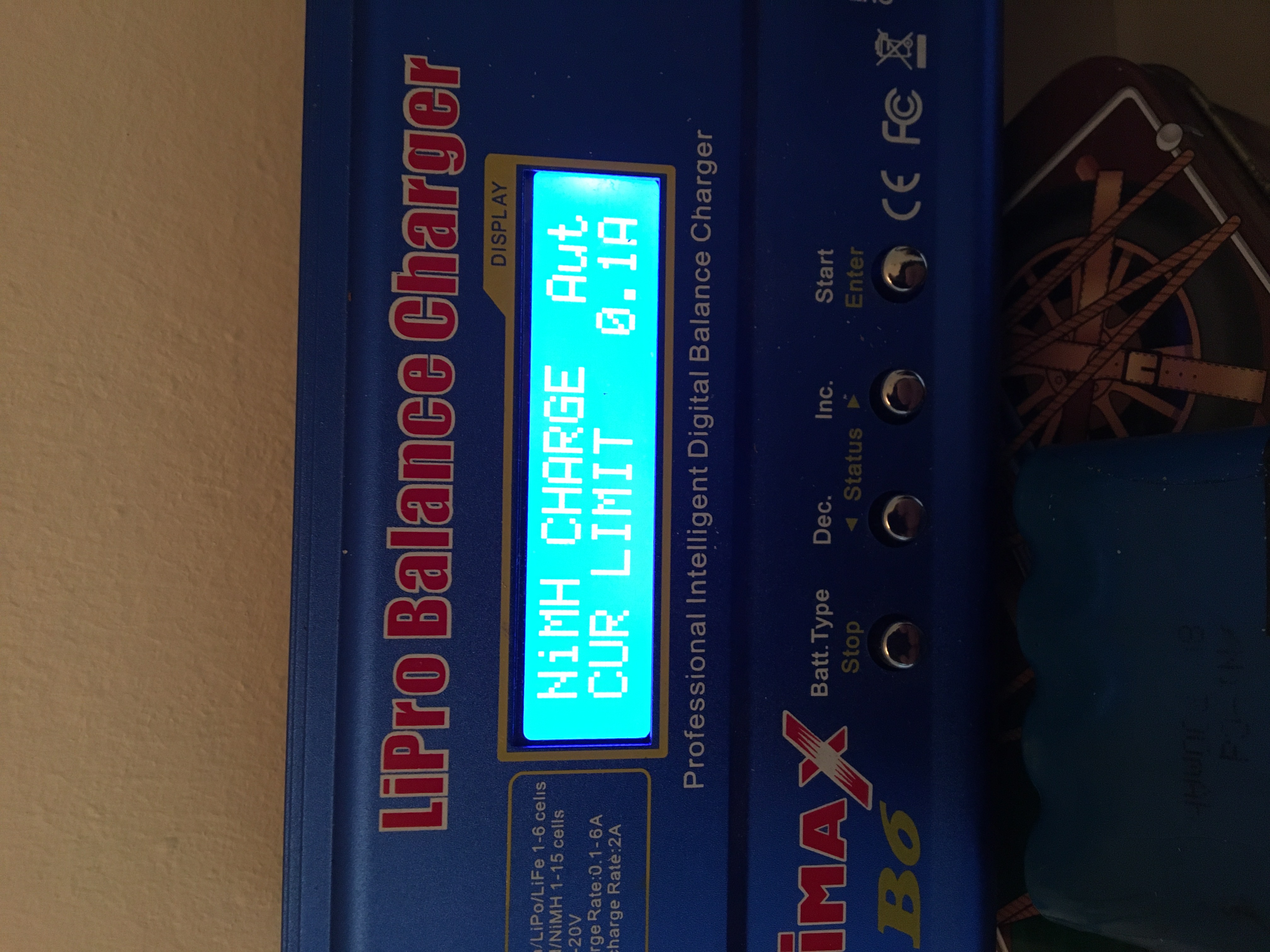

I need some help quickly. I am going hopefully to my 1st steam up since the start of COVID on Monday. So I went to check my loco to see how she was, give her a run and check her over. I filled her with water and gas, then switched everything on and went to try give a pre-check, you know the basic things before you start and I found that nothing worked, nothing. So I thought it must be the battery in the loco, so out it came and onto the charger, but now the plugs that are now on the battery is one of the smaller type, I forget what they are called. The charger I use is a Imax B6 and I have forgotten how it works now. It has now been on for 4 hours.....
What setting should it be on, this is mainly a question for Rick

You need Rik's guide to the Imax B6
https://riksrailway.blogspot.com/2017/0 ... arger.html
I printed out the relevant bits and keep it with the charger, it's invaluable.
However, if the batteries are completely flat and haven't been used for 18months or so they may be beyond redemption.

Thank you Phillip.
I was struggling, I forgot that you need to hold the start button down and wait until it beeps.....

Yep, been there, done that, etc. Thats why I printed it out as a handy guide... With me, I keep forgetting to plug in both the charger leads AND the balance leads, with LiPo's.

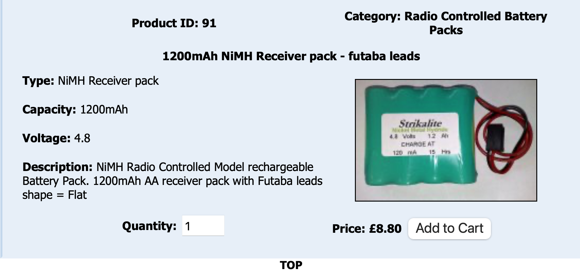

On the subject of battery packs, is this the correct one for my Roundhouse Billy.
It the same has the one I have now, a 4 cell with the Futaba plug. The one I have doesn't have any readable information on it unfortunately......it does have NI-CD though I think.

I can't answer as to whether it is actually the correct one, but it sounds about right, but I am slightly surprised that your existing one says NiCd?.FWLR wrote: Tue Jun 29, 2021 5:17 pm On the subject of battery packs, is this the correct one for my Roundhouse Billy.

Re: Charging
Hi Rod,
So long as the existing batteries are AA and not AAA, that set should suit perfectly. If the old batteries are Ni-Cd (Nickel Cadmium) that would explain the lack of charge - Ni-Cd's were notorious for developing a 'memory', where just boosting the charge rather than discharging them and then recharging resulted in them 'forgetting' they have a larger capacity. Ni-Mh (Nickel Metal Hydride) don't have the same issue.
