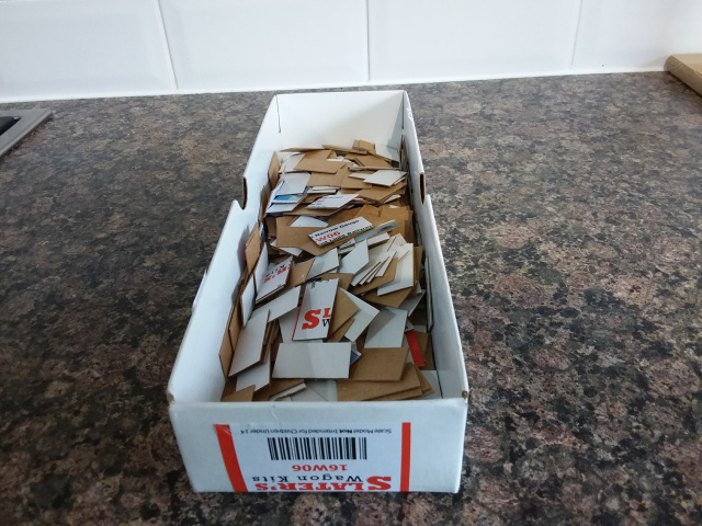

Hi all.
1000+ roofing slates stacked up ready for loading into wagons and run down to Port. Having bought 4 Slaters FR 2 ton slate wagons I wanted loads for them but I wanted the load to look like individual hand cut slates. I wanted to make them from something that did not have edges that were crisp and too defined. I tried plastikard but the edges came out too neat and thin ply would take too long to cut. So what to use? I thought the card that the 4 wagons ( and 5 skips ) came in would be ideal being strong and just under 1mm thick. After opening up the boxes and lids I cut strips 18mm wide. This would give 5 rows of slates per wagon. I marked the strips into 34mm lengths ready to cut to length. This is where I used a little artistic licence. If you look at some contempory slate wagon photos, the slate cutters were so good at their craft that the slates seem identical in length whereas I wanted to give more of a rough appearance to make the edges standout. What I didn't want was what would look like a clay block with lines scratched across it. I therefore cut the slates to length with scissors approximately on the 34mm line so they would all be a slightly different length. After gluing what turned out to be 65 slates together into a block and making 20 blocks I feel I have the effect I wanted. I am not saying all this marking, cutting and glueing was a quick job as it took the best part of 2 weeks but i am happy with the result.
The slate blocks were first sealed with shellac, primed with grey primer and then top coated with Humbrol matt slate grey. And all they cost was a couple of pounds for the small tin of Humbrol.
D.
