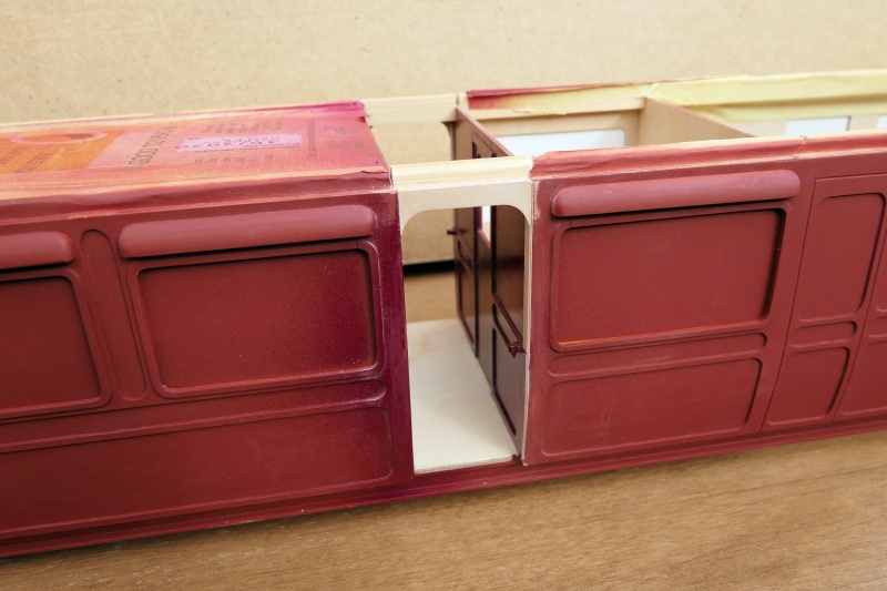

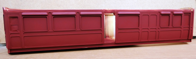

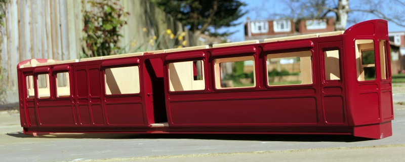

Ok, time to go into the paint shop.
One final rub down then mask up -
Into red primer. Already looks more like a complete vehicle rather than a collection of parts glued together.
By this stage I had finished making the gate fixings so the vestibule ends were sprayed final colour and the loose one glued in place, along with a couple of small pieces of trim and a fill in piece over the entrance. There will also be fill in pieces across the bottom to make it flush with the sides. These incorporate the lower gate hinges and will be fitted when fitting the gates for the final time. More detail on this later.
Then the exciting bit - final colour, Ford Aporto red.
Couldn't resist . . . . .
