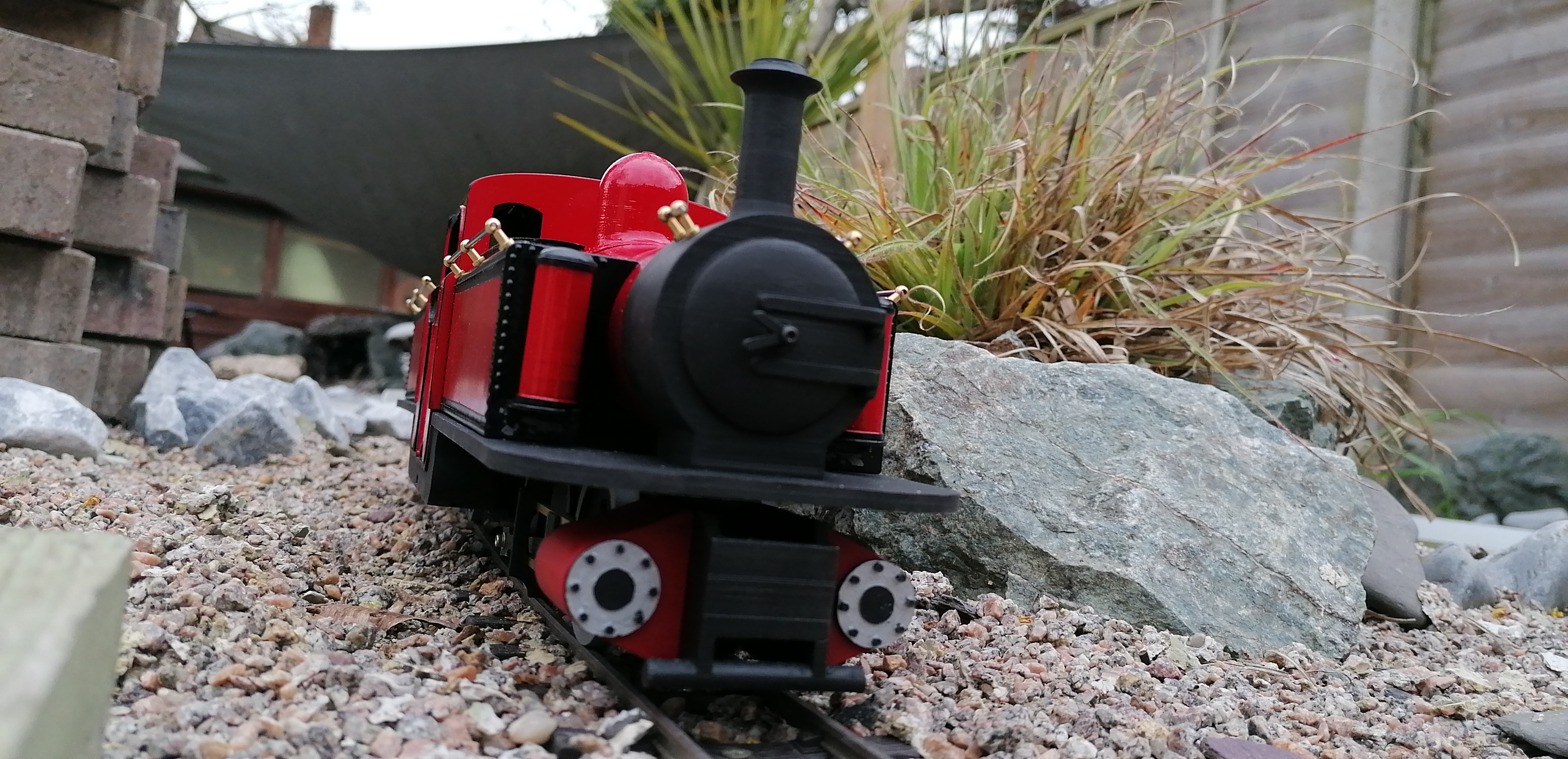

Post by -steves- » Tue Mar 16, 2021 7:12 pm
ge_rik wrote: Tue Mar 16, 2021 4:47 pm
River Lin wrote: Tue Mar 16, 2021 3:23 pm Wow. Wow. Wow. Etc. Etc.
David.
Quite!! Are the wheels printed as well?
Thank you for everyone's very kind words, they really are appreciated.
Yes the wheels are printed Rik. Things not printed are, 4mm axles, gears, motor, cross slide bars, fake piston rod, brass insert for piston rod, nuts and bolts, all bushes. It has bushes in every moving part.
I am glad people are liking it so far :thumbup:

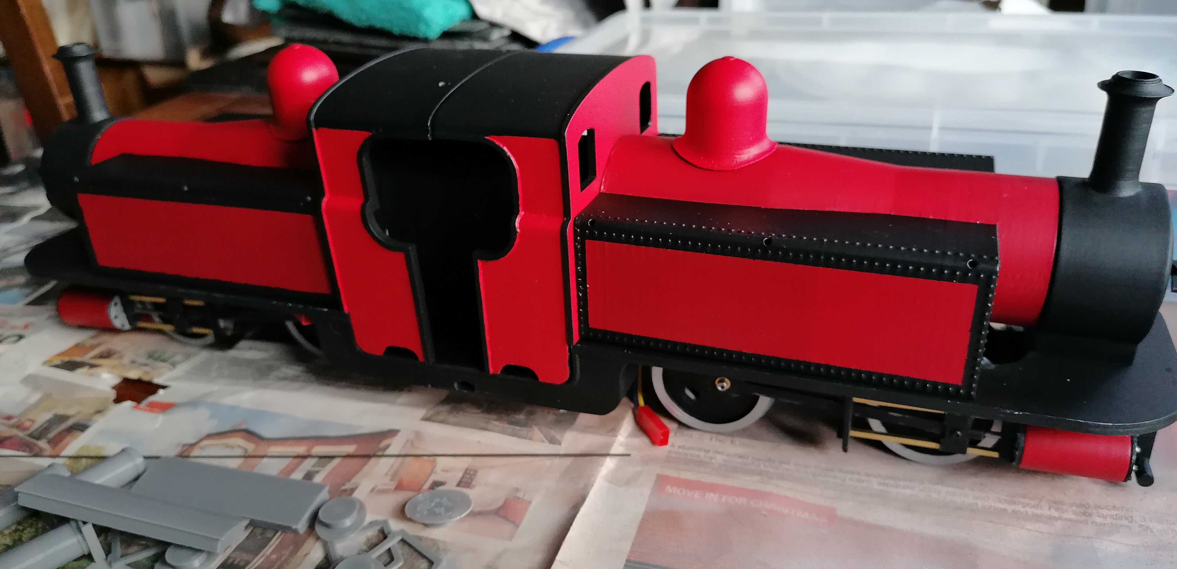

Post by -steves- » Thu Mar 25, 2021 5:11 pm
Started to add the first layers of paint and think it's starting to look like it is something rather than just a lump of 3D printed plastic, lol.

-steves- wrote: Thu Mar 25, 2021 5:11 pm Started to add the first layers of paint and think it's starting to look like it is something rather than just a lump of 3D printed plastic, lol.
It's looking really smart! :thumbright:

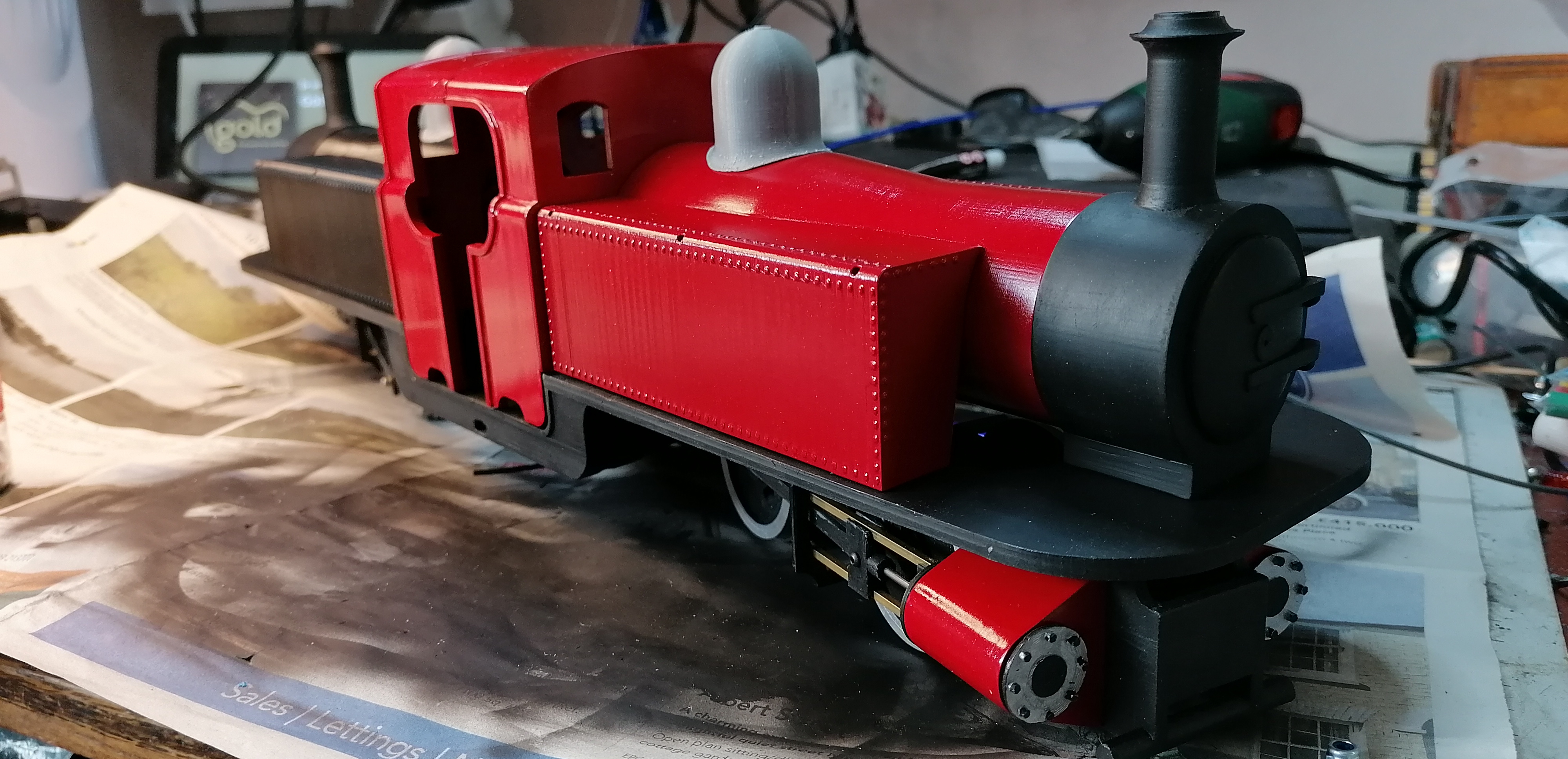

Post by -steves- » Sun May 02, 2021 7:45 pm
Progress has been exceptionally slow on this due to my father in law passing away, arranging the funeral, having to clear a house for the mother in law, as well as the garden and garage, that tied with laying 3.2 tonnes of concrete in my own garden and rearranging all the sheds as one needs replacing somewhat urgently. Anyway I digress.
Here it is with a couple of coats of paint, no sandpots, windows or anything yet, but it is very very slowly getting there.
I would point out that it will not be lined as I have no idea how to do it despite owning, but never using a lining pen for the last 10 years, lol.

Post by ge_rik » Sun May 02, 2021 8:38 pm
Blimey, Steve. Sounds like you've got an awful lot on your plate!! Please pass on my condolences to your wife and mum in law.
The loco is coming along nicely. In effect, you're building two locos at once, so given everything else, your progress is lvery impressive, especially when you consider this is a scratchbuild.
It's gonna look great when it's done.

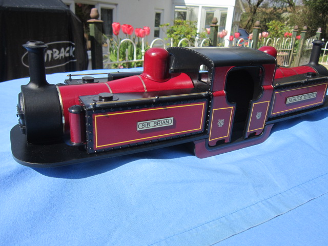

Peter Butler wrote: Sun May 02, 2021 8:41 pm A simple way to add lining is to use self adhesive lining tape, which is a continuous strip of coloured plastic, available in various widths on the same backing sheet and in a wide range of colours......
[attachmehttps://i.ebayimg.com/thumbs/images/g/RBEAAOSww-lfcfS3/s-l225.webpnt=0]IMG_8245.JPG[/attachment]
Loving those brass bands around the boiler, please do tell me more as I would like those on mine if possible. :thumbup:

Peter Butler wrote: Sun May 02, 2021 8:49 pm Boiler bands are self adhesive tape (again!) This time left over from my career days as a picture framer where it was used to enhance mounts.
Try ebay.... picture framing accessories (?) or craft shops.
Thank you very much, I will be searching shortly for the brass looking ones :thumbup:

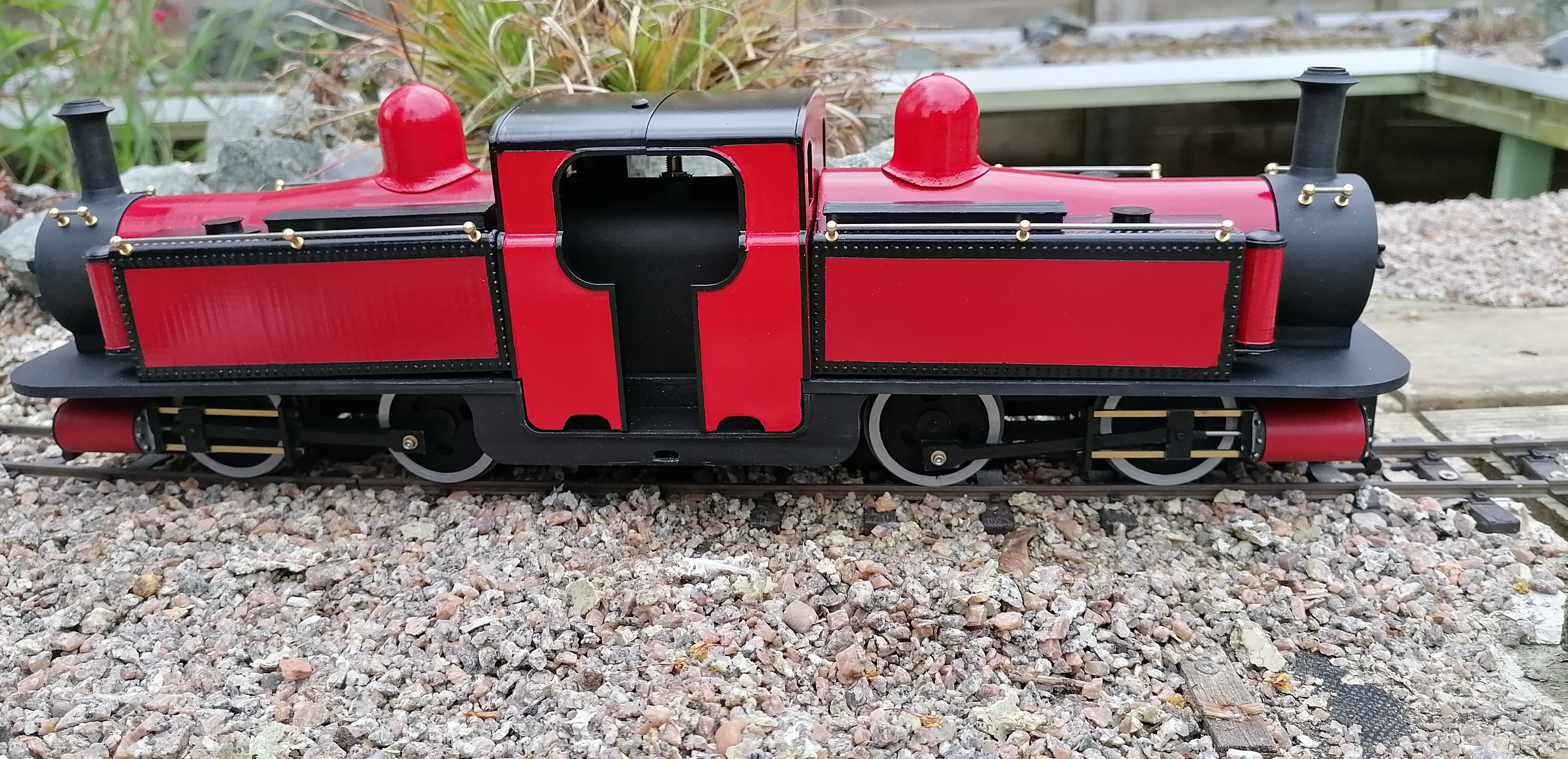

Post by -steves- » Mon May 03, 2021 5:42 pm
I managed a bit of modelling time today between clearing the garden and sorting out a run to the tip.
So no lining yet, still not sure on my skill level there. The rest of the loco is almost there, a few touch up bits to do, sand pot tops and the windows.
I am quite happy with this so far.

Post by georgesheppard » Mon May 03, 2021 5:58 pm
-steves- wrote: Mon May 03, 2021 5:42 pm I managed a bit of modelling time today between clearing the garden and sorting out a run to the tip.
It’s looking really tidy! I wonder how easy the lining tape Peter mentioned would be to remove if you’re not happy with the end result?

Post by Peter Butler » Mon May 03, 2021 7:37 pm
The lining tape is easy to remove, or alter, without leaving marks on the paintwork. It is necessary to give a coat of lacquer to keep it firmly in place, so make sure you are happy first!
