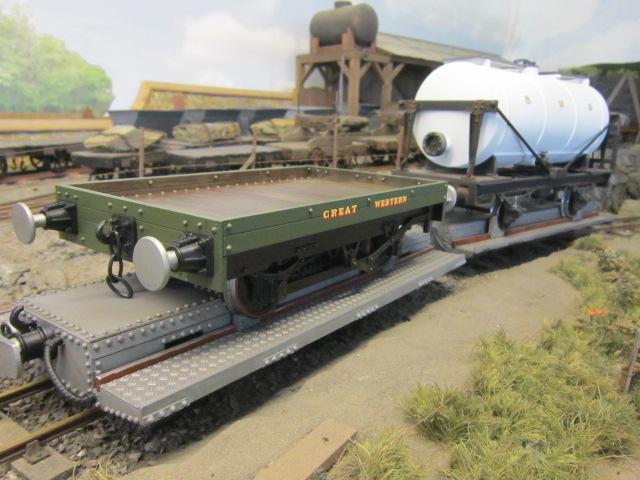

- Posts: 5728
I think this project is finished now, all painted, weathered, lettered etc. and ready for its official portrait.....
The two transporter wagons have slight differences in design, as would happen in reality during service, however, they look perfectly well together and make an interesting feature on my preservation line, where anything goes!
Jerry's kit has been a real pleasure to build and adequately detailed to suffice without modification. I have added rivet heads (as previously mentioned), chequer plate footways, manually operated brake wheels at each end and brake-pipes to match the GRS wagon. All other detail parts are included in the kit, buffers, coupling hooks and chain and all brake gear components.
I am undecided about a load, could be just chains after delivery of something? They must run empty at some point!

The rivet detail really makes this model! I love the great western detailing on the payload wagon.
Where do you buy the chequer plate from? I was looking for something similar only last night, is it something like this? https://www.hattons.co.uk/46143/plastru ... etail.aspx

Thank you George, in answer to your question.... I have no idea! During my many years of exhibiting I have stumbled on so many things at shows which I think would be useful one day, and this is one of those. Most likely it was amongst a selection of random embossed sheets and it caught my attention? I think it is probably made for 7mm scale, but it looks fine to me.
Perhaps someone with connections to the 'Gauge 0 Guild' might be able to help?

Having said that, I'm slightly bemused by the livery of the load wagon. I realise that the BURPS is a preservation line and being your railway Rule 1 applies, but surely no preservation group would paint a GWR vehicle in a greenish shade, with a loco livery style "Great Western" and none of its correct wagon markings!

Antics sell plasticard 1/25 scale treadplate. Not sure if this is what Peter used.
https://anticsonline.uk/Product/Slaters ... N108390953

I think that's it Rik, good to know, well done.
You can't please everyone!
The next one will be pink!
