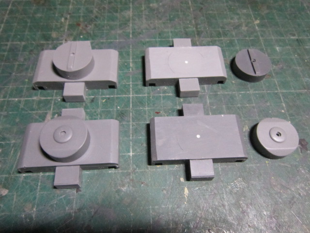

Time to fit the bogies. I have chosen sets from Swift Sixteen, which are very good quality at a reasonable price, particularly bearing in mind I need five sets!
The problem I face is that they are designed to be fitted from inside the carriage and I like to fix roofs permanently, meaning that should one work loose or need replacing it would not be possible to get at the screw head.
So.... pause for thought.
My solution is to modify the casting so that I can set the screw from underneath but still use the clever built-in tilt mechanism.
The first thing is to drill a pilot hole through the centre for the screw to be accurately set from underneath. Then cut the casting in two, separating the round top part from the base plate. The two cut faces are now sanded smooth....
Next is to add a plasticard piece to make up for the thickness of the cutting blade width (Bandsaw). This also gives a smooth surface for the upturned top section to rub against when turning...... Now I can glue the upturned circular flat top section to the underside of the carriage, ensuring the tilt mechanism is correctly aligned, then screw the wheel carrier from underneath. I can easily modify the ride height too if needed, simply by adding more plasticard blocks and longer screws...... simples!

Ingenious!

First pair of bogies are now fitted to test the theory and they work exactly as planned (I'm relieved to say!) ......
As a result of this I felt confident enough to cut all of the other bogies and can fit them to the rest of the coaches.

That's an ingenious workaround Peter, well executed as usual.

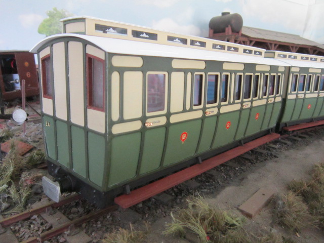

The first of the Lineside Hut coaches having its official photograph taken on the line. The bogies work very well so I'm happy with the way my surgery went. A small lead flashing sheet (900 x 550) has been glued to the underside of the floor to add weight low-down as the coach is very lightweight, this improves the ride considerably.
This coach will be the first-class accommodation for the Lord of the Manor and his family when travelling away from home. It will be part of the train which incudes the horsebox and Brougham.....

The remainder of the five 'Lineside Hut' coaches are now complete and stand in-line for their photograph on the railway.....
I am very satisfied with their look, they have been a real pleasure to build, plenty of opportunity to add detail, both inside and out. The quality of the material is superb and the standard of cutting of individual parts is perfect.....

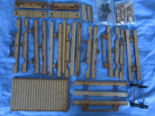

I added this line to my post above as it referred to a kit I purchased as part of the job-lot, which included the Lineside Hut coaches. It will be challenging for several reasons, which will all become clear when I do eventually start it. For now a new kit has arrived on my workbench, which I am more than eager to build straight away.....Peter Butler wrote: Wed Apr 14, 2021 10:20 pm
My next kit might not be such a wonderful experience, time will tell.
This is the Jerry Irwin, Transporter Wagon, which includes goods wagon load .....
https://www.ebay.co.uk/itm/Transporter- ... SwxhNgeX-K
I'm going to enjoy this!
