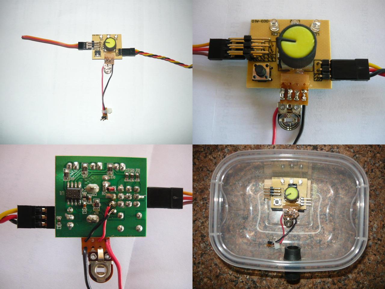

I have modified all 12 of my Servo Testers, so now I am ready to set them up on the layout.
I will be putting each one next its relevant point so that way I can adjust with a bit of ease.
They will be housed in plastic food containers, with a seal-able lid under the baseboard, we have had torrential rain this week and where I am planning on putting is still dry so they should be OK, the only water that gets under there is from the irrigation and it is only a fine mist anyway.
I added a On/Off switch for the 5V bus that I had in a box it is rated at 500V and 30A so I think it should handle a 5V 3A bus OK.
I did consider a "service" switch in line with the main switch that would isolate it while I made adjustments so that I do not have to walk back and forth to the control panel while adjusting, I may still retrofit one if the becomes necessary.
I also considered a 1ohm resistor in line with the servo +ve line so I could put a voltmeter across it to measure the current while adjusting but at this stage, I'll just listen for the servo buzzing to indicate over driving of the motor.
Edit; added enclosure to picture.
A picture of the way I modified the testers and mounted them in an enclosure, Power on the Right, Servo on the Left and switch input at the bottom, all cables will come in from the bottom through a piece of cut down irrigation fitting.

To set the blades;gregh wrote: Fri Apr 09, 2021 11:23 pmSorry for my ignorance, but I understood from the above that the linkages allowed the end-to-end servo movement without stressing the point blades. But from your last post (thanks for the pics) I still cannot see how they do that. They are just a solid rod. What have I missed?GAP wrote: Fri Apr 09, 2021 8:31 am
Meanwhile I bought some things called "linkage stoppers", from HobbyKing an R/C model supplier, that allows the servo horn to go over centre at power up and return to the preset position so the servo does not try to overdrive the point blades as there is enough sideways "slop" at the throw-bar end with the clevis pin being able to 'float in the end slot', so this may be a work around.
It seemed to work with preliminary testing.
I position the on board pot so that the blades are set to straight through.
The control rod is then set so that the clevis pin is pushing on the throwbar at the edge of the slot closest to the rail.
I then make the switch and the servo moves its set distance, I then adjust the added pot till the blade is against the stock rail and the clevis pin is against the edges of the slot furthest from the rail.
When the servo moves the control rod transfers that movement to the throwbar the stopper pivots in the hole on the horn when the horn moves.
The setting of the 2 pots determines the amount of pressure is applied to the blades.
If you bent a piece of wire at 90 degrees and fitted it through the servo horn (the plastic actuator bit) so that you now have a straight length of wire extending away from the servo when the servo moves the amount of travel at the horn and at the end of the wire will be the same.
The piece that went through the horn is able to pivot the stoppers just replace the bent wire.
After a bit of testing I found that bloody Irishman Murphy had taken up residence on my setup.
The tester causing the issue is one of the 2 out of 12 that came with the order (green circuit board as opposed to red circuit board) it appears that the micro-controllers have different programs in them.
At power up it drives the servo a full 90 degrees before settling at the position determined by the pot, the other 10 just move to the position set by the pot.
Guess I am lucky I used that one first.
I replaced the offending tester with one of the others and it is working fine, the points change as advertised and there is no annoying overdriving at power up.
Now I am 2 testers short but I am looking at a work around of driving 2 servos off the one tester as the points I am working on are part of a crossover so that may work.
Edit;
I installed a second servo running of the tester and now have 2 sets of points on the crossover that change when the one switch is made. This overcomes the shortage of testers.
It took a bit of adjusting, considering I had 4 adjustment points, but after a bit of fiddling it now works well and neither of the servos overdrive.
I will duplicate this on the other sets of points on the crossover.
Picture of the linkage and control rod.
