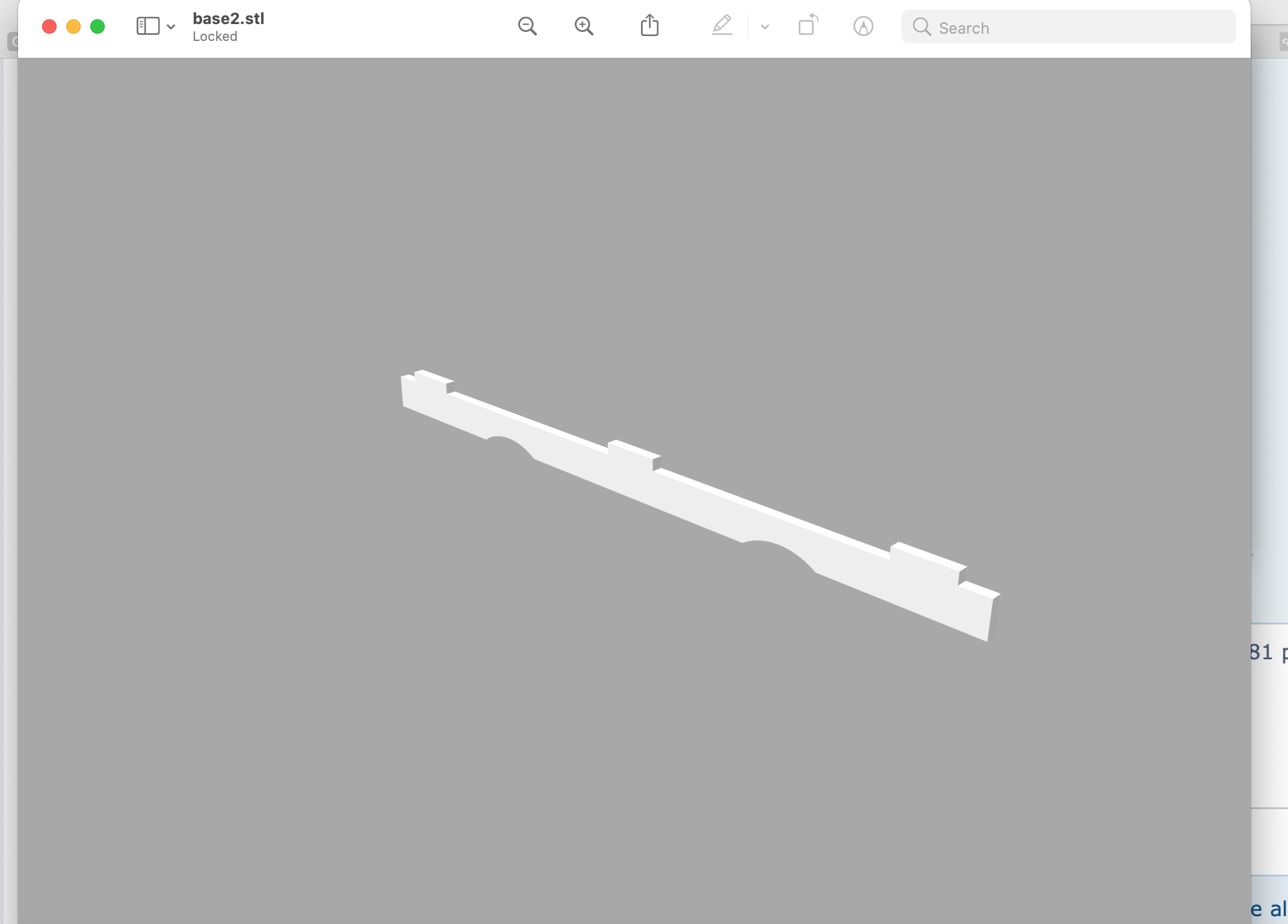

Is this the blank you are talking about. And do I need to shorter the length of it for the buffers, or do the buffers go outside of the frame, that would mean it doesn't need to be shortened than would it..
The instructions in the read me file doesn't really tell you anything, only that it is done by clarionut:
When fitted do those little tabs disappear in the false frame ...

FWLR wrote: Thu Feb 04, 2021 2:12 pm The instructions in the read me file doesn't really tell you anything, only that it is done by clarionut:
Not sure I can answer those specific Qs until I've figured it out myself, but as I say, the instructions in the arockStone original are what I think you need to follow, you'll also need some of the files from the original as those that have not been modified by clarionut aren't included in the remix.

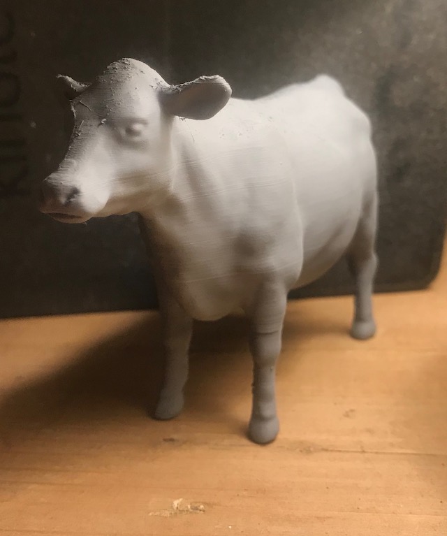

SimonWood wrote: Mon Dec 14, 2020 9:08 pm
Standard resolution (PLA layer height 0.18mm) - print time 40 minutes
Hyper resolution (PLA layer height 0.08mm) - print time 1 hour 57 minutes
I said I'd post a pic of these once primed - to show up the difference in print quality better - and I've finally got round to it. Hopefully you can see which is which, in both cases the handles need some cleaning up but the main body of the hyper print needs nothing more. The pic is combined with primed ABS prints of both Steve's original oil barrel and Philip's open top remix...
Screenshot 2021-02-07 at 18.45.59.png (998.13 KiB) Viewed 11337 times
Then there was this...
IMG_9132 2.jpeg (71.17 KiB) Viewed 11337 times
Hopefully what this pic shows is that, once primed, the print lines are visible but scarcely so (the cow was printed in PLA at hyper resolution). There are some rough bits around the head and back from the supports and a tiny bit of stringing but so little that, given we're talking about a hairy animal, it's not going to need much of a cleanup!

The cow looks great, ice job there. :thumbup:
Would you say it's worth the extra print time for the extra resolution? I assume it uses the exact same amount of filament, so the only difference is time against quality? :dontknow:

-steves- wrote: Sun Feb 07, 2021 6:58 pm The cow looks great, ice job there. :thumbup:
I think the HQ preset may infill slightly more but essentially it is just time, yes. I'm not convinced it's worth the extra time in all cases, but sometimes if I've got the time it's seems like I might as well, if it's going to be visible. That said I can't tell which churn is which from more than a couple of feet away... and how often am I going to be peering at them closely?

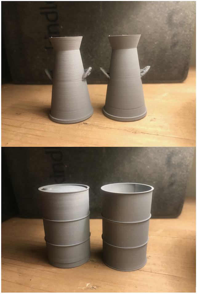

tbh I've never done an actual timed print comparison. I've simply got used to things always taking longer than I want/expect. Since I changed down to 0.1 I think there have been a couple of times when the projected print time seemed longer than I was prepared to give it and changed up, but I can't even remember what I was doing now.
However I've just looked at my remixed open topped barrel and the slicer gives projected times of 3hr 27mins at 0.1 and 1hr 58mins at 0.18. Its usually pretty accurate so I'd guess those are pretty good, give or take a few mins. That's using PLA and with a 5mm wide brim.
Doing it at your 0.08 ( which I've never tried in reality) it projects 4hr 17mins.

philipy wrote: Sun Feb 07, 2021 8:46 pm However I've just looked at my remixed open topped barrel and the slicer gives projected times of 3hr 27mins at 0.1 and 1hr 58mins at 0.18. Its usually pretty accurate so I'd guess those are pretty good, give or take a few mins. That's using PLA and with a 5mm wide brim.
Interesting - the time factor for your printer increasing the resolution is more efficient than mine... but it's of a similar order.
I didn't print your open barrel in PLA (I used ABS) but I've just loaded it into my slider to see what it says for PLA. What's strange is the timings from Flashprint are of a significantly different magnitude... 1 hr 15mins at at 0.08mm or 0hr 27mins at 0.18mm. That's with Flashprint's standard raft. I've just been using the speed settings it gives me... but maybe I should be slowing it down? Would I see a significant improvement in quality?

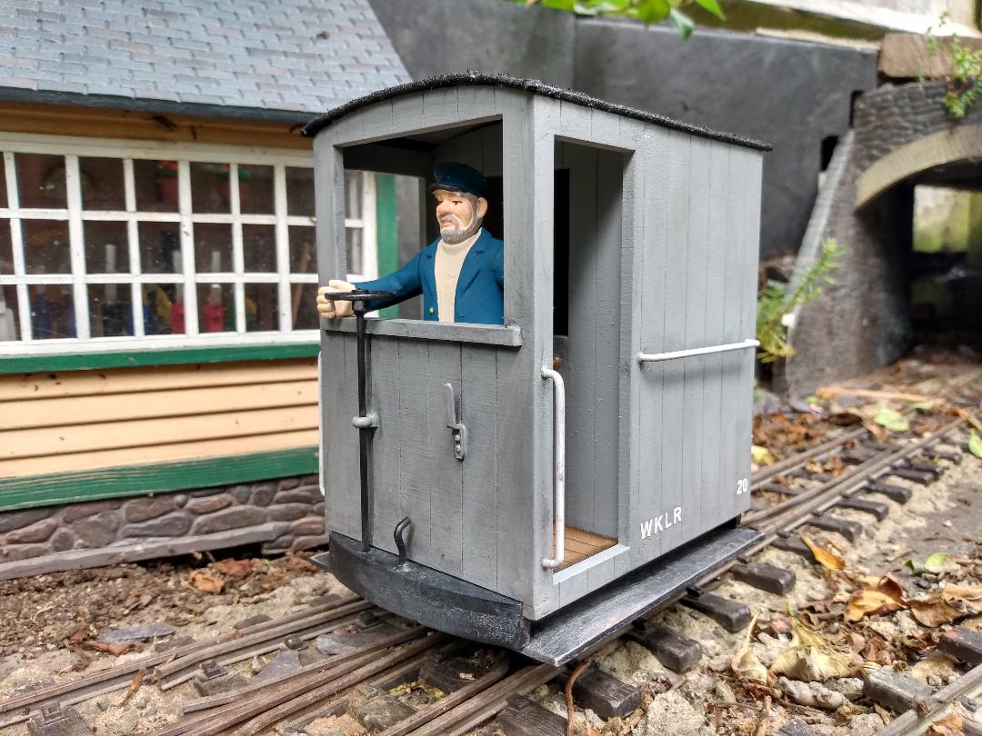

Post by SimonWood » Sat Mar 06, 2021 10:06 am
SimonWood wrote: Wed Dec 16, 2020 9:15 pm
"Great men are forged in fire. It is the privilege of lesser men to light the flame."
I finally got around to painting Sir John...
Still finding eyes very difficult to do.
On the footplate and just waiting for some Daleks...
Have to get on and print a TARDIS now...

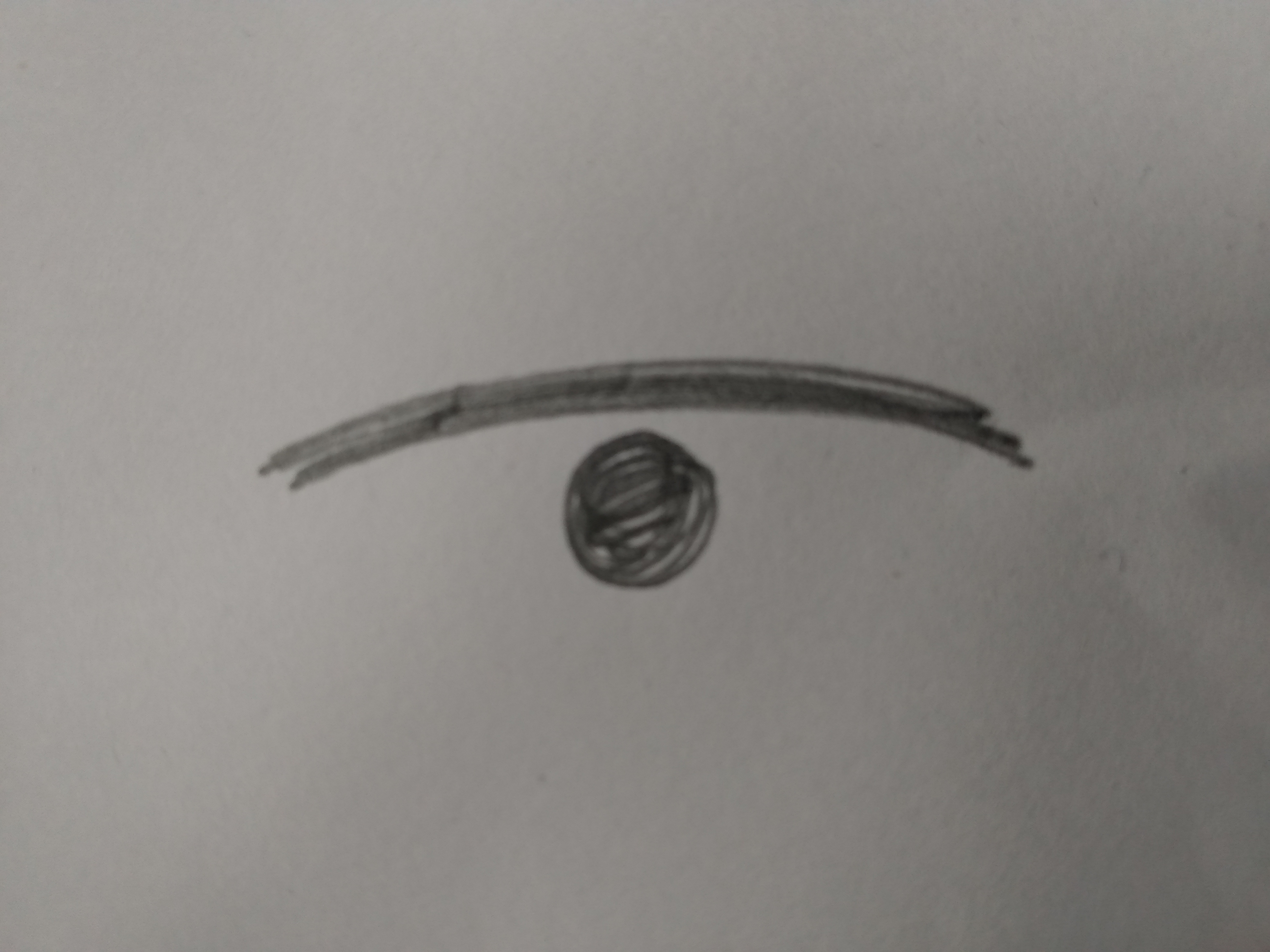

For what it's worth, my own method of painting eyes on figures evolved some years ago, based on the style adopted by some action figure manufacturers, and advice from my secondary school art teacher (otherwise quite mad). I avoid painting the whites altogether ( on the grounds that from most scale distances you're too far away to "see the whites of their eyes") and only add the pupil, plus a line to represent the upper brow/lashes:
I'm typing on my phone, can't find a picture of one of my figures to add (the above was literally sketched on the back of an envelope), but it works for me - well I think so anyway!

PS Just had another look at Sir John and seen those wonderful bushy eyebrows - in his case I guess the line I suggest above the pupil would definitely represent the eyelashes, not the brow. I don't think I've ever thought about it that much, it just seems to work for me... Here's my ex Captain Haddock guard - not one of my better examples, but it shows the technique...

Andrew wrote: Sat Mar 06, 2021 11:02 am For what it's worth, my own method of painting eyes on figures evolved some years ago, based on the style adopted by some action figure manufacturers, and advice from my secondary school art teacher (otherwise quite mad). I avoid painting the whites altogether ( on the grounds that from most scale distances you're too far away to "see the whites of their eyes") and only add the pupil, plus a line to represent the upper brow/lashes:
That's a great tip Andrew, thanks. I can see how even if it's just the upper lashes it gives the shape of the eye, which is the key problem (essentially the whites are too round, and too large relative to the iris). I will give that a go on Sir John.
