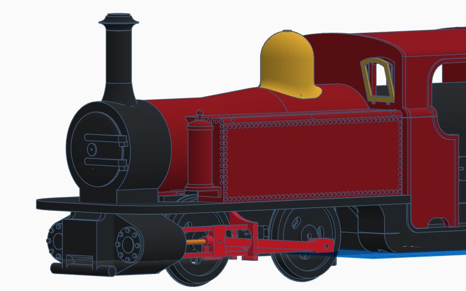

Added a bit of detailing to the boiler section today, looks better for it I think.

That really makes a difference, particularly the sand pots - I knew there was something missing!

It did indeed have bits missing and still does, lots and lots to design yet, but getting there, I will start the first test prints next week hopefully.

I see what you mean about the rivets. Perhaps I over emphasise the rivets. Scaling effects are interesting. I think some things have to be over scale to have the expected impact. I make my rivets 1mm diameter and 1mm high - just laziness really.

Not that I am a rivet counter, but there are actually less rivets on mine than the real one, they are really small and close on the real one.
Close up they look pretty much better, the 2nd picture is one of the ones I am working from.

I tend to make rivets at about 1 x 1 as well. Any smaller and neither Sketchup nor my printer like them!

I tend to use the dome shape in TinkerCAD. My default value is 1.5mm dia which gives 0.75mm height

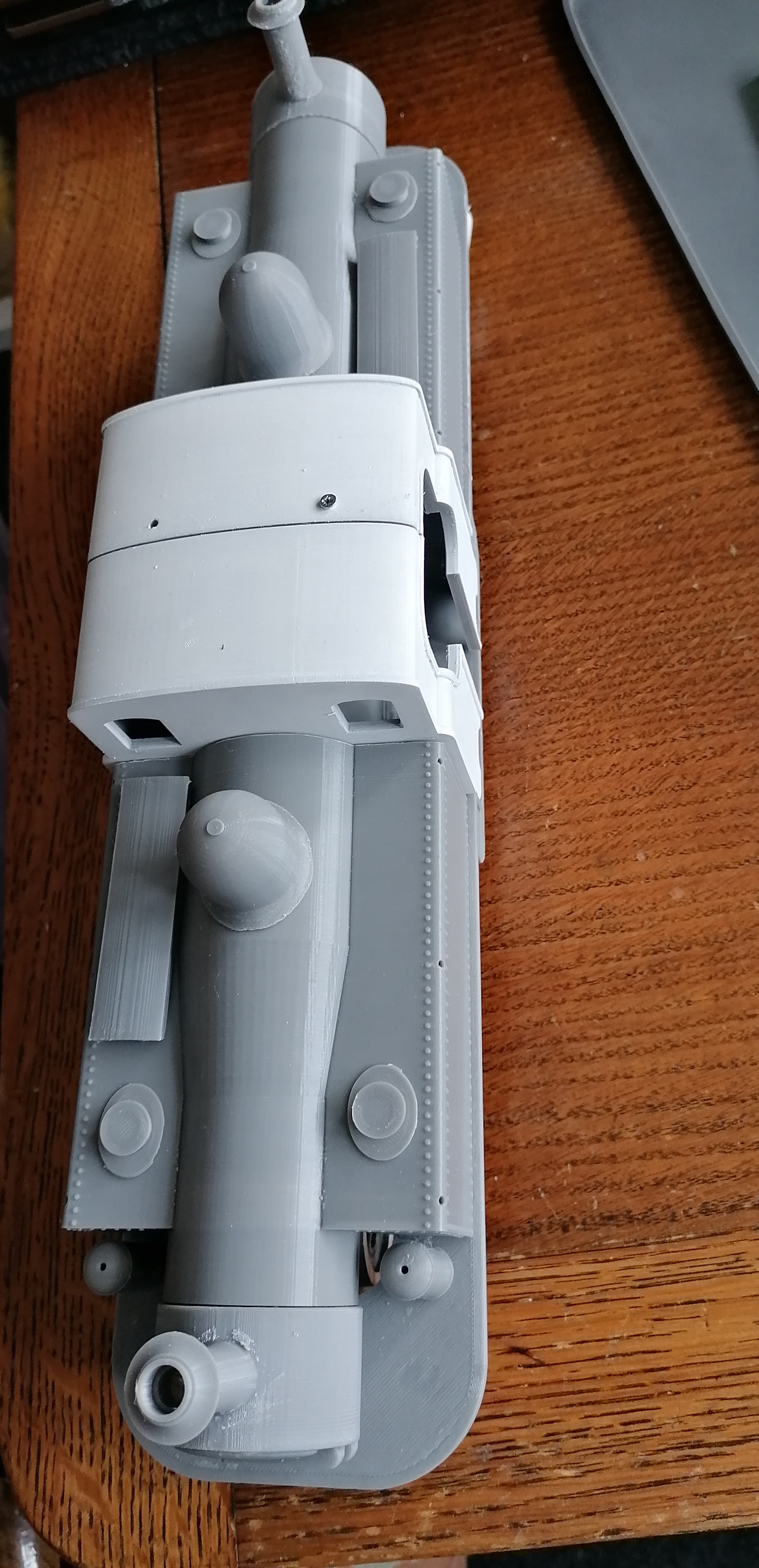

I know a couple of people were hoping this might make it a bit further than just a CAD drawing, well it has. Still a mega amount to do, nothing is glued in place and half the bits aren't even on it, it's just to give an idea of what is likely to look like further down the line, so to speak.
The CAD work has been difficult as I only have photos to base it on and as you would expect not every part fitted every other part, things like the boiler and the smoke box have had umpteen generations and I am still not happy with the smoke box by a long way. Even the cab started as one piece, then ended up as one piece but with a removable roof and in the end I had to split it in to two pieces so I could get at everything, I reckon I have binned around two complete rolls of PLA in the process :shock:
Main problem being this isn't for me, it's for my step father, so I still have one to do for me afterwards, lol.

Wow. Wow. Wow. Etc. Etc.

Quite!! Are the wheels printed as well?

Wot David and Rik said!
That motion is lovely and smooth as well.
Some while ago I did occur to me to have a go at a Fairlie but then I decided my drawing skills probably weren't up to it. Now I'm glad I didn't show myself up!

That's looking fantastic! Your step-father's a lucky man!
