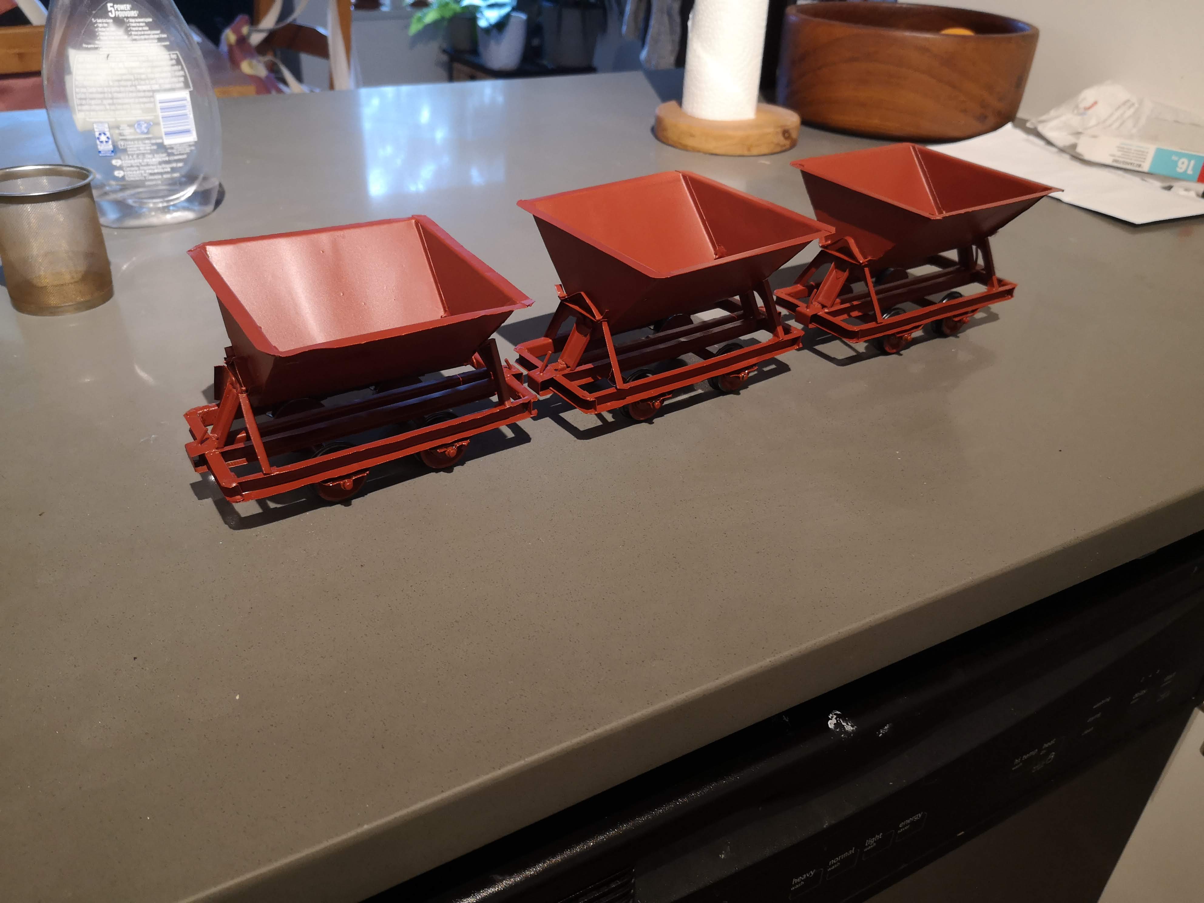

Despite writing a mental shopping list of all the things I was going to go out and buy yesterday (flux remover, etch primer, top coat...) I woke up in the morning and figured why bother? I've got literally the cost of the wheelsets into these wagons, why go buying lots of fancy paint?
So instead I had a rummage through my paint box. I found some automotive epoxy primer in red oxide brown, and some satin clear lacquer of a different brand intended for 'craft' applications. No cleaning. No sanding. Done.
It's very easy to repaint again if necessary. The colour is a bit too red for my tastes, but maybe it will tone down.
The one trick I did do was to use a product called liquid mask on the wheel treads before painting. It's a liquid latex solution used in painting RC car body shells. You brush it on, let it dry into a rubbery film, and then cut and peel away segments as you want to paint them. It just saves having to mess around wiping wet paint off the wheels whilst the rest of the wagon is wet.

If you can tolerate the smell, I find cotton swabs dipped in enamel or lacquer thinners, makes a quick tidy job of removing paint from the running surfaces of wheels.
Re: The Reading and Squamish Light Railway Stock Thread
Great paint job Ted. And cheap too. If you have any weathering powders, you can easily tone the paint down, some black, brown and grey mixed up to a dirty mud colour. Experiment on a bit of scrap of whatever you have and you will get something that will work.

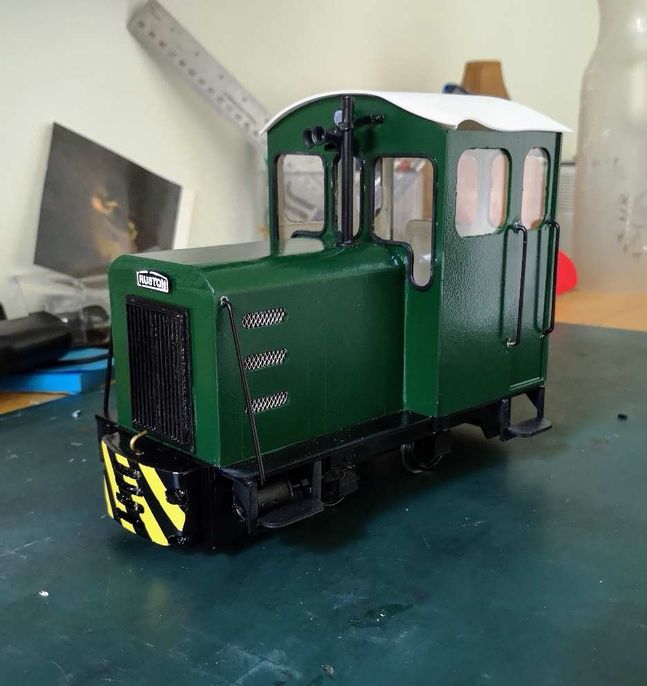

The Reading & Squamish workshops recently commissioned some supporting motive power in light of the increased stock arriving on the line...
The work experience kid already managed to drive it into the workshop doorway, incurring some minor roof damage. The manager had some coarse language to share!
OOOhh. That will look nice pushing the skips around.
- Posts: 1902
Nice one Ted, I like the way the windows drop down either side of the engine casing, very prototypical.

Heh. It's an IP Glaslyn kit, built exactly per the instructions, so I can't take too much credit!LNR wrote: Sun Jun 07, 2020 12:40 am Nice one Ted, I like the way the windows drop down either side of the engine casing, very prototypical.
I'll be honest, I was a bit disappointed with some aspects of the kit. The website description describes it as "made from CNC machined & cast metal parts." This is a bit of clever wording, as the only CNC-ing is on plastic parts, which make up the bulk of the construction. Further, as far as I can tell, the supplied battery box is too large to fit under the bonnet (where the motor also sits) so for now it's in the cab in plane sight. I plan on reconfiguring the electronics at some point anyway. Still, it'll be fun to have trundling around between steam-powered runs.

Is the roof plastic Ted, or aluminium.

Plastic. Whilst the kit has no interior I wanted to make the roof removable when/in case I make one. I heated the roof a bit to help it form around the supports but overdid it slightly I guess, hence the warped corner.

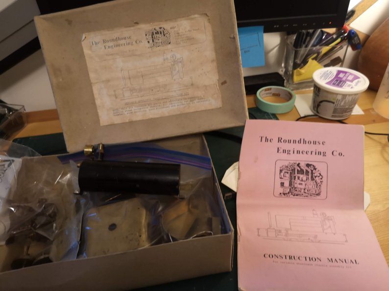

This is a very early meths fired Dylan kit courtesy of Anything Narrow Gauge. I'll need to convert it to 45mm gauge, which shouldn't be too hard thanks to some tips from Tony at Rhos Helyg Loco Works. However, it's definitely going to be a step up from my Lady Anne build. Step 1 is to decide on the wheelbase and axle configurations and drill frames and coupling rods accordingly...
Two other immediate concerns on inspection are that it has a brass boiler, and both the exhaust pipes need re-soldering into the cylinder blocks. Reading around it seems brass boilers want tap water and to be drained after every run. Since I do both these things anyway (Vancouver water is very soft) I'm hoping I needn't be too concerned?
Regarding resoldering the exhaust pipes, they look to be soft soldered, but I'm thinking these likely get pretty hot and I'd be better off silver soldering them? I can easily soft solder at home, but silver soldering is going to require me to borrow a propane torch.
Oh, and whilst the chassis instructions appear very detailed, I seem to be missing the instructions for assembly of the bodywork. Longshot, but if anyone happens to have a copy...

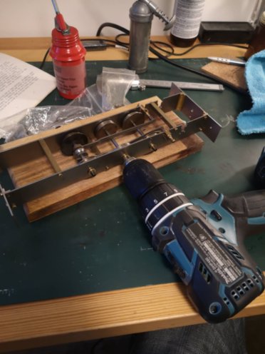

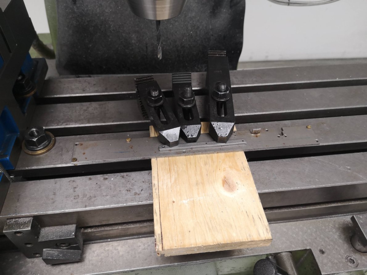

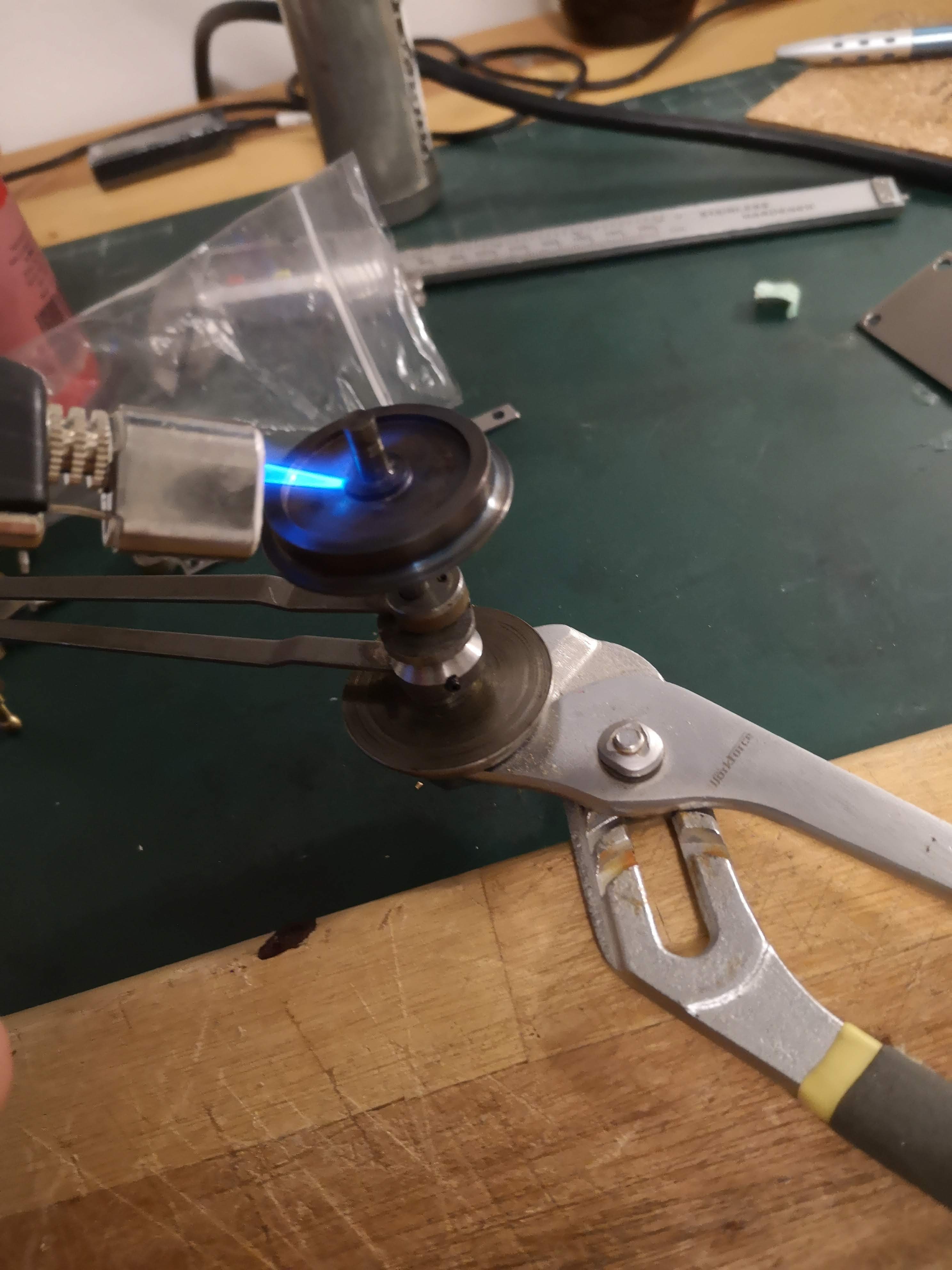

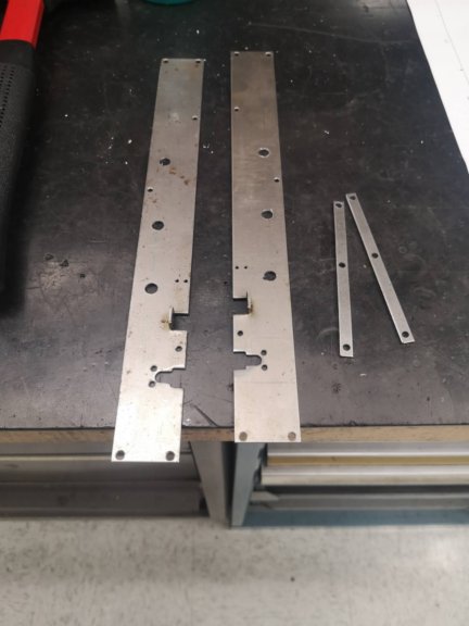

Well, 70mm of rain over the weekend meant I had plenty of excuses to get stuck in.
Before starting to put my new loco together, I had to begin by taking it apart. I first checked the wheel back-to-back measurement with my Roundhouse gauge from my Lady Anne to make sure the modern tool was still ok to use with the older wheelsets. Since the 32mm spacing seemed to match the gauge, I figured the 45mm would too. The wheelsets were attacked with a propane torch (I would later find out my little butane torch works fine too) to brake the ~30 year old loctite so that they could be reset to 45mm. Loctite 603 is recommended as it's a wicking grade that will seep into the space around the axle, but it's pricey stuff, and I had some 620 already. This is plenty strong enough, but has to be applied to the axle then the wheel slid over as the 620 is too viscous to seep into the gap.
Then I marked out the frames and coupling rods with where the axle holes needed to be drilled. These early kits allowed the builder to build either a 2 or 3-axle chassis. This does, however, mean that builder has a few significant extra steps to complete before reaching what is essentially 'step one' of a modern kit build. I decided to go for an 0-6-0 as I thought it might look odd to have a loco the same size as my Lady Anne with one less axle. At this point, I relocated to our shop at work. I had it in mind to use the drill press to make sure I drilled everything square. However, once I started setting up I realised that it would be daft not to use the mill, where the linear slide and digital read out allowed me to drill everything in one go with much greater accuracy. So I dusted off my (very rusty) shop skills...
In all honesty, I don't envy anybody who built one of these kits without access to at least a drill press, as it must be very hard to drill everything with good alignment.
The other consequence of my re-gauging the loco was it being necessary to bend the valve rods, as the eccentrics now sat further outboard against the wheels. Not going to lie, this was a royal pain in the proverbial. I'm not entirely sure it would have been much easier without the extra effort of re-gauging, as no matter what I tried, one rod always seemed like it was too long, and one of the eccentrics had a bit of extra solder on it that had to be filed smooth. I ended up having to take one of the rear wheels off the axle to work on the eccentric before re-loctiting it again. Eventually, and with a bit of help from what I thought was a clever trick to run everything in, I got everything running smoothly.
Couldn't resist...
Next I have to take it all apart to paint the frames...
Couldn't resist...
