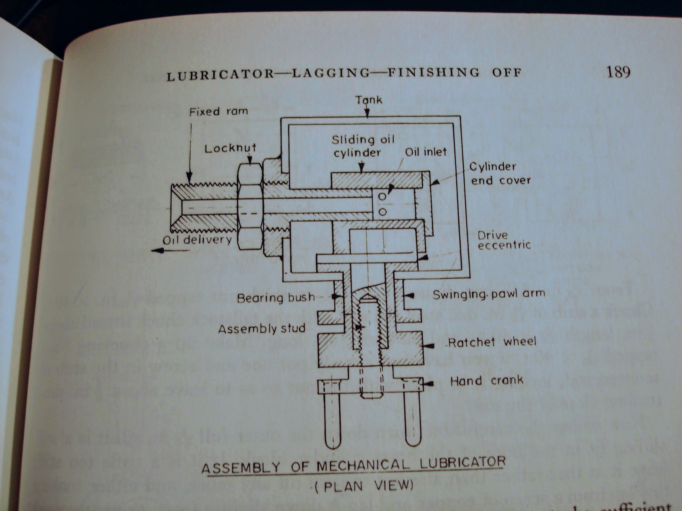

A month ago I decided to have another go at fixing the diesel. The lubricator was still unsatisfactory as was the boiler sight glass. So I took the L.C. Mason book - Scale Model Traction Engine Building "featuring minnie" off the shelf and started to build the mechanical lubricator. It is a delightful little mechanism, very little material, but lots of time. There's the lovely click click of the pawls skipping over the ratchet wheel

That's lovely Dave
Can you please give us some more details?
for example - how big is the body of this lubricator?
Did you build it exactly as per Mason's book or have you used the book as an inspiration and adapted the design for your needs?
Mason's book (long out of print) is nowadays costing silly money
It was also described in details in vol 135-136 of Model Engineer.

Thank youbambuko wrote: Sun Aug 23, 2020 11:23 am Can you please give us some more details?
The tank is 9/16" x 5/8". I built it exactly to the plans. But the 30 tooth ratchet wheel didn't have enough teeth for my application, so I made a 36 and 42 tooth wheel next, the 42 tooth is the one being used, 36 wasn't enough either. So it's 3.5 turns of the wheels to 1 stroke of the pump. The pump delivery is adjustable, it's set to maximum at the moment

Thank you Dave, for details and all the additional photos and explanations
BTW what solder did you use to secure cylinder cover?
Mason just says "...solder to cylinder..." without elaborating whether silver solder or just soft solder.
I can see this lubricator being very useful in other small models as well - thank you for bringing it to our attention

Soft solder, same for the bushes and bearings mounted to the tankbambuko wrote: Mon Aug 24, 2020 10:18 am

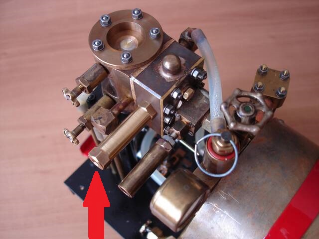

Just had a good run of the loco with a full boiler of water. Had a 35 minute run with the water ending up still above the burner tubes
I had recently made an oil injection port with a non return valve so that I can manually pump oil in with my new 1mL syringes - thanks to eBay
Here's the new oil injection port
Lovely slim syringe body. I was pumping in 0.5 mL for the equivalent of one lap of our circuit
