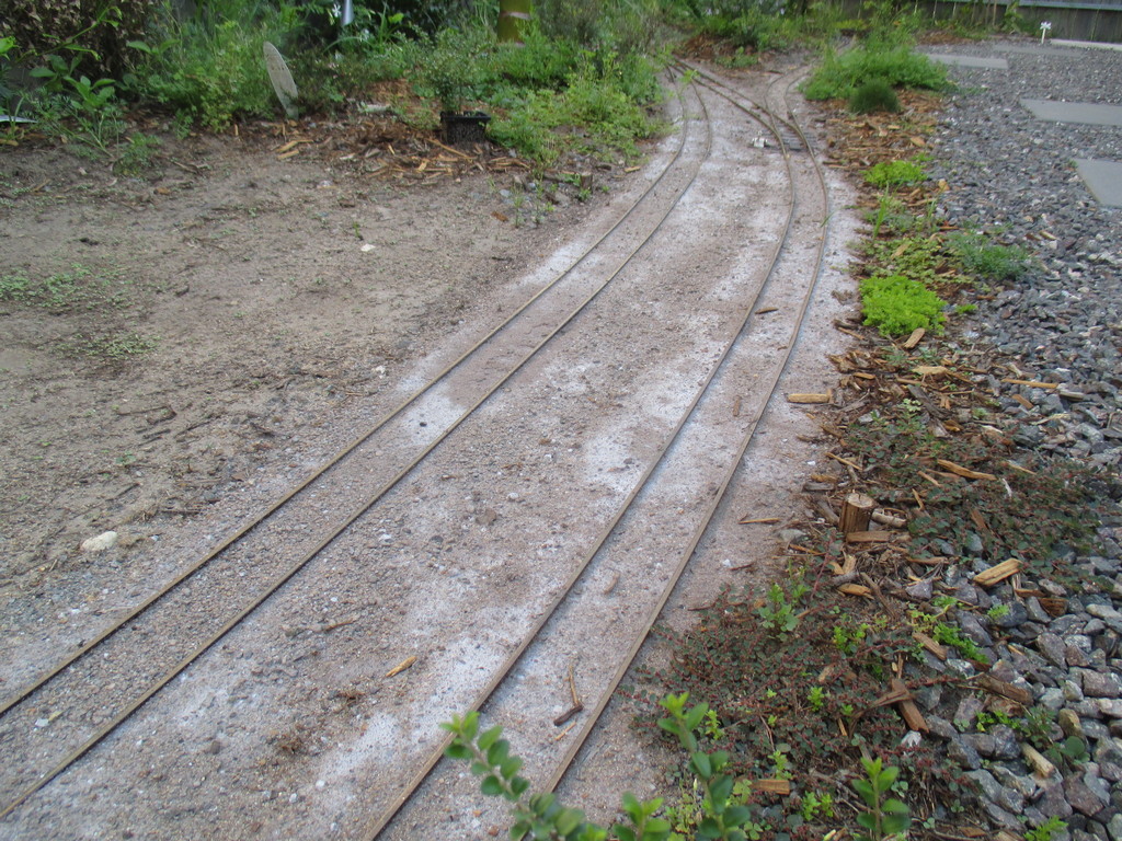

Over half the ballast has turned white, in spite of no rain. Thankfully, there's an excellent forum you may have heard of, that has discussed this issue in the past. I expect this trapped moisture to clear up in the coming weeks. If not, surely our rapidy-approaching Summer will boil it out..

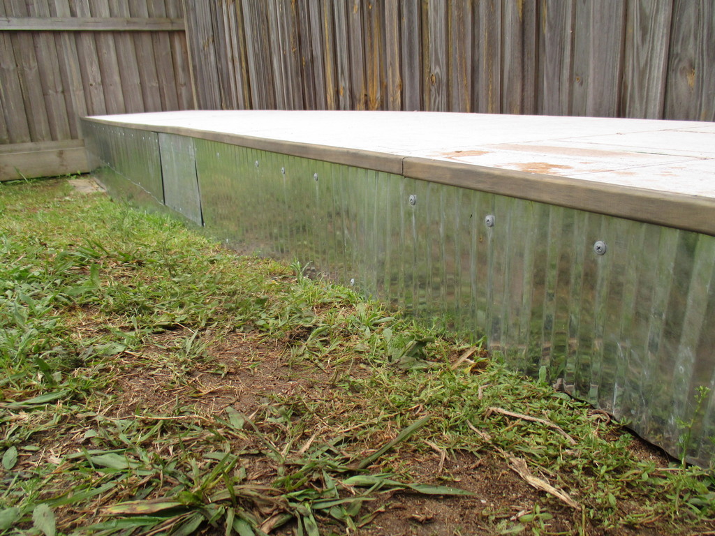

Stealing Mitch Stack's idea of corrugated iron as a fasica, I bought a few rolls of "miniature" iron in strips, intended for use as garden edging. (Wasn't enthused with the idea of cutting up full-size roofing sheets with tinsnips or a grinder)
The trial-and-error job of cutting the sheets to the ground's contour was less of a pain than I expected.
Some extra support timbers (mostly from offcuts) were needed before fitting the iron. The black hose is from the caravan sink, running into a convenient stormwater drain. Aye, it's legal, one can run greywater (sinks, washing machines) into a storm drain in Queensland.
I'll cut and fit the top tomorrow, weather permitting.

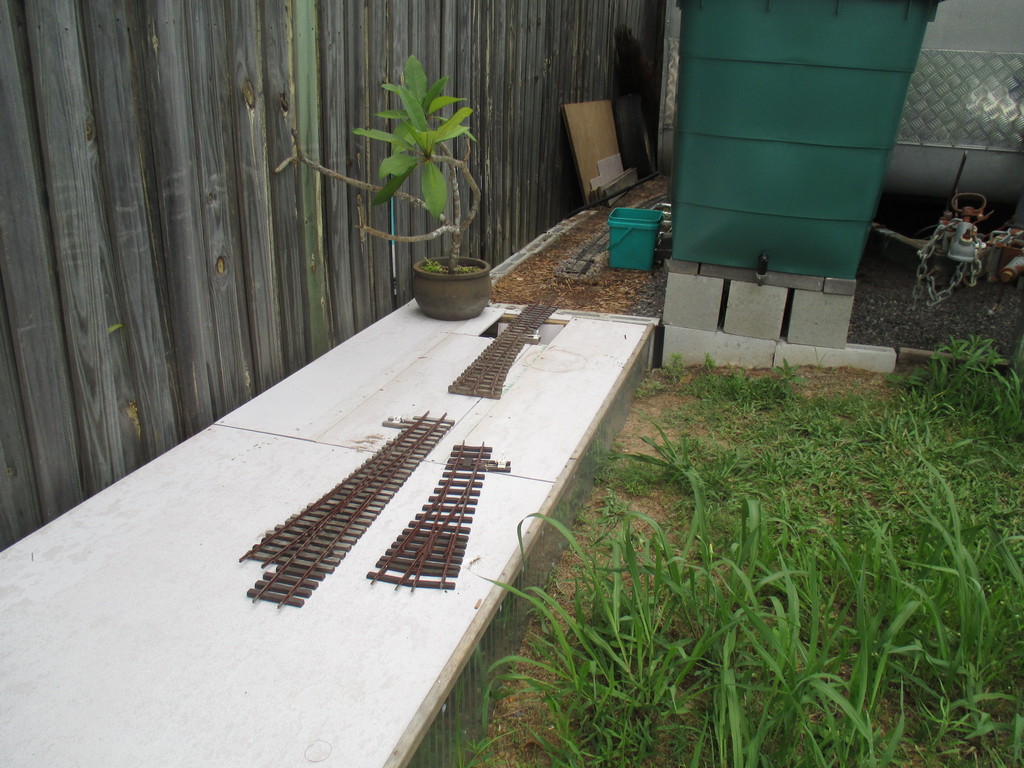

Taking a page from your book and using that fibre cement sheeting for the top of my elevated section, as you have. Hoping to cut and fit it between showers today.

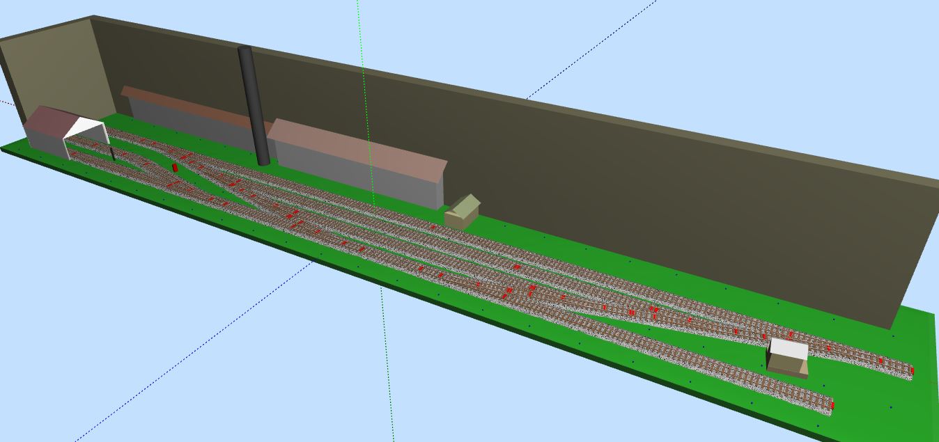

A very rough idea of Phase Two at this stage, rendered in SCARM.

The fibro top has been fitted, along with some milled pine "angle" trim on the front edge. The trim (which was distressed with a wire brush before staining) took many coats of the vinegar/rust mix, and it still looks new in places, but the Summer will deal with that. Track is on hand, but still waiting to hear back from Roundhouse about some points. The throws are en-route from Tenmille.

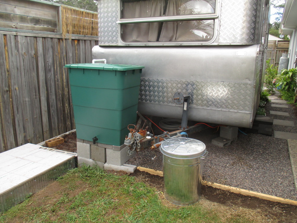

The water tank has been mounted and plumbed. Also finally installed a border between gravel and lawn, much tidier now.
Should think about disguising the besser blocks..

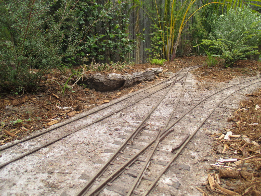

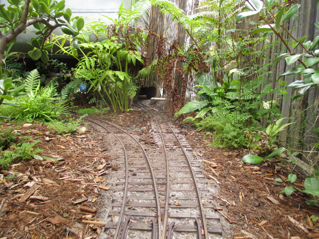

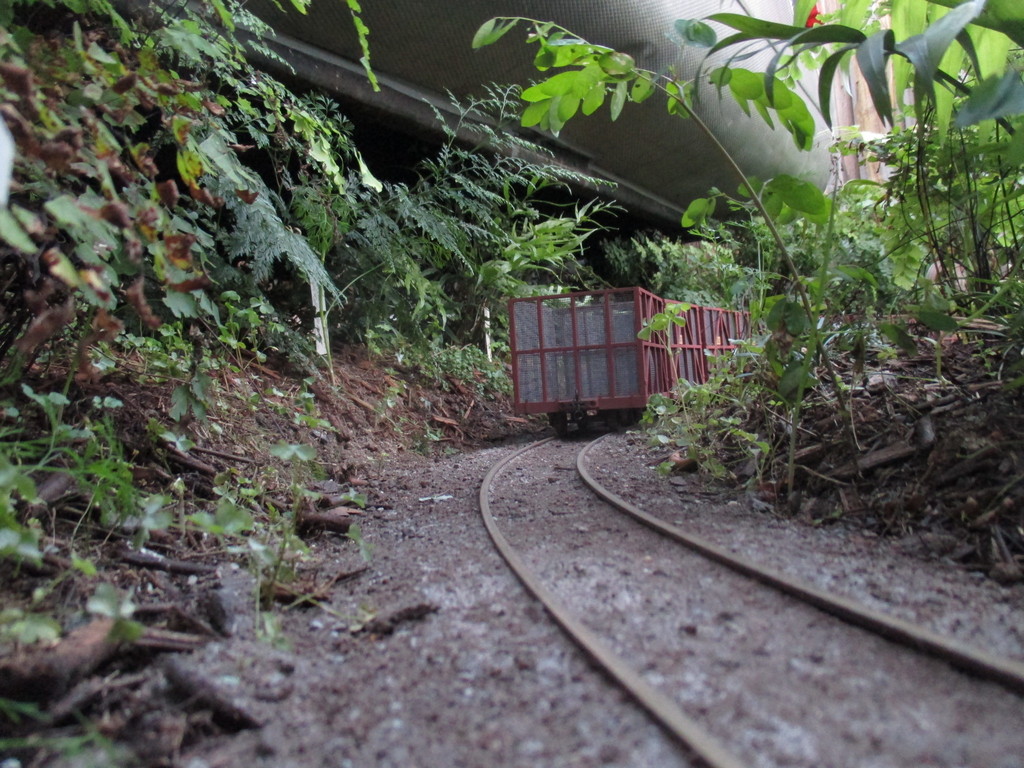

26/09/2020

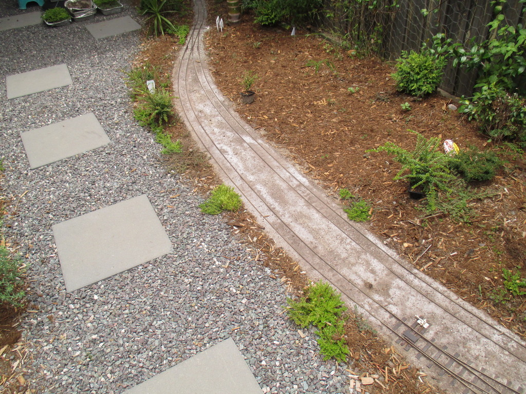

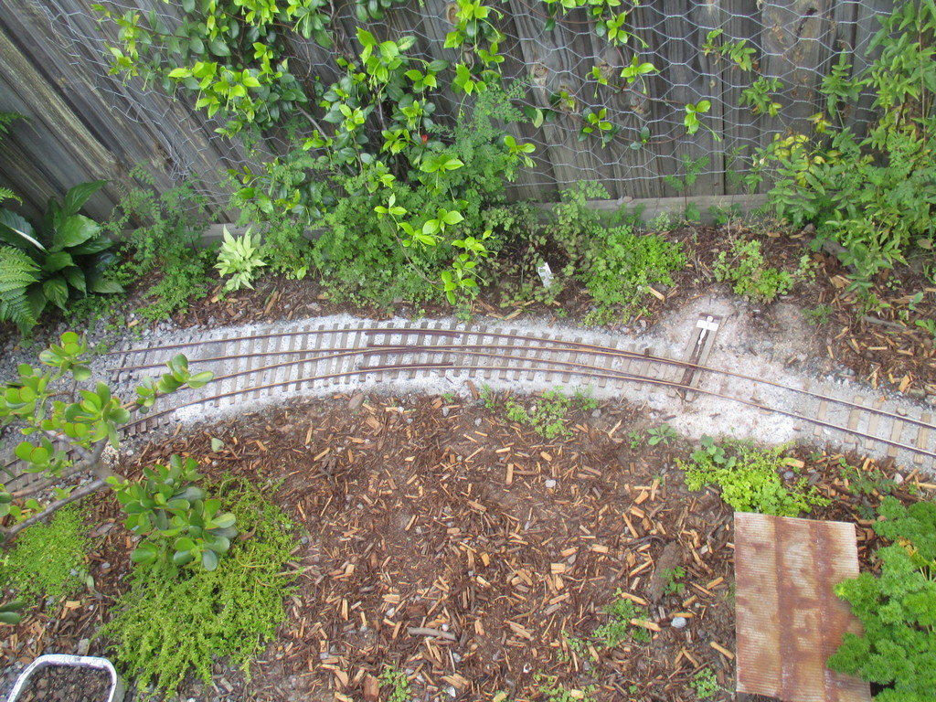

Most of the "whitening" of the ballast steadfastly refused to dissipate, so I took to brushing washes of cement dye onto the affected patches. Several applications were required, but it appears to have worked and left the ballast looking more-so as it was intended. In the end, most of the track received at least a weak wash over it, which helped further improve it's depth and texture. A couple of "Before" photos of the worst-affected sections:
10/10/20

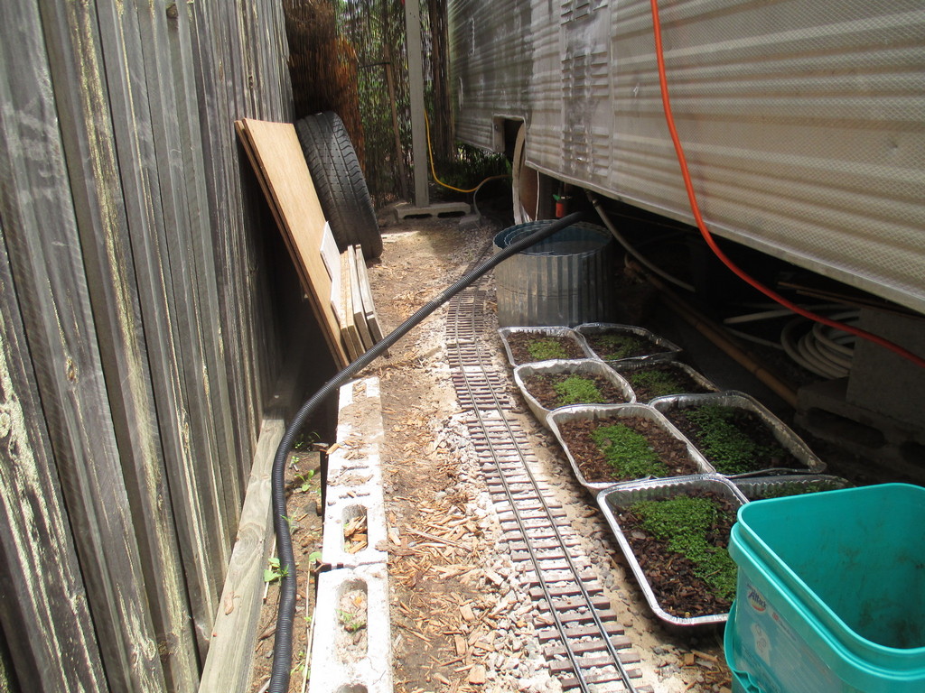

Two other sections in the "rainforest" section near the van, were so bad that I neglected to photograph them at all. Removed the ballast, replaced with a new mix, and sprayed it with glue/water mix only once - unlike spraying twice, as I did to the rest of the track, which caused the whitening. This new mix has more soil in it, along with a little potting mix and slow-release fertiliser, rendering it more conducive to The MYOB.

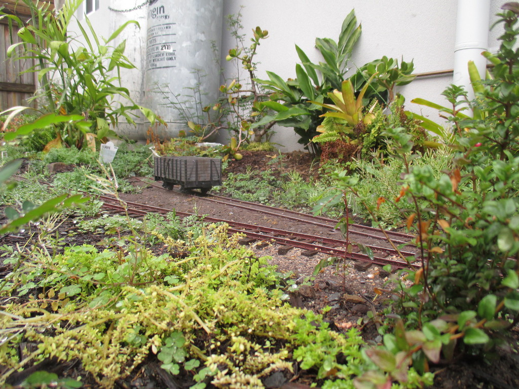

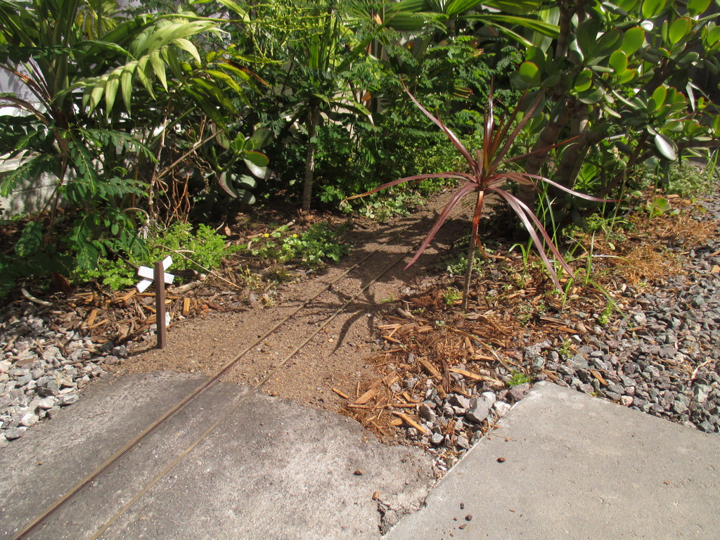

Speaking of which, is spreading nicely, and has filled out the BBQ trays I'd set up to propagate the stuff.
The trays' contents were split up, leaving a clump of MYOB in the center of each tray, and the void around them re-filled with new potting mix, thoroughly watering in. Currently watering it all every second day.
The displaced clumps were planted randomly around the newly-ballasted track, so as to spread into the track from multiple directions.
As this is the only part of the garden that remains moist and cool enough to allow that "grassy track" so commonly found on cane tramways, I'm all too eager to exploit the fast-spreading nature of MYOB.

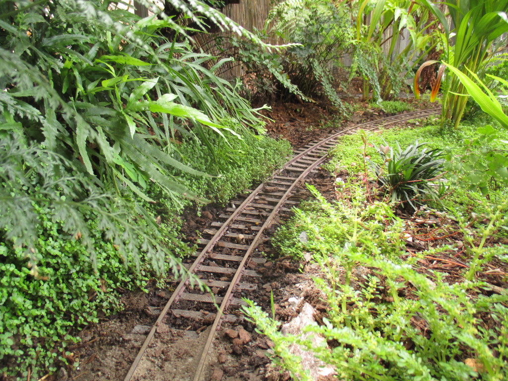

This section received the same treatment. The crossings have been stained with black cement dye, but the concrete mix used to make the crossings months back, is not very durable - it slowly rubs away with one's finger. The rain, track sweeper etc. will erode these crossings and they'll need occasional re-staining. That'll teach me for forgetting the cement dye when mixing concrete..

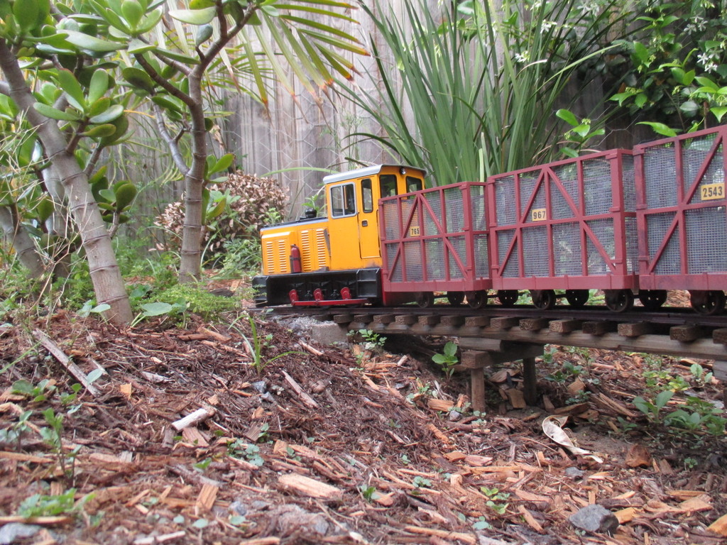

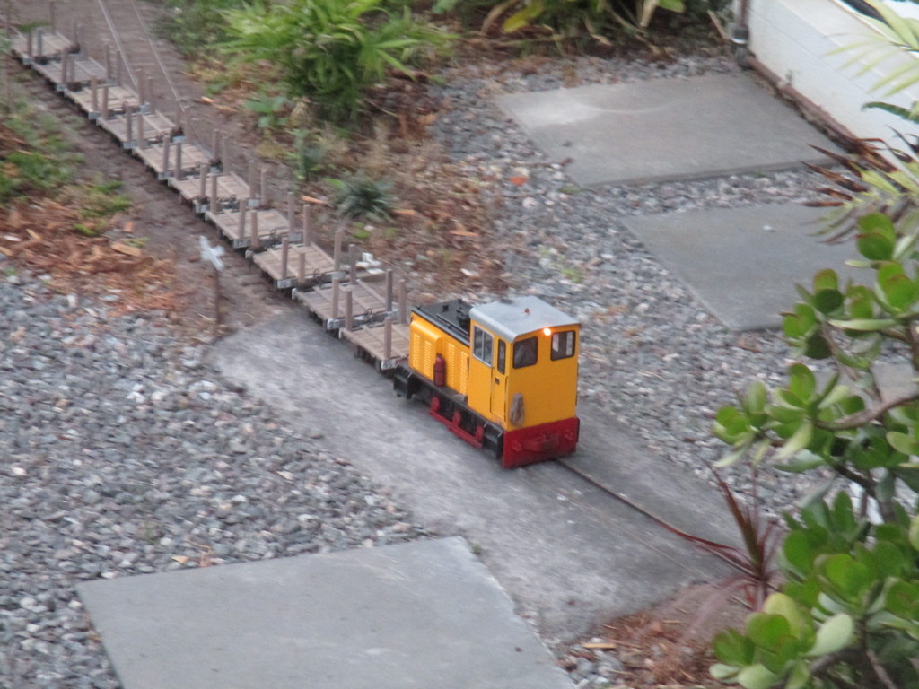

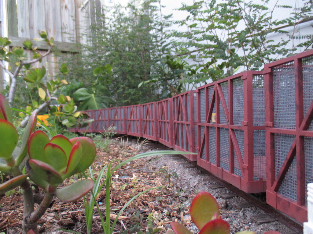

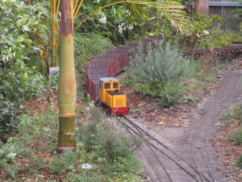

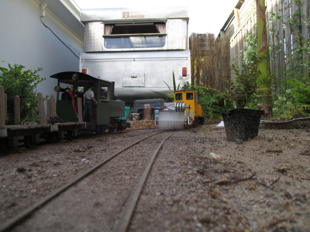

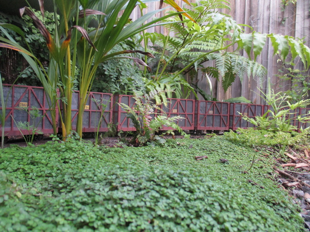

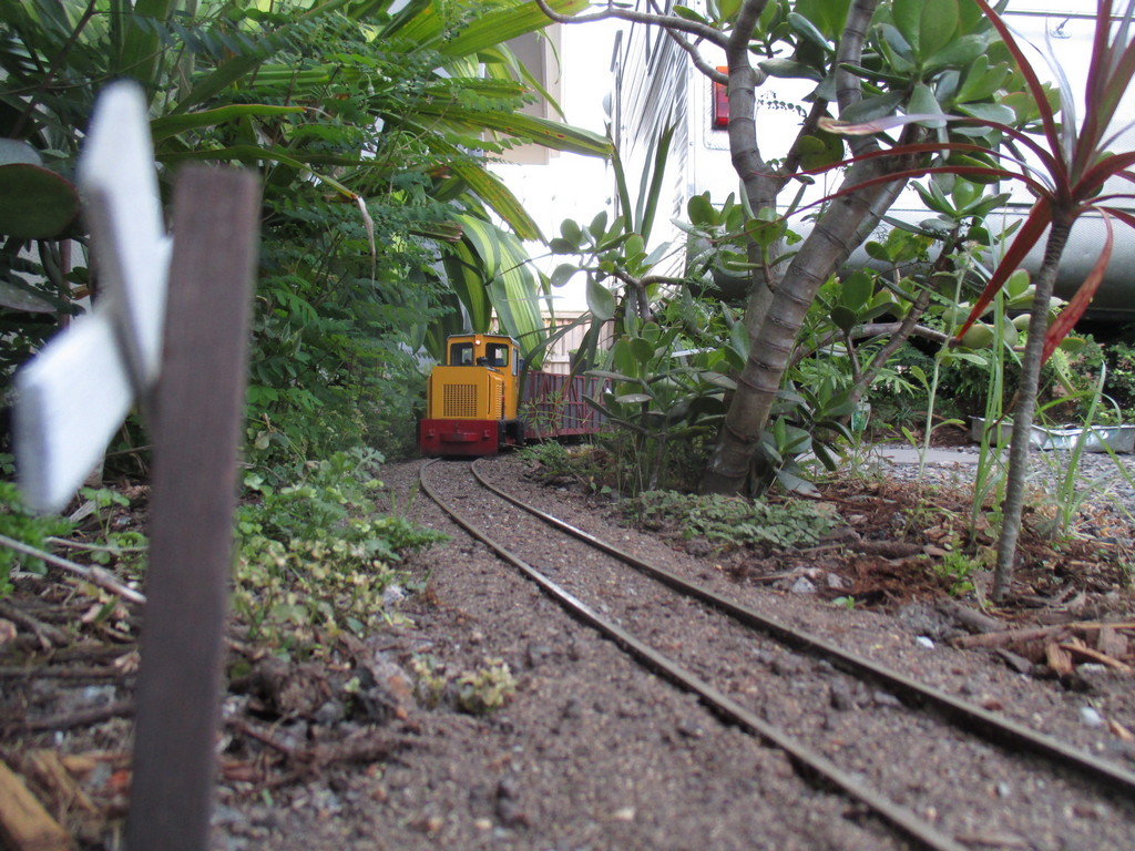

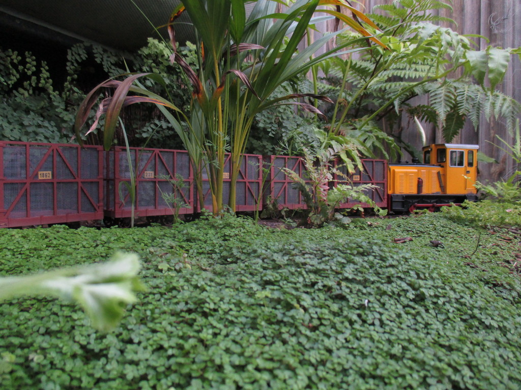

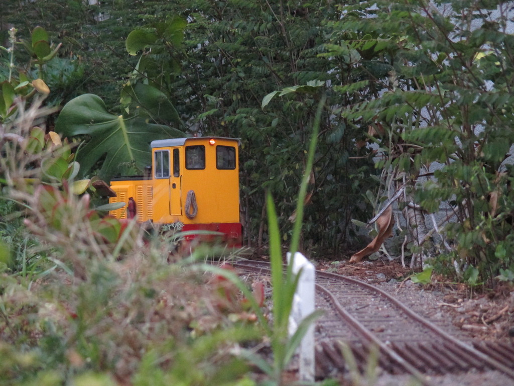

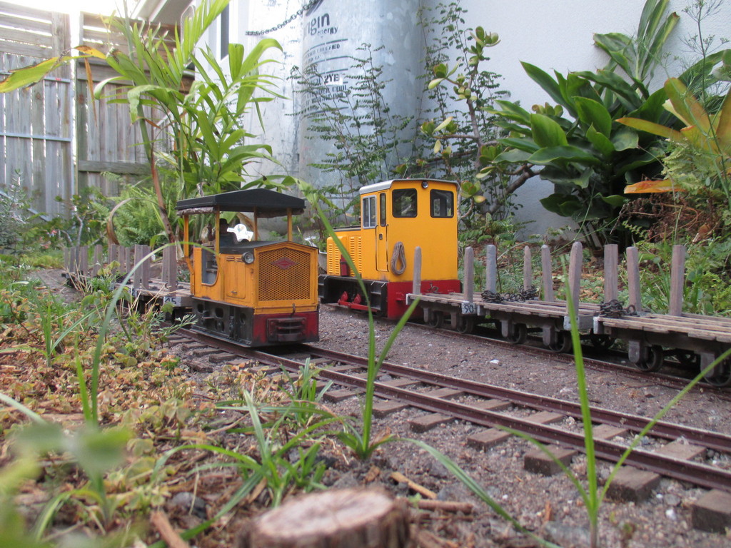

Had a run yesterday, reminiscent of old Moreton Mill. The Baguley will at some point receive more weathering to soften that harsh yellow a bit.

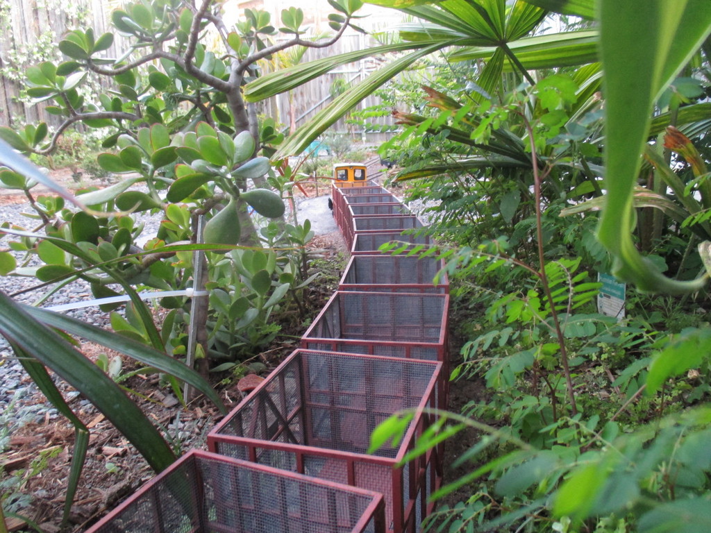

View from the workshop in the van:

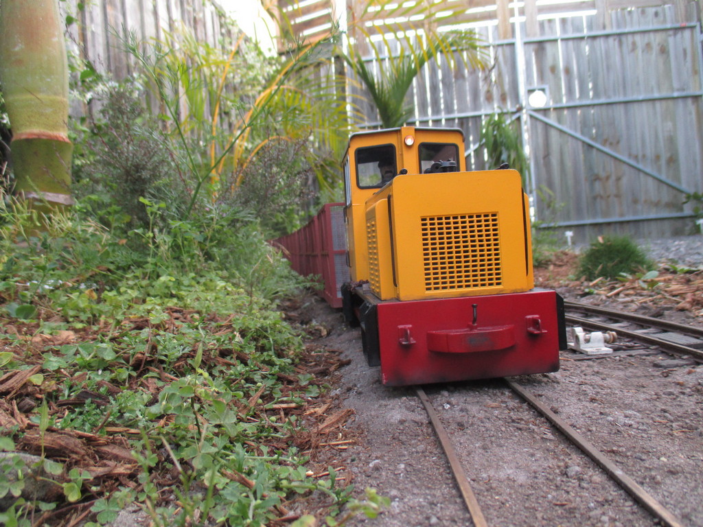

Working up the grade toward the side-door-of-the-house crossing. Even for a little setup like this, I should come up with some names for landmarks..
Will have to get a fire in the Baldwin for a run, soon..

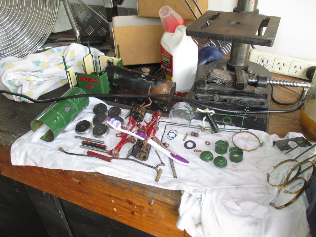

I'm selling my ten wholestick cane trucks this coming Saturday, so out came the Baldwin ("Baron"), Baguley and Malcolm Moore for a final run of the trucks. While the Baguley inches around the circuit with the sweeper, (which works beautifully) the Baldwin is prepped. Despite the loco's previous successful test run six weeks ago, the retrofitted Roundhouse burner was back to behaving very erratically. Couldn't even raise steam. Chasing up the usual causes yielded as ever, no solutions.
To make matters worse, the joint between tube and rear tubeplate had decided to spring a leak. With a faint hiss and occasional drip from the tubeplate, the loco was failed and dumped in the workshop.
By sheer happenstance later that night, I ran across on the internet, a scene taken from The Simpsons , to which I promptly added a caption in order to have a laugh at my misfortune. The resulting image is of course, equally-applicable to Mamod/MSS locos.. :roll:
I've owned this loco from new for seven years, though it dates from 2010. 18th birthday present, and was my first loco. In the ensuing years, it's spent more time in bits than it has serviceable. I could rant for days about the horror this little loco has been. About the usual Accy issues from day one, that oiliness, design and construction issues, poor parts availability and substandard quality of what parts I actually could get.
About how I've long-since vowed never to buy Accucraft again. But we've all heard it before..
So a diesel day it is. I'll admit - touch wood! - that the Baguley runs as well as the 'Moore.
After a rather enjoyable run, I set to having a go at caulking the Baldwin's leaky joint with soft solder. Whilst the repair was successful, another leak reared it's head, through the soft solder. I could strip the loco down yet again and rebuild the boiler properly, then try and fight that burner again - I have after all, made it into a decent little loco.
But what then? What'll go wrong next?
Living with fatigue, means reliability is of ever-increasing importance, and I simply don't have it in me to keep fighting this loco.
With that, "Baron" was degreased for the last time. All the spare parts, seals, and other bits were compiled with the loco in it's box. It's maintenance log printed up, along with a "For Sale" sign with a list of all the extras and upgrades the loco has accumulated over the years - which surprised even me, I'd forgotten just how heavily the thing had been rebuilt to make it work.

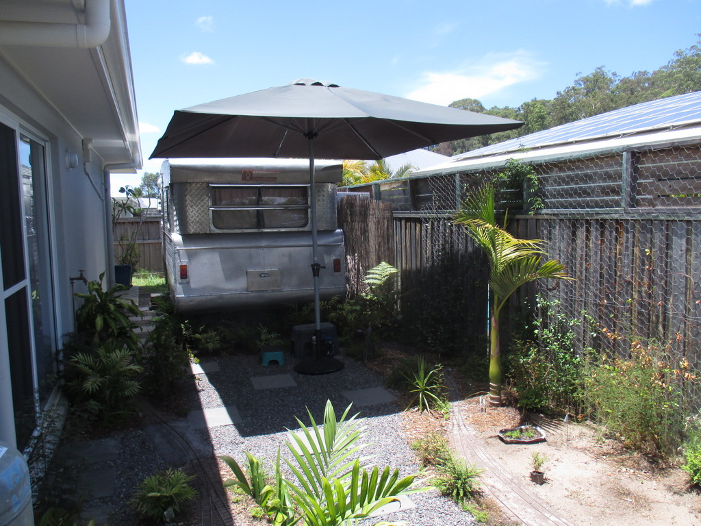

Been too hot for running, but I've kept busy as always. With the change in seasons, the sun now beats down at the rear of the van, starting to kill the ferns and MYOB..
..Forcing the reluctant acquisition of an umbrella. It's been good to have, though; and assuming it lasts, (was $150AUD from Bunnings so I'm not counting on that) it'll be a good thing to have over the steaming sidings on the next tramway, when we buy a place. At the time of writing, thanks to the umbrella, the hot humid air and a daily soaking of tankwater, the plants are springing back very well.
22/12/20

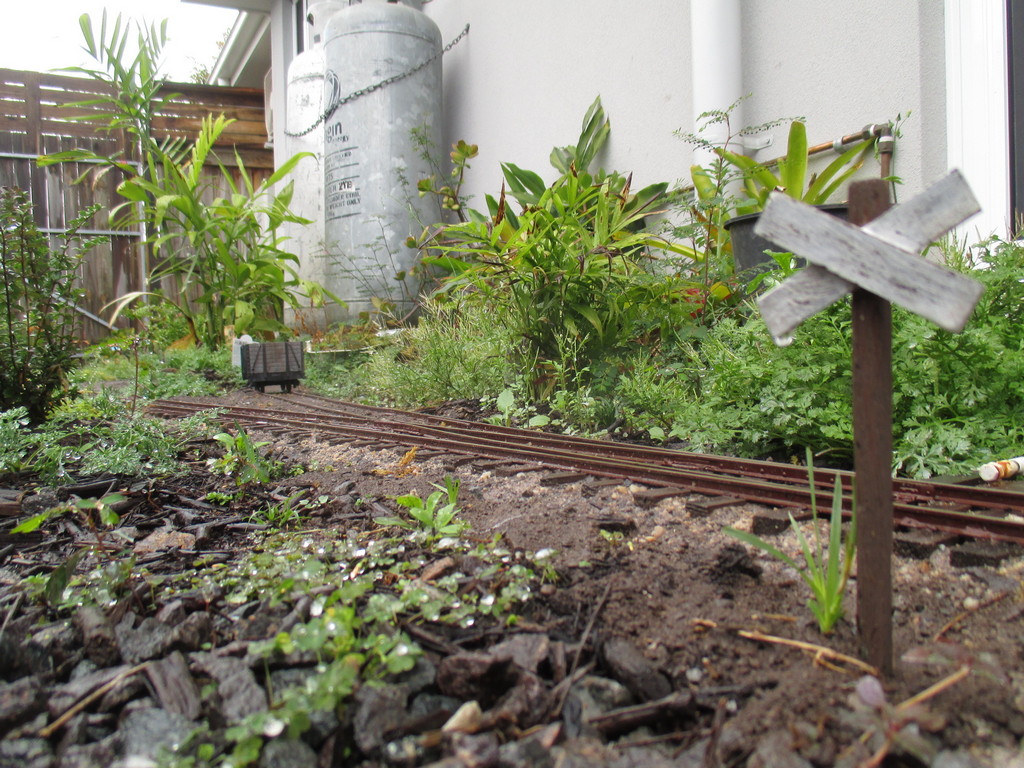

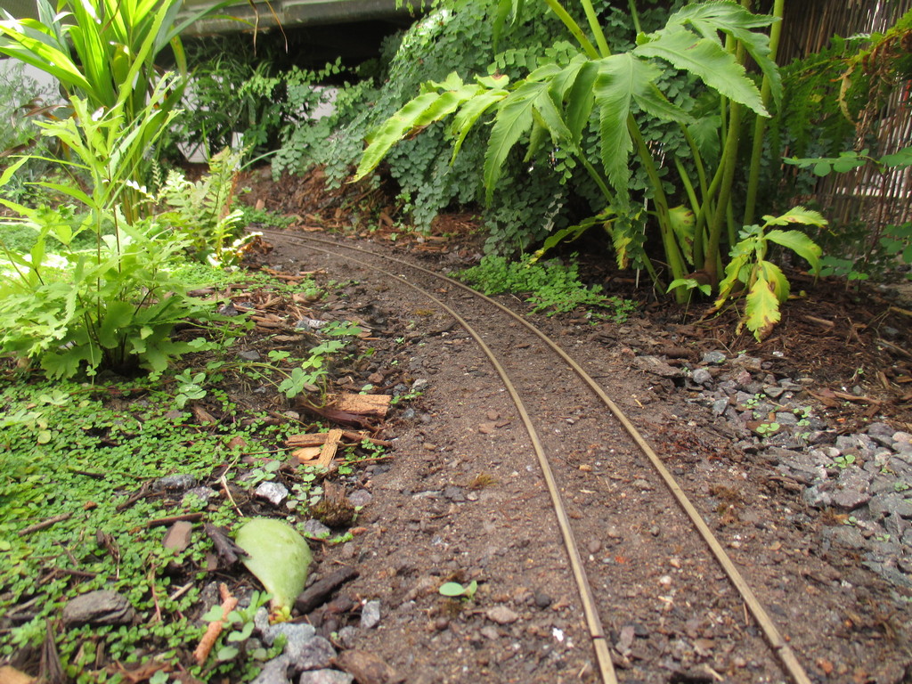

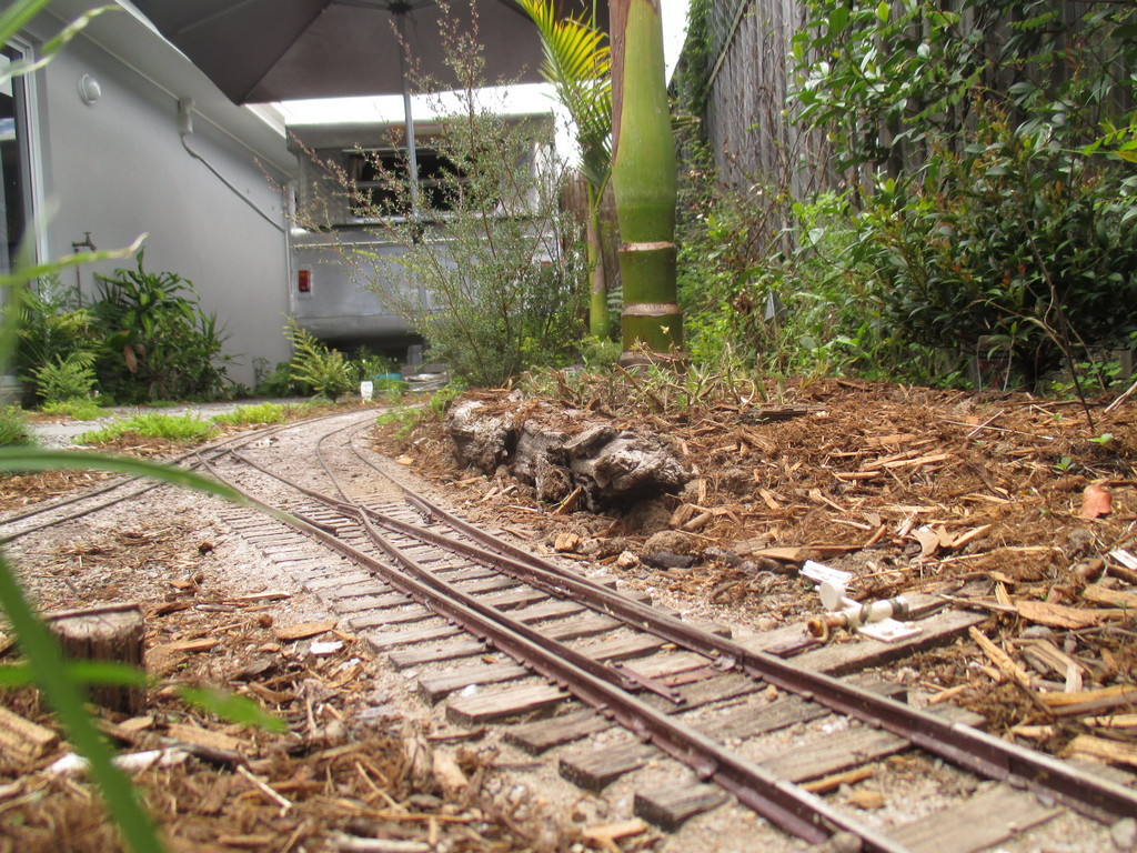

Finally got round to "planting" that lump of tree root, that came in the load of dirt used to level the yard. Also refreshed the mulch, which was a bit thin in places, and planted some more weedy shrub things that I propagate in BBQ trays.
We've had some heavy bouts of rain, which has all but removed the oxide washes used to cover the whitened outdoor PVA in the ballast. I'm waiting out the hot, rainy months, and will re-apply the oxide washes when the weather settles a bit.
The line (center of image) leading to "Stage Two" has been laid, relatively lightly as access to check levels etc. was difficult. The Stainz and track sweeper run across it without issue, though.
The MYOB, whilst spreading nicely, wasn't actually penetrating the ballast here, but creeping across it. In order for the track sweeper to not simply tear it all up as it passes, I need the MYOB to take root between the sleepers. So the ballast was torn up again, this time replaced with just potting mix, and watered in.
Is this about right, for how you Brits get that beautiful MYOB track? We'll see how it goes..

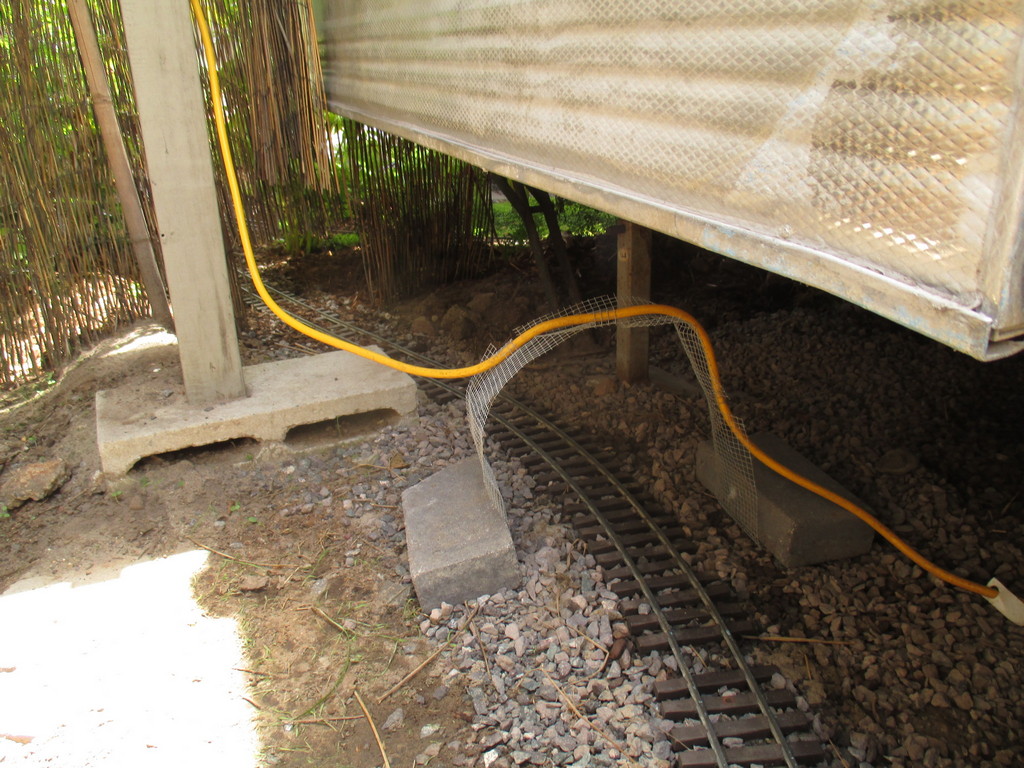

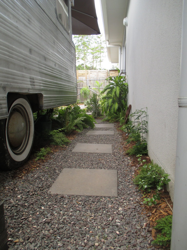

So far, my quick and (filthy) dirty solution for routing the air conditioner's extension lead, seems to work. :roll:
The other side of the van looks much better, now that I've planted most of my shrubby weedy things from the BBQ trays, then moved said trays to behind the van, and propagated more MYOB in them for future use.
The MYOB has been here for two weeks now, and seems content with the limited direct sun it gets in the morning - long as I keep them moist.
I still need to properly route that drain hose from my sink, so trains can pass under it..

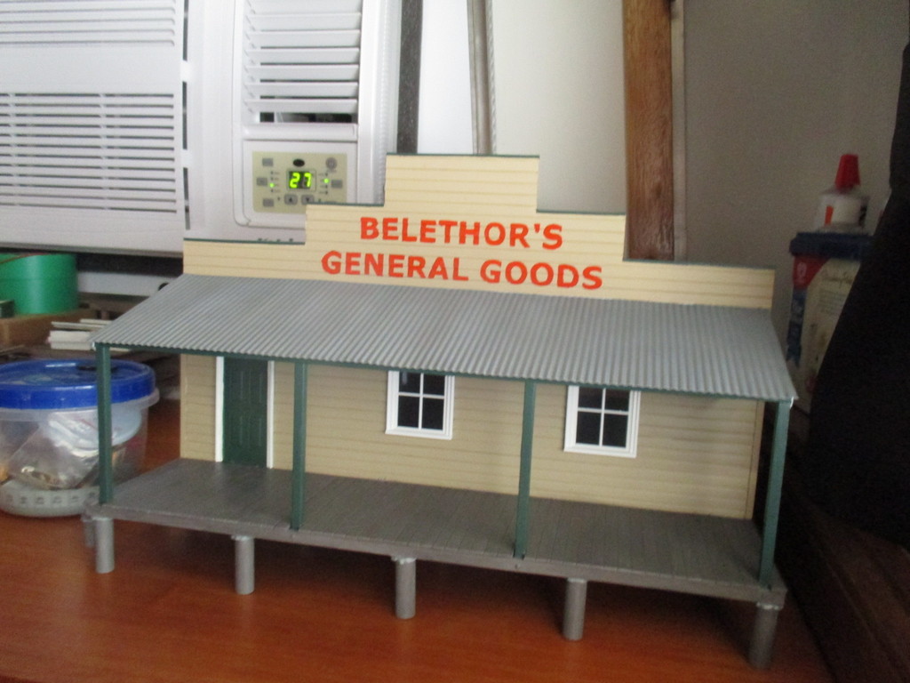

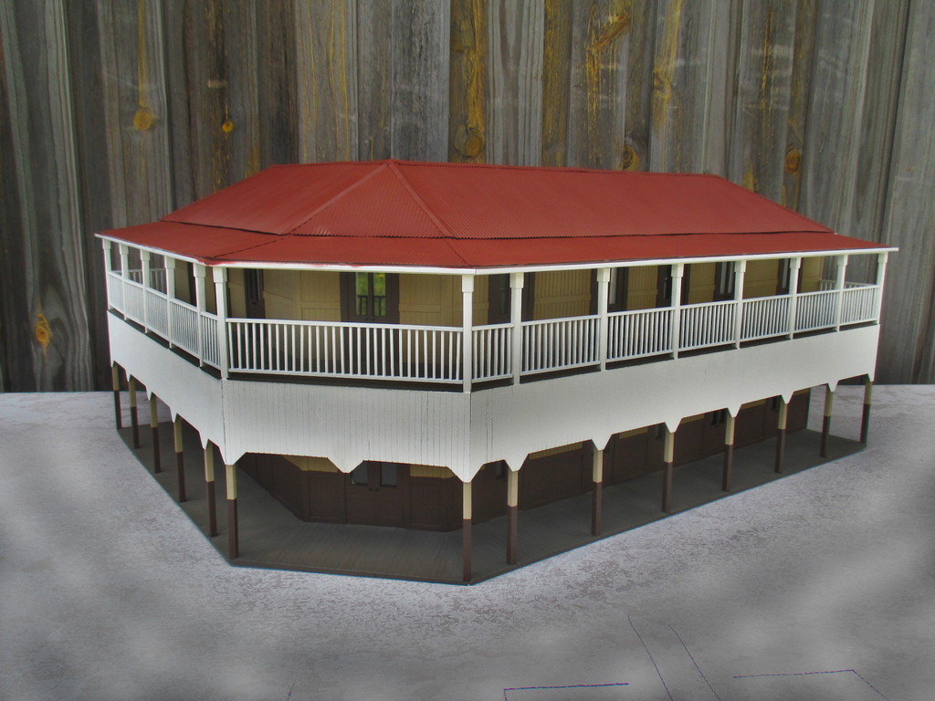

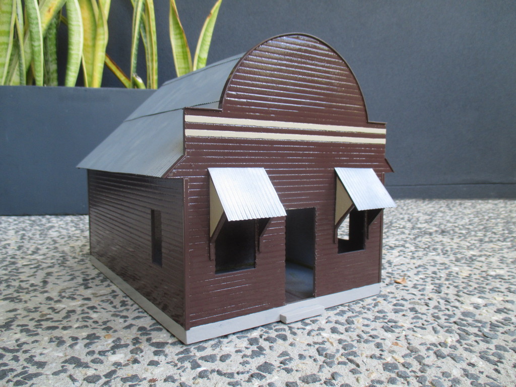

In the meantime, progress is being made on structures. All of foamboard and styrene, with aluminium roof flashing ran through a homemade corrugator.
This general store is based on an unusual prototype that once stood not far from here, in Mapleton, QLD; It had it's own siding served by the Mapleton Tramway. It was unique, to my knowledge, in that the veranda of the store served as a platform, allowing goods to be unloaded from vans and wagons of the daily trams, directly into the store. Kegs of beer and other supplies for the Ocean View Hotel, still standing just over the road, were also unloaded there.
The name is a reference to the game "The Elder Scrolls V: Skyrim". Apologies for this poor quality photo, I'll get a better one soon.
This bank is based on one that stood in Nambour, QLD from 1904-24, when it was demolished in a panicked attempt to create a firebreak, during a blaze that destroyed half the street.

Thanks for the update Aaron, I was only thinking yesterday that we hadn't heard from you recently.
I love the way your Tiny Barren Wasteland has developed, it looks as though it has been there for years, if not centuries! It will be such a shame to have to lift it all when comes the time to move, but I guess that having a permanent place to start again will be worth it.
As for the MYOB, we don't have a problem getting it to root around here :evil: The only problem is stopping it from rooting everywhere. From my experience, it took a little while for it to find it's feet and actually feel comfortable, but after that there is no stopping it, it gets in everywhere. I suspect that water may be your problem, it does like to be damp at least and is better too wet than too dry.
Yes please, I for one would like to see the build of your Hotel, It's a fantastic looking building.

You must have a real green thumb - the plantings around the railway look great. I also love the look of your track - it really fits into the 'jungle'.
Great buildings too. Love the pub.

Your buildings look most impressive Aaron, it will be good to see them in situ. And of course, a thread on the build of the hotel would be most welcome. As if you needed to ask! :lol:

Yes please to the buildings thread!
Your line is looking great - for a "tiny, barren wasteland" you've squeezed in an incredible amount of realism and atmosphere!
Re MYOB, if it grows the same there as here I think you might just need to leave it a while. My ballast is held in place with SBR, so is pretty tough, but although the MYOB starts by growing over the top, before long it's pentrating between the lumps of ballast, despite the glue. I clear the top of my trackbed every now and then just by tugging out the MYOB with my fingers (I think the old WHR probably had pretty scrappy permanent way, but not completely overgrown), but it still seems to grow quite happily on either side...
