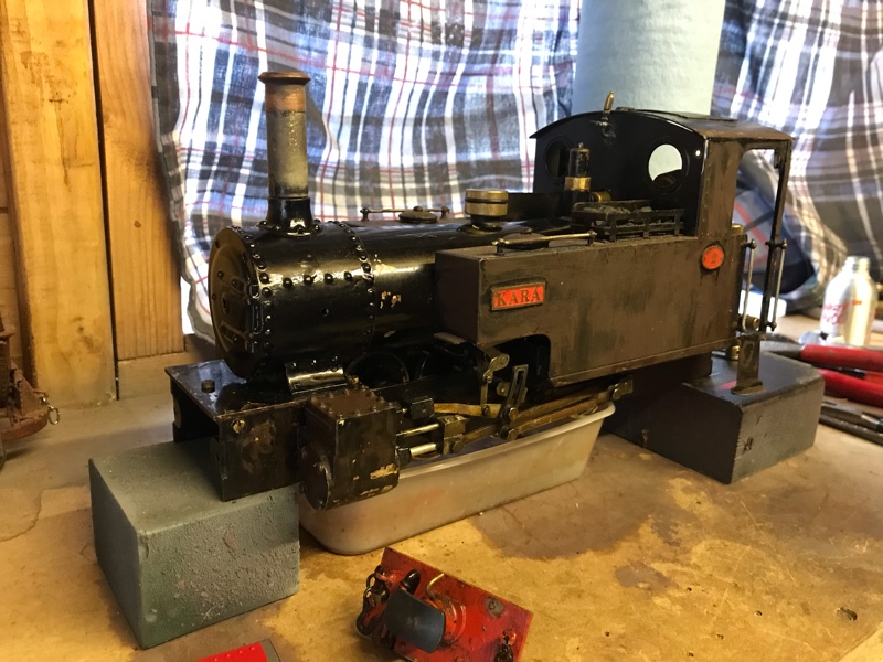

A friend of mine recently asked if I’d be interested in sorting out a lady Anne he’d bough s/h a while back and never got round to doing anything with. I love a project so without much hesitation said yes. I met him down the local model engineering club (keeping 2m distance obviously) and was presented with a toolbox full of bits:
On closer inspection there was a well used lady Anne chassis and pretty ropey body, both seemingly randomly brush painted brown in places, I assume an attempt at weathering...
Along with a brand new body kit and this, which appears to be a wild rose a fair way along the build:
Should be fun!

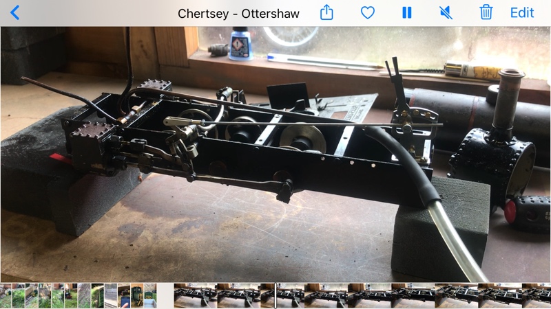

First job was to test the chassis on air, which I did and it ran surprisingly well
[video] https://m.youtube.com/watch?v=ARfXmgytdGg[/video]
After that I set about piecing it together for a steam test:
Couldn’t resist test fitting the body as well...
Had to steal a few of the manual fitting left over from my own rc one but managed to get it together and steamed. It ran nicely but the pressure gauge has given up the ghost and there’s a few minor niggles that want sorting.
[video] https://m.youtube.com/watch?v=_P-0pzx22pY[/video]
[video] https://m.youtube.com/watch?v=KI_5yNtqOcw[/video]

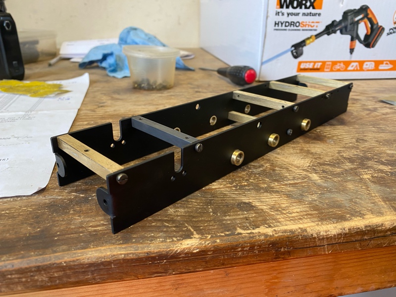

Finally got round to stripping a repainting the frames, they got taken back to bare metal, etch primed, a few coats of grey primer followed by matt black enamel. Decided to chemical blacken rather than paint the bolts and stretcher that will be visible as I figure paint will only interfere with the mating surfaces.

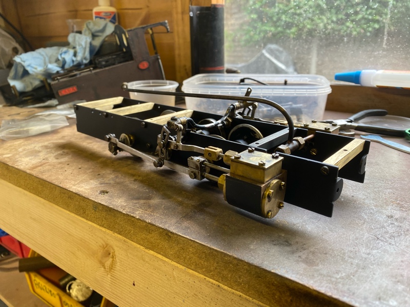

Thanks Aaron, I particularly hate the paint stripping bit! Bit more progress today, rolling chassis is back together and couldn’t resist a quick test fit of the body and smoke box to get and idea of what it’ll look like when I’m finished.
