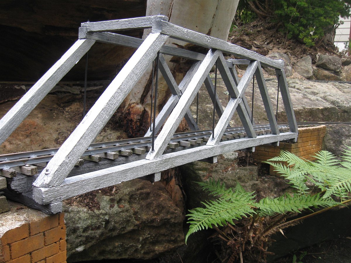

Way back in 1994 when I started building my railway, the 2nd bridge I built was this timber truss. I was really proud of it as it is really all held together by the tension rods just like the real thing.
It’s about 1.2m long, made from tomato stakes. I relocated it slightly in 2003 due to a track realignment, so that it was very close to an overhanging gum tree trunk. Over the years, the tree has grown and leant over so it is pushing on the bridge. I have been cutting into the thick bark for a few years to give clearance, but now I am into the hard wood.
So it is time for drastic action. My first idea was to just invert the truss so the track ran across the top, but some measurements revealed not enough clearance under the bridge at one end. It looks like a new bridge is needed. What a shame – the timber is in perfect condition despite being 26 years young.
I would love to do a masonry or steel arch under the track but it’s a lot of work because the two support ends are different heights.
So I think the simplest design would be a steel girder like this (in styrene) … but I don’t like the absence of ‘safety rails to catch derailed trains! It's a 1m drop to rock for a derailed train!

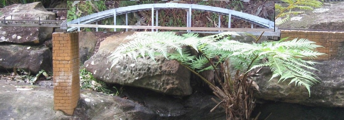

I do have a ‘spare’ steel arch bridge that is 6’ long and if I cut it down to 4’ it is only about 5” high at the centre. But it really means completely dismantling the bridge and rebuilding. Is it worth the work??

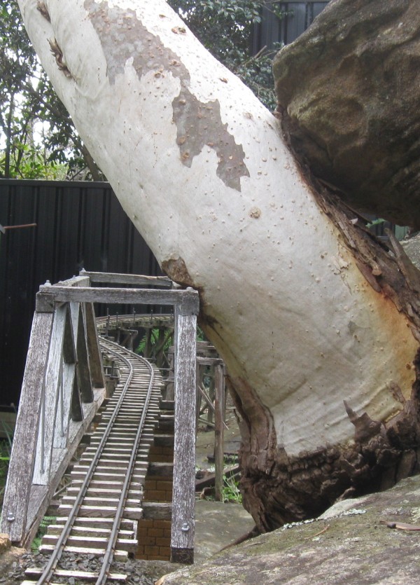

You're up a gum tree here.... sorry. That tree is at a heck of an angle by the look of it. Does it sway much in the wind ? That could affect the alignment. Is there no way you could keep the existing bridge? It is clearly a goodun and one that you are fond of. Can the approach to the bridge be realigned some way so that bridge is further from the tree trunk?
- Posts: 8037
Re: Ideas for a bridge replacemnt?
I wonder if the tree would tolerate having a bigger bite taken out of it? Trees seem to happily survive all sorts of abuse and this would be on the inside of the lean and hence under compression rather than tension.

I'll try and explain why it is impossible to realign the track.
The bridge supports sit on the edge of a high rock shelf. Below that rock shelf there are other tracks at Sandstone, so I cannot even build longer piers.
These pics might help illustrate.
On the right end the bridge sits on the rock but the support wall is right on the edge - no moving it out!! The left end is on a high pier, but you can see it is impossible to move outwards.
I don't mean to be negative and thanks everyone for the ideas. All the offered ideas involve lots of work. I'm still procrastinating!

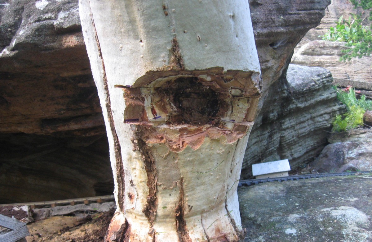

Having procrastinated long enough, I decided that since I had to remove the track and bridge in any case, I would do that and look for inspiration.
And…………
I took the easy way out and just cut further into the tree.
It was much easier to cut with the bridge out of the way! So I have got another few cm of clearance which puts off a new bridge for a few more years.
While I had the bridge out I gave it a few coats of paint.
And here it is all re-instated. Looks just the same as before!
And…………
