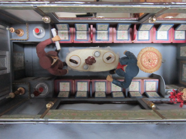

These days I don't go to too much trouble to add interior detail to carriages I build, generally they would be too far away, or at an inconvenient height, to inspect closely. I always fit seating, and a few passengers as required, to make them look used, but little else.
But.... thirty years ago, when I was out on the exhibition circuit, things were different. Layouts were close enough to the audience so that people could inspect everything, and they expected to see fully fitted interiors, particularly in this scale.
I have just decided to make alterations to one of my early vehicles which required removal of the fixed roof..... As you can see, the roof has warped and some adhesive is showing, so it had to go.
This exposed the interior, which represents the Director's Saloon complete with home comforts, artworks, plush seating, food, drinks, and lighting (non working). There is a private toilet towards the front (not detailed) and other little luxuries. It was made so the glazing is removable and I will replace that too. This has allowed me to photograph through the window aperture and gives views not usually accessible...... I am in the process of making a new roof as well as fitting a second motor bogie to the rear of the carriage. I found that the Lima motor bogie, under the tender, is not powerful enough to move the model, even though it was sufficient on the indoor layout. However, I have had to make changes to it from track power to 12v battery housed in a trailing wagon, thereby adding weight.
More to follow.
More to follow.

I like the convex curves on the lower sections of the coach body, not easy to build like that I would of thought. Nice build inside as well.
- Posts: 8037
Another masterpiece, Peter. I don't recall having seen this one before.
A Director's Saloon is on my to-do list, but I doubt mine (when I get around to it) will be anywhere near as elaborate. I can blame the impecunious state of the PLR finances .....
Superb Peter. That's a winner in anyones book.
Love the cream buns by the way...

BTW Peter
Are the details dolls house accessories, charity shop finds or have you sculpted them yourself? The bust of Queen Victoria is particularly impressive.
- Posts: 5728
Thanks again for the kind words..... In answer to Rik's question, most of the interior fittings are from dolls house suppliers, including the window blinds and cushion covers.... wall-paper. The wall mounted light fittings are from a small scale steam carriage model, and the rear windows are 'N' scale church window frames in white-metal.
If it looks about right, use it!

Its a charming item of rolling stock. Impressed by the elaborate curved sides.
The bust of good Queen Vic perched on the shelf is a testiment to the quality of trackwork on your line!

Thanks Peter. I think it's your attention to detail which I really admire, not to mention your skill in constructing your creations. Somehow you have a knack of bringing everything together in a way which works - I'd say it's a balance between artistic flair and technical ability - plus, presumably, a fair bit of sheer effort.Peter Butler wrote: Thu Jul 16, 2020 9:45 am Thanks again for the kind words..... In answer to Rik's question, most of the interior fittings are from dolls house suppliers, including the window blinds and cushion covers.... wall-paper. The wall mounted light fittings are from a small scale steam carriage model, and the rear windows are 'N' scale church window frames in white-metal.

The Director's Saloon is now back in service and working far better than anticipated. The addition of a second Lima motor bogie unit has made all the difference, it is certainly more powerful but also smooths out the running characteristics. It is also very quiet.
I made a support cradle from Meccano to attach the unit from below the floor, having first cut out a section to allow it to fit inside the carriage..... The new roof is now permanently attached and looks so much better..... A third motor is also fitted to drive the flywheel, which rotates in the direction of travel when the Saloon is in motion. The linkage for this is via Delrin chain and sprockets to a home-made crank shaft and slide valves..... Finally, being converted to on-board battery power, I needed a switch and charge socket, which are mounted between the loco and carriage, so not too visible.....

And so it should Peter, enjoyed the close-up of the steam cylinders and motion. It would have been fun putting all that complication together. The new roof certainly accentuates the coaches very crisp lines.
I would be happy also Peter. You say it runs a lot more smoothly with the second motor, does that mean two motors are now powering the coach, or is one in the loco. Sorry for being stupid and asking want for some is simple for them, but for me I haven't been into modelling has long as most members and I am learning all the time.
Another thing is, I didn't know Lima were suitable for 32mm gauge ?

Each new photo reveals yet more detail - eg the surfaces on the steps and the tiny crest on the side of the coach. Stunning!
A neat solution to the problem of being under powered. You must have a secret stash of Lima motor blocks.

Thanks again for your comments, I have to admit I have now started to enjoy this vehicle again after losing interest previously because of its problems. I first thought of building a powered, motorised truck to push it along, but that would have looked ungainly.
As I knew the roof was only part of my concern with it, I thought I should do a proper job, hence the surgery!
Fortunately, I had a Lima motor bogie ( Rod.... these are built for 7mm scale '0' gauge, so fit our 32mm track) This, however, is my last and I know how hard they are to find these days.
The two powered bogies are wired together, one at the rear, the other positioned underneath the tender, both pivot. The carriage is also articulated to the locomotive, so will happily take on all track conditions.
Rik.... I do like adding little details to my builds, but I think is is important to know when to stop, it can easily go too far!
