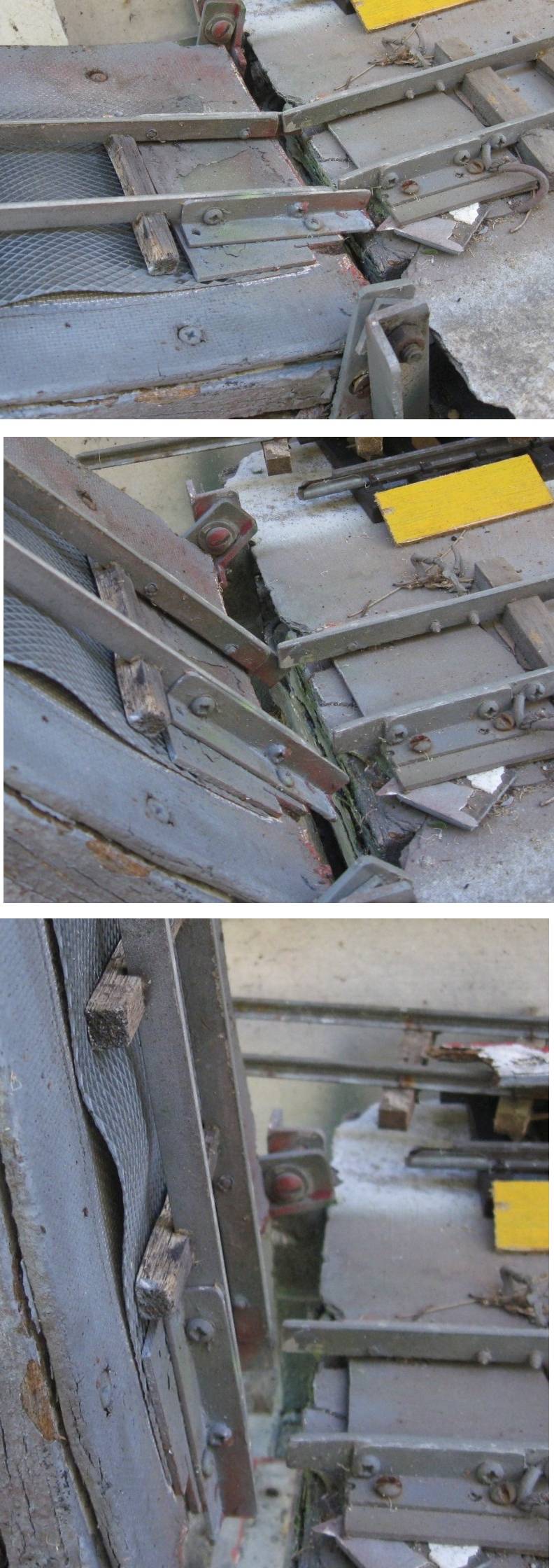

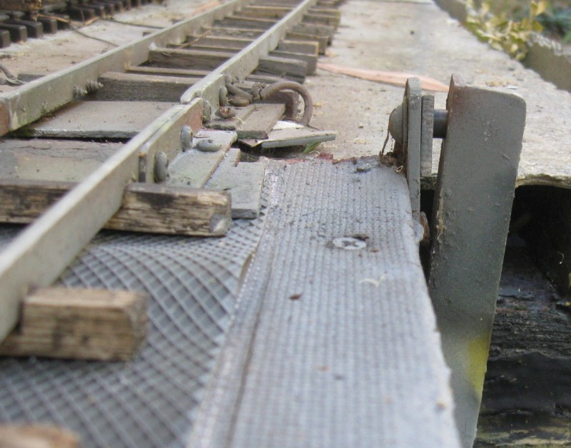

You have seen my bridges.
The 'trick' is to have the hinge pivot ABOVE the top of the rails.
These pics are of my alum bar rail, but I did have a bridge with normal rails at Ti-tree, (now demolished and no pics.)
My 'hinge' is just a few bits of steel with 1/4" bolts - rough and ready but been there for 25 years!
Note that I used 'outriggers' to align the rails as the rough hinge had a lot of play. Easy with the alum bar, but it's not hard to do with normal rails - I just ground the foot down to the width of the head and soldered some 2mm brass on.
I used the same method at the 'lifting' end to align the rails automatically.

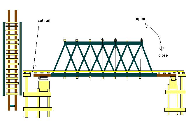

The Rylston Light Mark 1 had a complicated aluminium through-truss lift-bridge, but the mechanics were simple as per the previous posts with the hinge pivot just above the rail top level, the only thing I would add would be to think about expansion and contraction. I fitted mine on a cold day and then couldn’t close the bridge when I wanted to run it on the first nice sunny day!
Newbie mistake, I then worried (after trimming the rails) that the gap would be too great on cold days, but suprisingly that seemed to be ok. I have no science/maths to offer but a tight fit on a hot day seemed to be just right; but the bridge was under the shade of a Leylandi weed.

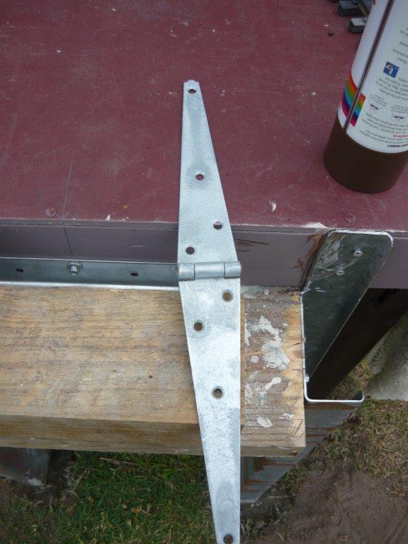

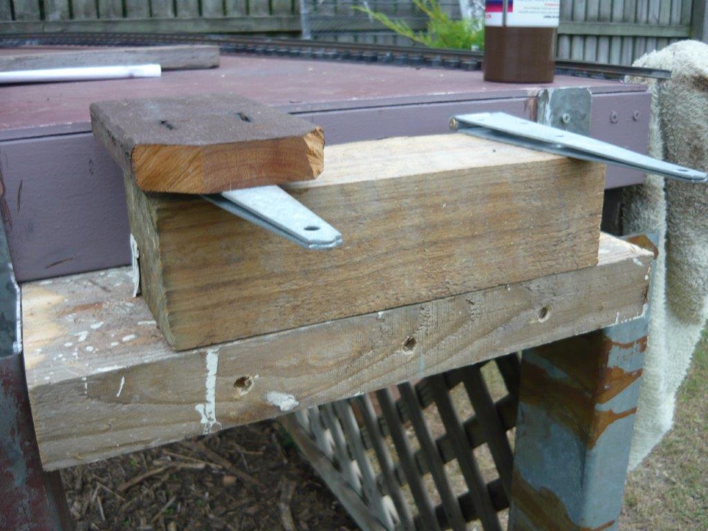

I went with a hinges under the bridge option using this suggestion.
I have started building the hinge area and it is working out well so far.
I am using gate hinges The gap needed to allow opening is not really that wide it is slightly wider than the thickness of the board. The bridge will be made out of hardwood reinforced with steel angle.
To get a level, the hinges will be recessed into the mounting block.
The lower part of the hinges will be cut off to remove the piece protruding into the walkway. This is part of Stage 2 of the build and details will be put on my blog in due course.

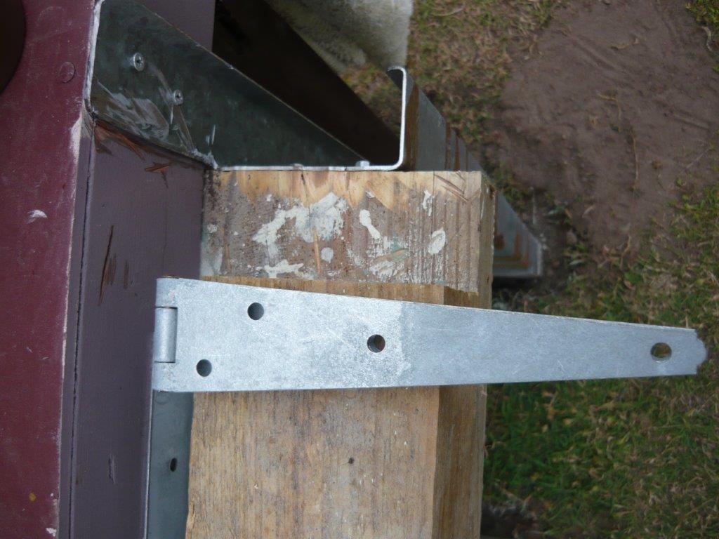

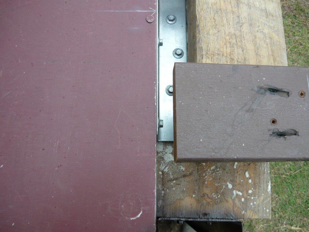

Pictures of the mounting block made from "C" Purlins and the new more robust hinge.
Type of Purlin pieces used The mounting block New hinge

I built the bridge supports out of aluminium box section to reduce the weight so SWMBO can open it, if I made it out of hardwood it would be to heavy for her.
The whole bridge will be made out of aluminium.
Some pictures of the supports an hinges also showing mounting block attaching bolts.

- GAP
- Posts: 895
Re: Lift up bridge questions
Bridge Design MkIII proof of concept jig has been built and the design has been tested with positive results.
As previously stated the secret of the opening is the 45 Degree cuts in the rail which allows the moving rail to drop away from the fixed rail without fouling.
The moving arm of the hinge is level with the baseboard and the gap that the rail folds into is not real wide.
The error I made with the MkII was that I put the bridge support on top of the hinge and when the rail was added the gap was just unworkable as the support folded into it, the bridge support will now be level with the top of the hinge and will not fold into the gap.
So now the bridge construction can now begin following the concept principles.
Closed Open Close up (closed) Close up (Semi Open)
