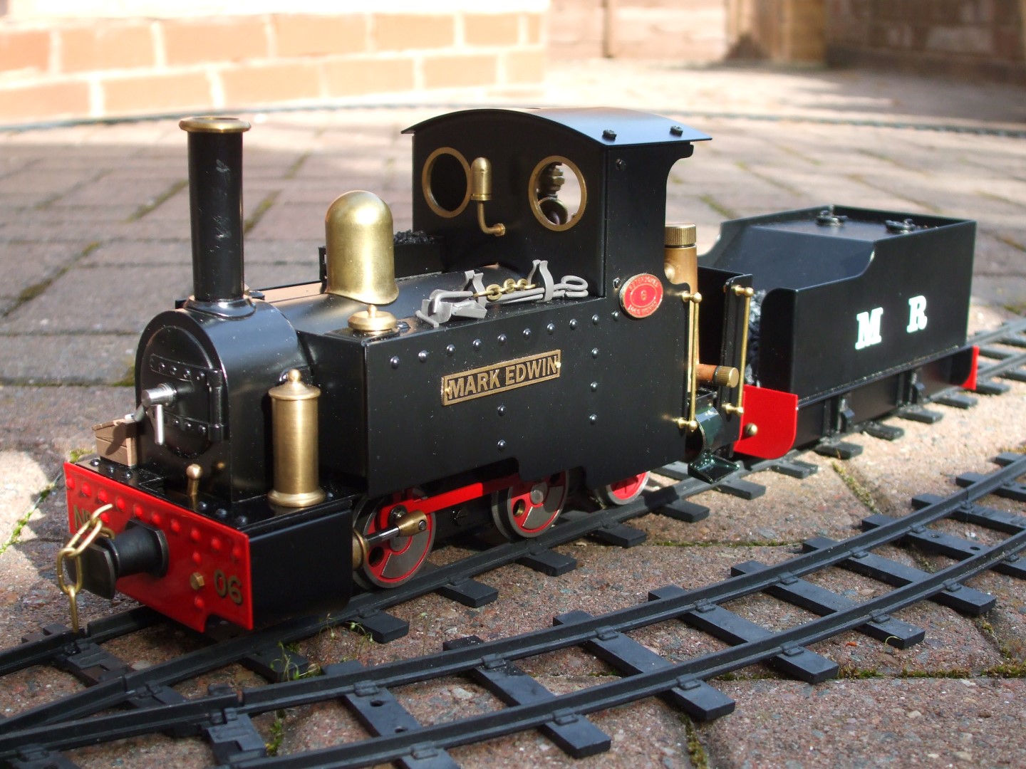

Here is an example of a Mamod loco using the same design of boiler:
Mamod 042 MARK EDWIN 064 (Large).jpg (359.55 KiB) Viewed 130210 times

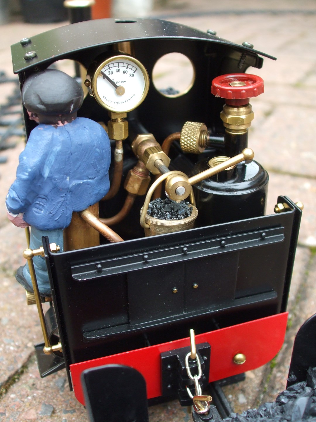

Cab view showing pressure gauge:
Mamod 042 MARK EDWIN 020 (Large).jpg (314.45 KiB) Viewed 130210 times

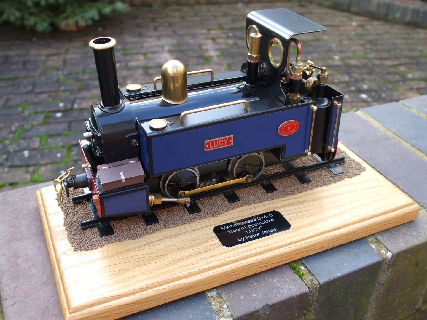

Here is an example of a loco with an original IP Engineering Jane boiler (same design as Dream Steam type boiler):
LUCY_Jan2014 001 (Large).jpg (363.34 KiB) Viewed 130209 times

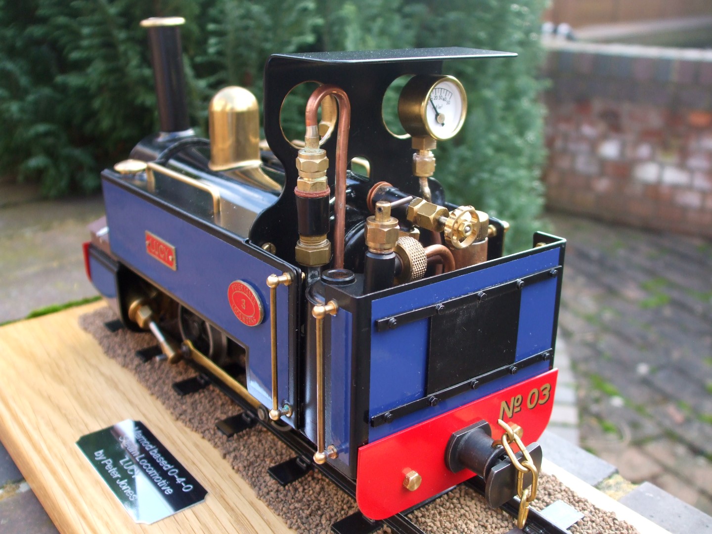

This image shows the pressure gauge position as fitted using a syphon type arrangement from the top of the sight glass:
LUCY_Jan2014 006 (Large).jpg (318.07 KiB) Viewed 130209 times
