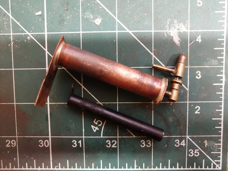

Re: DJB Engineering Accucraft whistles
I had a go at making a larger resonator chamber using 15mm diameter copper pipe (left over from DIY plumbing).
The DJB chamber is shown as a comparison:
It sounds better on air compared to the original so I will steam test it next. Although it is bigger in diameter it fits inside my Roundhouse Silver Lady cab as it is the same length as the DJB one.
The end pieces need tidying up (the larger end piece will be shaped as a bracket so it can be bolted to the cab as per the original).
