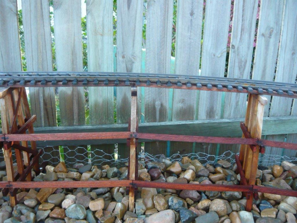

I am asking for some advice on which users prefer for the edge of my trestle bridge.
Attached are 2 pictures showing the trestle 1 with an edge and 1 without an edge.
I am really looking for opinions to help make a decision so feel free to post an opinion.
The edge is nothing more that aesthetics so asking which one is preferred keeping in mind that this is a narrow gauge line.

I'm no expert, but I think the one without edging looks more realistic. My proviso would be that if you were intending to install railings, then the edging strips would be appropriate.

In Australia or Victoria at least, track on trestles was generally ballasted and needed edge kerbs to keep ballast in place.

I'm with Grant. As a Victorian, a trestle without a deck looks unnatural........
That said, after checking some photos, Qld. tramways such as Innisfail and Mapleton had no deck on their trestles.
I would suggest though that a deck on a trestle would make the consequences of a derailment less damaging to locos and rolling stock.

Don't know about Aussie prototype practice, but sleepers hanging out over the edge of the support timbers looks wrong to me.

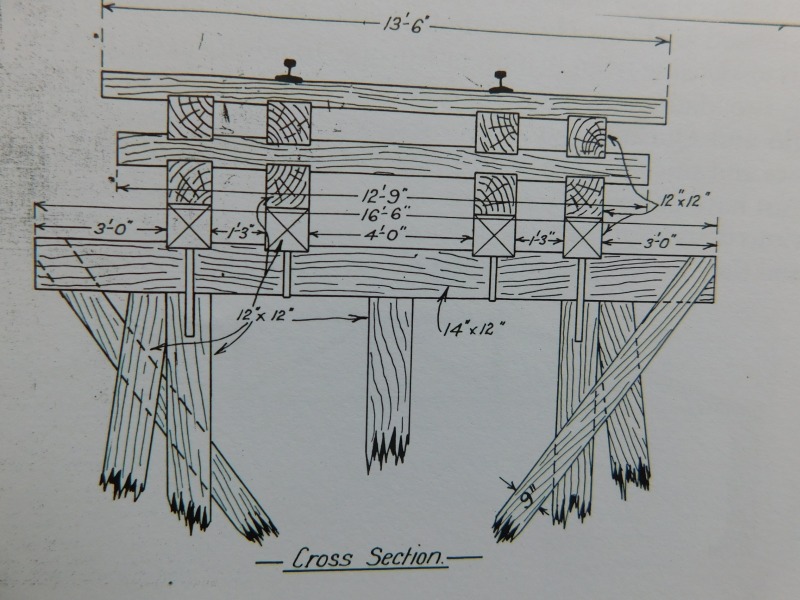

Cross section of open top trestle. From the book 'Bridges Down Under' by Don Fraser.
Sleepers definitely overhang the bearers.

Modeling is always a trade-off of accuracy vs practicality. Me - I go for practicality if it stops locos from falling to the ground. So even though handrails were not prototypical, I use them.
BTW, they aren't really 'sleepers' under the rails, but are longer and thicker timbers.

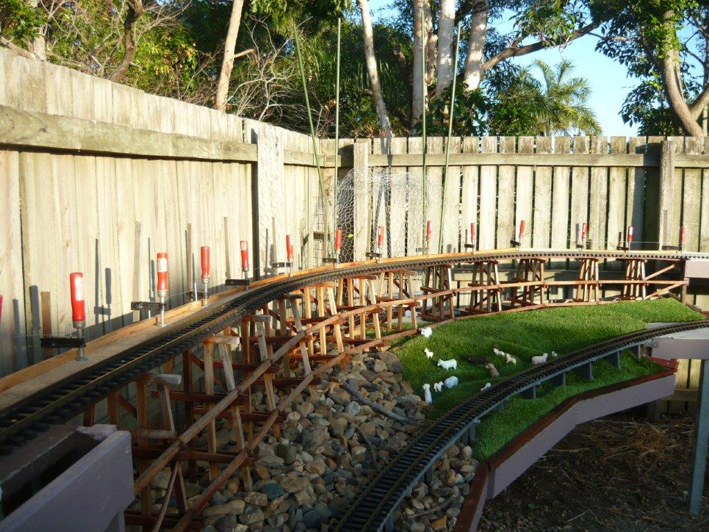

Post by GAP » Fri Apr 03, 2020 1:13 am
I added a walkway with an edge to the back of the high trestle it is not really noticeable unless viewed up close, over time it will fade to a neutral grey colour and will be even less noticable.
The edge was put in to justify the safety rail/fence that I put in to catch a possible topple.
The fence will be made from 65mm galv nails at a height of 45mm with a piece of steel wire looped around each nail.
I "glued" it together with landscape liquid nails and nailed with some flat head nails to hold it in place while it dried but eventually left the clamps on overnight to really let it cure to full strength.
Some pictures.

Looks good.
Instead of the galv wire, I used fishing line - seems less visible and doesn't have the kinks.
The grass under the trestle looks good too.
Greg from downunder.
