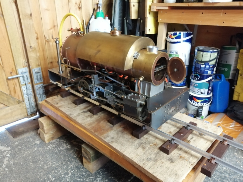

Time for an update.
Depsite running on air a few times I was still unhappy with the stiffness of the motion (she still would not move when pushed or pulled and sometimes would lock up when the regulator was closed too much).
The piston in the cylinder that I had issues with at the beginning of this post was still stiff and therefore required further investigation.
Under guidance from my model engineering friend via WhatsApp I worked out the piston would slide freely in and out of the cylinder, however, when the slide bar was fitted and tightened up that's when the stiffness would be introduced.
After trying to resolve this myself using shims and adjusting the slide bar I decided this was beyond my skill and workshop facilities to resolve and so my friend kindly collected the loco to fix.
He discovered that the slide bar was not made correctly and so a new one was fabricated. There were also other small corrections made to the cylinder fittings that didn't match the drawings so we both concluded that the original builder had done a brilliant job on the chassis, wheels, quartering, etc but someone else then tried to the finish the loco to get it running and lacked the skills required or had poor eyesight...
The loco was returned once tested on air and I then tested it on my tiny test track as shown, it now glides along when pushed or pulled by hand!
The track was supplied by PNP Railways (https://www.pnp-railways.co.uk/) using their plastic clip system and works very well. I may buy more track in the future so I can run the loco up and down my driveway and into the workshop.

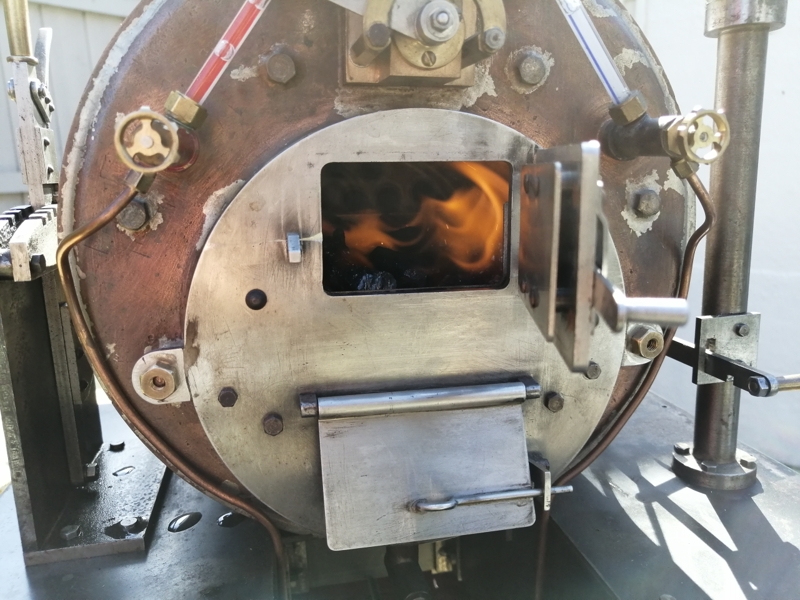

Now the more observant of you would of noticed in my last picture that the chimney was missing. I have never liked the look of the 'Metre Maid' and when purchasing this loco my interest was in the chassis and not the bodywork.
So, after two attempts at buying a suitable quality tube a larger chimney was made and today she was finally put in steam:

The new taller chimney is very effective, I only had to crack the blower open when raising steam and it was shut off during the entire running session.
I didn't find firing her difficult, the axle pump fills the boiler quickly and there is a hand pump as a backup or for use when stationary. Not sure if I will bother fitting an injector as she has a large saddle tank unlike the smaller standard gauge 5" locos where running a tender is required to carry sufficient water (and that the water is cool, very important for injector use).
