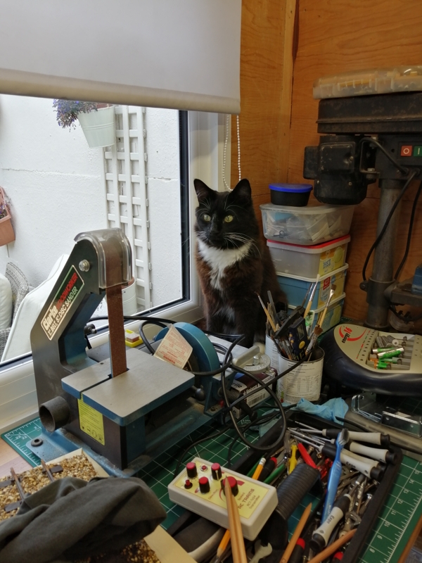

Before I started work on the loco I had to get my workshop sorted out which has taken time and I have had to push myself to get rid of wood, tools and items that maybe one day would be useful but have never been used. This has created a more open space and I feel better now working in there than I have done previously.
Roly supervising clean up work and then falling asleep as per cat protocol:
