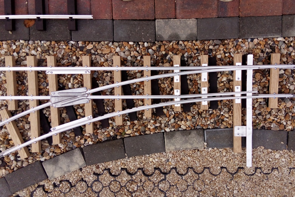

Here is a picture of my newly acquired left hand 10' radius point (Maxitrak) placed on top of existing track to show how it connects up to the siding. I need to move the line of bricks to the left to make room for the point lever, but you can see I have allowed for that.
This "aerial" shot shows how lucky I was in my guesstimate of the curve radius. The point fits pretty much exactly over the existing curves. Even the end sleepers match up.
Just need to think how to make a point lever that little hands can manage, then I can slot the point in and add the siding panel, already prepared. Won't be for a few weeks though, this weekend and next are running days with family and then grandaughters birthday party, so I don't want to disturb the track right now, as it is running very well.:)

That looks just the business Dave. Regarding the lever if it operates too easily there could be a danger of it not holding tight or moving under a train. Not an issue if it is trailing but dodgey if facing. Ideally you could do with some kind of locking mech. I would be thinking of a lever against a quadrant with a pin though both t either end to lock it it place. I have seen something like that on US narrow gauge lines. Of course you could go to town and make a proper ground frame.

Thanks for the useful points (hah!) regarding the lever, Don. I might make the lever a "dummy" so the grandkids can play with it but it doesn't do anything. The existing lever has a basic locking mechanism, not to stop you changing, it but to hold it in position.
