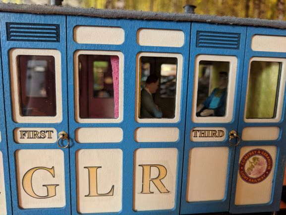

I'm just finishing up a North Pilton Works open wagon that I'm wanting to paint up as a private owner's wagon with custom made lettering. I was leaning towards using Letraset-style dry transfer lettering, but it seems this is hard to come by these days, especially given the larger font size I would need. I'm not adverse to handpainting, but I'm pretty sure I would make a mess of it. I do have some liquid mask I use for painting on the insides of polycarbonate R/C car bodies, but I'm not sure I could cut any straighter with a scalpel than I could paint with a brush...
I'm not looking for anything fancy in terms of font, and plain white is fine.
Any suggestions appreciated.

I print my own waterslide transfers, but there are some downsides.
1. you need access to a laser printer.
2. you can't produce white on a transparent background.

Thanks Philipy, I shall give both suggestions a go, other than the printing, my approach to application/use was what I learnt 45+ years ago making Airfix models.
I suppose varnishing will make any little signs weather resistant and they could be left out.
This shows the slight sheen when viewing at the right angle in the right light:
2019-02-24 11.43.23.jpg (50.65 KiB) Viewed 118511 times
And this shows the slightly damaged R where I'd been a bit clumsy picking it up. You can also see the edge of the decal where I had cut out the individual letters, I have generally minimised this by cutting the letters to the size of the panel, which also aids with the centring.
2019-02-24 11.44.05.jpg (54.29 KiB) Viewed 118511 times
