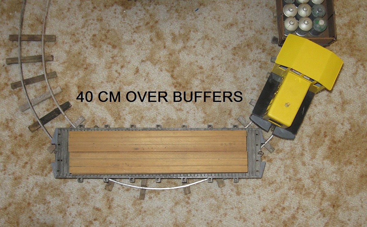

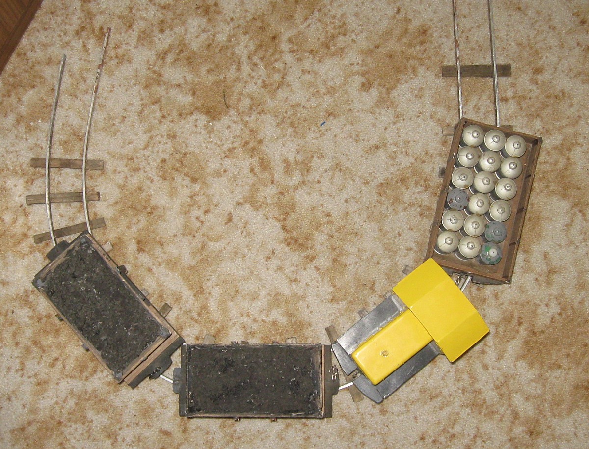

I did find on the web, that 24” diameter curves are possible, so I built a semi circle with the outer rail 12” radius to test. I doubt I’d ever use a full semicircle on a layout – this was just to be sure I could!
here’s the loco and 3 cars: showing possible centre buffers and a stupid looking bogie wagon – I was thinking of a 12” long passenger car, but would probably look horrible.
