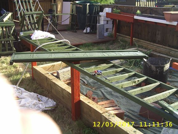

There's some earth moving required, so barrows & sons will be required very soon.. I been having second thoughts about the lattice girders for the third bridge. I had to shorten their length to fit, so I sprayed a small section of the waste, but the result didn't please me. I think a length of galvanised steel anglebead from Wickes, pinned along each side will look good as safety rails. I'll get some tomorrow. I've started assembling the bents to create the trestle section that will run between & above the two areas of decking, close to the bar. I would have got more done but a large green water tank filled with odds & ends & a pile of white masonry blocks have been recently (last Saturday) stacked on the line of my permanent way. The plant troughs through which the rails will pass were constructed in part with old stair treads replaced in the house about three months. They were bone dry & I used them for the bottoms of the two troughs. Well, they are now re-hydrated! Buggrit.

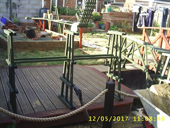

The three bents are now assembled as a freestanding unit & I am running out of timber, so i must wait until Monday for another delivery. I am using 4.8 metre lengths of tile battens, imported from Sweden. They are 250 mm X 380 mm & very roughly sawn. I sand them to remove most of the splinters; gloves are still recommended when handling them however. There are 10 to a bundle & cost only £21-00 per bundle from Grant & Stone & I get free delivery, courtesy of my youngest son's business.

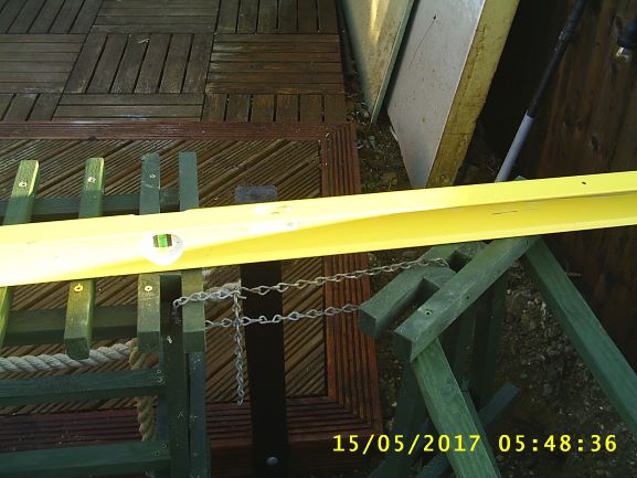

The rubble in the space between the two decks was dug out. The three bents that had been fastened together were placed in position on heaps of dry mixed ballast & cement & adjusted to be level with the bridge over the pond etc. Then water was misted over the foundation& left to set overnight. That was Saturday.
A late start on Sunday was interrupted by lunch with family & friends at a local pub, followed by a BBQ for other friends this evening. After they left, I placed the final two bents in place & secured them in position with more dry mix, before misting with water as before.

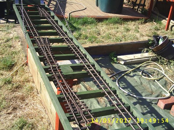

Loose laid horticultural grit. The track is secured with only three stainless steel pins per track on the white walled bridge & pins where the trestles connect with the planters. The tracks on the planters are free to move laterally, but the ballast holds them in place. I'm going to seed the ballast with moss & Angel’s Tears (Soleirolia Soleirolii).
