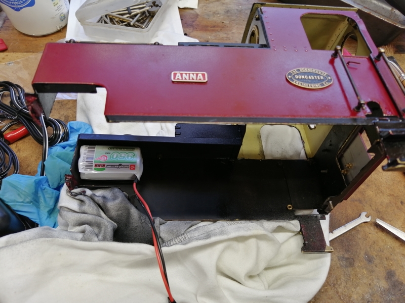

Re: Roundhouse Lady Anne Regner whistle fitting
Added the new battery, switch harness and charge socket today:
She should be going home tomorrow so I might be able to start work on my own projects
