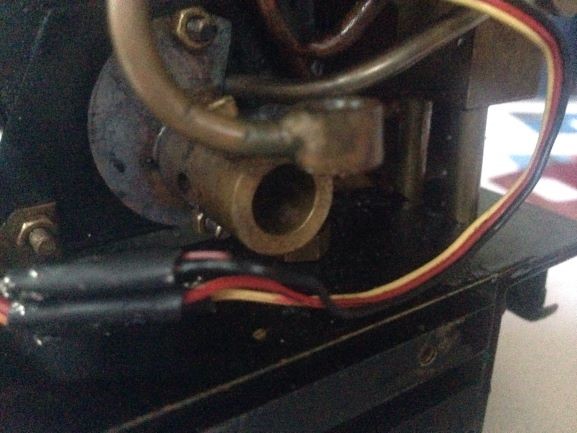

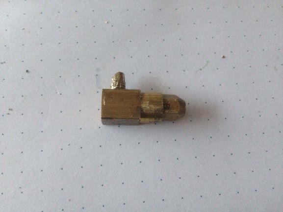

Gareth McGrillen
Re: Merlin Spares
Here are three images depicting the broken part and the cab showing where it went.

Re: Merlin Spares
Hi Gareth
The Merlin banjo thread size is M5 x 0.8mm. They also used PTFE washers to seal the joint.
Hope this helps.
Hope this helps.
