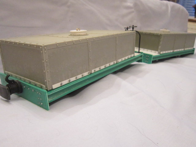

The two WW1 water tanks, which I purchased with the two pairs of bogies, have now been put on four wheeled chassis. They were too short to have been anything to do with the bogies so gave me the opportunity to build more wagons......
I managed to find brake stands in my 'come in useful one day' bits box. They are from the Bachmann carriage conversions I did some time back and have now been put to good use.
Since taking the pictures I have now added brake gear and textured plate at the balcony ends and they will be going into the paint-shop tomorrow.

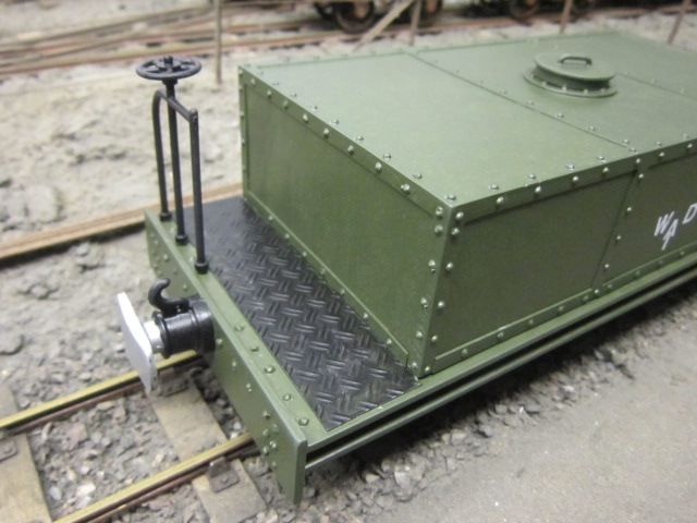

I have been doing other things over the last few days but found time to finish off my water tank wagons. They are not scale models of prototypes, very few of my builds are, however I think they give a fair impression of their intended purpose and period......
Also, having been inspired by Philipy's 3D printed brake-gear, I have fitted a vague representation to these wagons and I'm now in the process of retro-fitting similar to all my stock. It was remiss of me not to do it earlier and I have been shamed into it!

Hi Rod, thanks for the comment. The brake gear is all scratch-built from bits of plasticard, it is surprisingly strong now it is welded together with solvent so I hope it lasts in use. The brake shoes aren't detailed but when seen from a distance, and with low light levels in shadow, I am quite happy with them.

Given your attention to detail Peter what's with the shiny wheels?
- Posts: 5717
You're right Tom.... they are shiny aren't they?
I certainly overlooked that as an item of any importance but, looking at the pictures above, they disappear underneath the wagon at track level and I know they will rust naturally if I just leave them alone.
What do others do about this?
I usually paint mine with Red Brown Humbrol inside and out.

The VR painters never bothered masking off the wheels when they repainted rollingstock and the overspray meant the wheels were whatever colour was used to paint the running gear.Peter Butler wrote: Mon Dec 31, 2018 7:18 pm I certainly overlooked that as an item of any importance but, looking at the pictures above, they disappear underneath the wagon at track level and I know they will rust naturally if I just leave them alone.
Since I follow VR practice the wheels on TVT rolling stock are painted the same colour as the underframe or bogies, usually in situ. I don't bother masking treads either and clean any overspray off with a pipe cleaner and paint thinner before the paint is fully cured.
My only exception to painting wheels underframe colour are timber tram log bogies. The prototype ironwork wasn't painted and just left to rust, so the wheels and other ironwork are painted rust colour.
Running steam locos, there is usually enough oil left on the rails to keep the wheel treads of steel wheels from rusting.

I wipe metal wheels with a cotton bud dipped in Birchwood Casey Gun Blue, which I've had for very many years. Don't bother with any thing else, just wipe and leave. Steel goes a sort of dirty black colour and brass goes a rusty brown colour.
Just like to add you can't chemically blacken Accucraft wheels as they are plated (nickel I believe).
IrishPeter
Mild steel will rust here, as Virginia is rather humid for 6 months of the year, so I don't usually do anything with the wheels - just wait. Stainless, etc., gets a little help from the rusty brown paint pot. I find anything too shiny is a distraction, especially as mine are supposed to be working railways, not tourist lines, though domes will get a little elbow grease from time to time.
