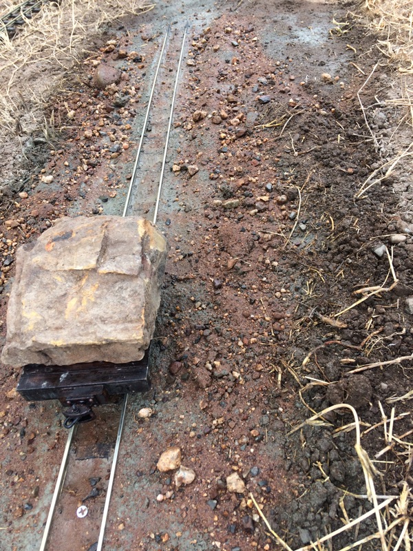

Ok, following two photos show my track laying effort today. Quick disclaimer - I have no bloody idea how to do track work, I’ve just seen bits and peices of how other have done it and thought I’d give it a try, so here it goes.
First , I found some old pavers that my wife’s grandmother had stashed up behind the feed sheds, so I went and stole them.
Next, I dug a trench the approximate width and depth of the pavers. I thought about mabey Putting some fine rock, or road base in the bottom of the trench to assist with drainage , but I didn’t have any on hand , and didn’t feel like driving all the way to town to get some , so stuff it, I went without . Besides , it is pretty rocky ground anyway and drains pretty good when we have storms. I then laid the pavers in place, carefully packing them Down and trying my best to level them all as best I could. I filled in around the pavers with soil once I had done .
I gave it a bit of water and left it overnight to settle . Not sure if these actually helps or not.
Today I drilled into the pavers and bashed in rawl plugs ( don’t know what they are called over in the UK ) which allows me to screw the track too the pavers. I then took a bucket and tipped in dry , 50/50 concrete and dry sand and gave it a mix around. I tipped it dry onto the tracks and spread it around using an old paintbrush, once again donated ( stolen ) from nannies shed. I then gently watered the mixture in using a weed sprayer bottle/ handpiece to make sure it was a nice fine mist and not washing any of the mixture away. It ended up with good coverage , but the colour was poo poo..
I decided to try taking Some of the sandy soil from my dirt driveway and spread it over the top and water it in too add some colour and texture too it. The last photo is taken while it was still wet. It’s now dryed well and hard as a rock, and I’ve swept away those larger pebbles you can see in the photo and it looks pretty good I think. Will take another photo tomorrow when it’s dry again because it just started to rain here as I’m typing this

Dan,
Remember if your laying track with our summer temperatures about to hit, to allow gaps for expansion.
Personally I don't like to see track tied down too much, being a mix of plastic and metal (I'm guessing
yours is Aluminium!) it needs to move and if tied down somethings got to give. All my ground level track
only had two screw fastenings, and I removed those years ago.

Im using Peco flex track that has nickel steel rail. There is only two screws per length holding it down, one right at the join, and one half way along. But I did notice once the concrete mixture had set it actually holds the tack very firmly by itself .
Steaminnthnsw
Re: Shannon creek timber mill tramway
Yeah, planning on it . Everything was still wet when this pic was taken

Here’s a question for those with a bit more experience than me when it comes to track laying. Instead of using pavers or brick, could I use a H4 treated pine Batton or something similar ? Mabey win added protection of a coating of sump oil like I do with fence posts before I put them in the ground ?
H4 treated pine is supposed to be good for 15 years when in contact with ground as far as I know.
My reasoning for this is it would be a lot quicker to lay track nice and level this way . It’s pretty time consuming packing and leveling each paver trying to get it just right.
Thoughts ?
Thoughts ?

Have you considered just laying it straight on levelled ground, and if you want to fasten it 4" flat head
nails or galv. wire sort of mini tent pegs. Would your ground be ironstone? looks a bit like it in the photo.
Trouble with timber down here it might not rot too readily in the ground but it can twist and bow. I'm
on sand here and all ground level track laid directly on the ground.

Yeah, I didn’t consider the warping/ twisting part. Figured if it had been properly seasoned that wouldn’t be an issue , but having said that it may absorb moisture from the ground I guess and may cause it too warp.
I’m mainly using flex track so I think I still need to anchor it , even if it’s only while the concrete sets.
mabey I will try the nails idea and see how it goes.

My track is all AMS Flextrack code 250 in 5ft. lengths. Makes for nice curves and transition into them.
Curves are where you'll find the most movement, you can have short or long straights but all the longtitudinal expansion goes to the curves and in our summer heat it can be quite substantial. You mention a long straight on a 1:40 grade, a long sweeping curve adds a more pleasing point photographically, and helps ease the large expansion at the end of it. From a timber tramway point of view most lines were pretty curvy on account of terrain.

The first half of the grade has to be some what straight due to fence lines , diveway ect, but once it gets down to about knee height the plant life will thicken and there is some large rocks ect to negotiate around so will produce some nice curves and allow the track to disappear from sight in places which also adds realisim and makes for nicer photographs
