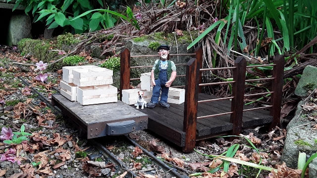

Post by bazzer42 » Fri Jun 08, 2018 2:48 pm
Ted and Nipper stop unloading new packing crates to pose on the new loading dock.
A bit of treated pine, some hardwood chair posts and some steel tig rods that should rust. The dock serves the business end of the big house that is off scene in the neighbours garden. I finally found a use for the small nail gun I bought a few years back, spitting nails becomes addictive. Final height will go up with ballast.

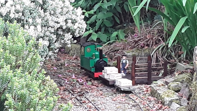

Post by bazzer42 » Fri Jun 08, 2018 6:18 pm
Testing clearances after ballasting it seemed a shame not to take a picture. The sharp curve to the left goes to a sand works or some sort of works that needs tippers and a rusty hopper to load'em :D

Really like those packing cases. Are they your own design?

Post by bazzer42 » Fri Jun 08, 2018 7:13 pm
Not my design I'm afraid. Dolls house 1/12 so slightly overcame but ok for me. I'm slowly cutting handles in the ends, adding weathering and Fairway Estate lettering with a cheap john Bull type printing set.
When I feel a little flush I top up with dolls house bits and add some crates to the order. This time it was Nipper, a thermos, a scythe and some tools.

Post by FWLR » Sat Jun 09, 2018 6:27 am
Love your’e Loading Dock Derek, it doe’s look robust. And it will soon look weathered near that greenery. :thumbright:
Who cares if the packing case’s look oversize, they still work for me, has does Nipper, brilliant little addition mate. :thumb right:

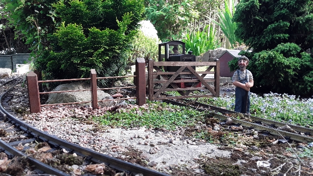

Post by bazzer42 » Sat Jun 09, 2018 5:27 pm
A few shots of the new gate installed by Timmy this afternoon. He built the hinges by wrapping brass strip around a tig rod and soldering the tails. Hooks in the post from bent aluminium tig rod. The gate could do with some strapping at some point.
I'm a bit concerned about the slight upward lift of the rails but my circus.....

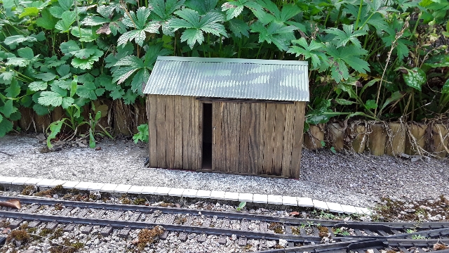

Post by bazzer42 » Sat Jun 09, 2018 5:38 pm
I also fitted the door to the shed at end of the line. My door suffers from inslidability (that confused spellchecker) due to bowing and I may, may, replace it with a steel door one day not soon. I also gave the roof a sprinkle of filings to see what muvva nature can do.
The siding and general mess in the second picture is the next job on the to do list.

Post by tom_tom_go » Sat Jun 09, 2018 5:56 pm
Bake bean cans roof will rust well outside but if you don't want it to go too rusty wait until it goes the colour you want and then lacquer the crap out of it.
