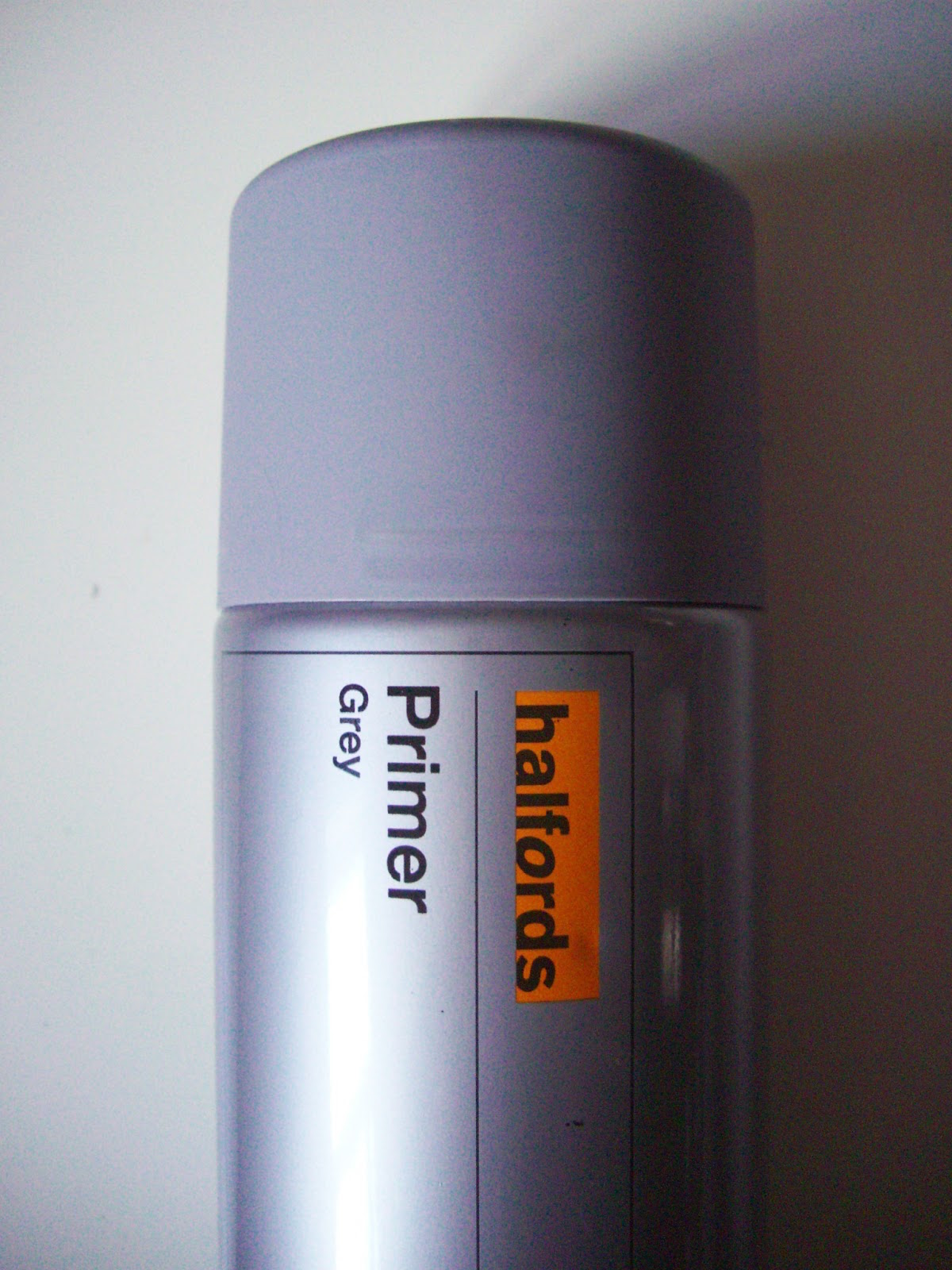

Yes - agree with the advice above - a good clean first, then get it really dry and then I use grey primer from Halfords - I've tried a range of different brands but this seems to work best for me - then you have a great surface to apply your colours to, either from another can or via brushes - used on Swift Sixteen and many other kits and builds

Hmm, I've always used the plastic primer rather than the standard one

I use plastic primer, etch primer and general primer as appropriate. All from Halfords.

Sure there isn't much difference between the two - I just know I use the normal stuff mainly because as an owner of Landy Defender, I always have a can handy aside the Epsom Green!
- Posts: 5715
Re: Painting Swift Sixteen kits
Can't knock Halford's products as I've always found them of good quality, although can be more expensive than my preferred choice of primers and finishes...
The ordinary grey primer is not shown as I have run out!
I buy these from 'The Range' but I'm sure there are many other outlets near you. They are quick drying, give excellent coverage and superb finish. They are also cheaper at £5.99 for 400ml. The colour variety is more limited but Halford's acrylic can be used on top of these primers.
