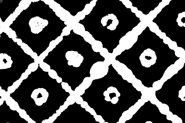

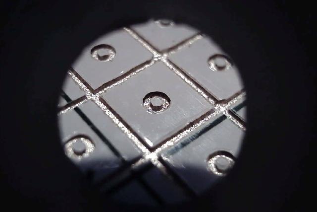

I'm using a night-school wood cutting laser to cut thin metal.
- coat metal with paint
- coat reverse side with gaffer tape to hold it together.
- laser through the paint down to bare metal
- etch through the metal without attacking the paint
- scrub off the paint.
These 0.25mm aluminium alloy squares are 3mm across with 1mm diameter pits. Grooves are nearly through so I can just snap them apart with my fingers and push out the pits with a pin.
While the detail isn't super-smooth under this cruel magnification, it's actually a lot smoother than a 300dpi letterpress half-tone image.
But if you forget your job and seriously over-etch right through, the resulting undercutting and trapped bubbles look Really rough under the microscope:
yet, once 'rusted' with ferric chloride, those apparently 'ruined' parts (now separate, but still stuck to their gaffer tape) are perfect square washers for an ancient structure:
David
