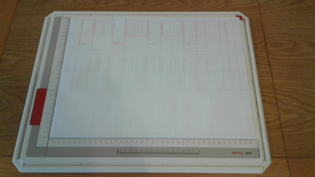

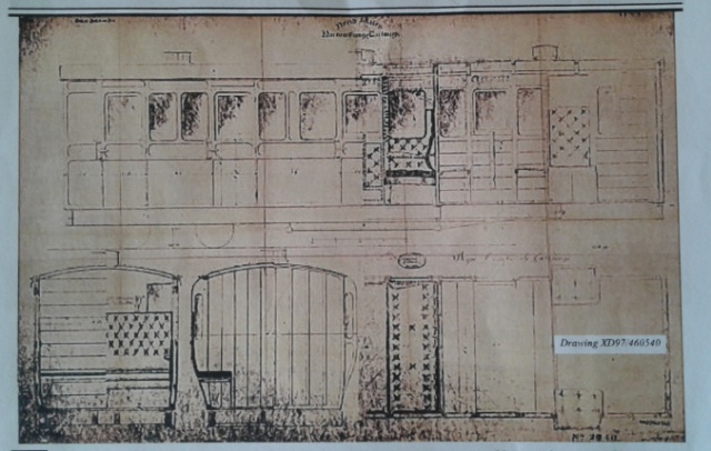

The first job was to scan the Caernarfon drawing onto MS Publisher page. Then crop the scan to the exact edges of the coach.
Resize the scan to 402mm (25' 2" full size converted to 16mm to the foot) and set Publisher to print the scan onto a poster. This then prints out on 3 pieces of A4, automatically adding an overlap to allow for gluing together.
Ms Word also has these scanning functions
From this full size scan i was then able to produce my own working drawing on my Rotring drawing board (just fits) from my collage days in the early 70s.

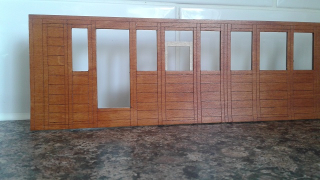

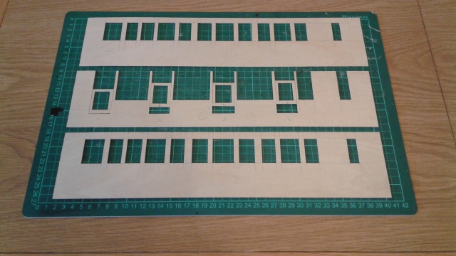

I then was able to transfer this drawing onto 3 pieces of 0.8mm ply to make one side of the coach. I have decided to make the sides as a 3 layer sandwich with the middle layer cut to allow for inserting and holding the glazing.
I have also cut out seperate droplights to slide up and down in runners in the central layer. Hopefully to allow for opening windows in the completed coach. All this cutting out has obviously to be copied for the second side. Use a sharp blade and replace frequently.
I have yet to cut out the openings for the ducket in the guards compartment.
D.

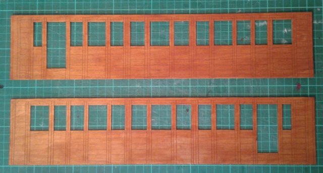

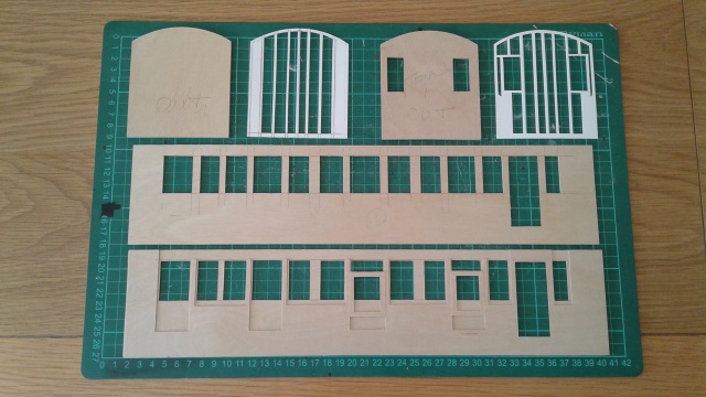

Hi all. Latest update.
Dut to the central glazing layers of ply having rather delicate parts i decided to get them glued to the front layers of the sides. (One side shown). As this coach has tumblehome sides i left the lower 15mm of the sides without glue so that i can insert glue with a fine brush and form the tumblehome curve along the lower edge at a later date. Please be aware i have not done this before so we will have to see how this goes.
I have laid a couple of the sliding droplights in position to give an idea of how they should work.
Above this side is the coach inside veneer that will have all of the internal detail scribed onto it and varnished before gluing in.
I have laminated the two ends using 3 layers of ply as before. One is plain and the one for the guards compartment end has two window openings cut into it with the central ply layer having larger window cutouts to take glazing that can slide in from the top.
I have cut the beading for the two coach ends from a sheet of plastikard. I had to work this out myself from the photograph as it is not shown on the plan. The side areas of the beading have not been completly cut yet as these will need to be profiled as the tumblehome when i have worked it out.
Progress might be a little slower now after the holiday weekend but i will keep you posted as it progresses.
David.

As a Welsh Highland Railway society member and modeller I must point you in the direction of the 'Welsh Highland Heritage Group'. They are a fantastic resource for all things old WHR and NWNG railway.
Google-
Welsh Highland Heritage Group.
From the menu choose 'Journal'
Find number 62
On page 10 you will find the drawing I am using.
Hope this helps.
David.

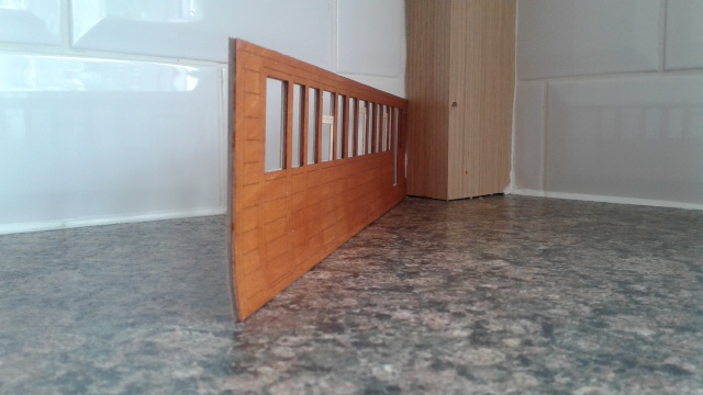

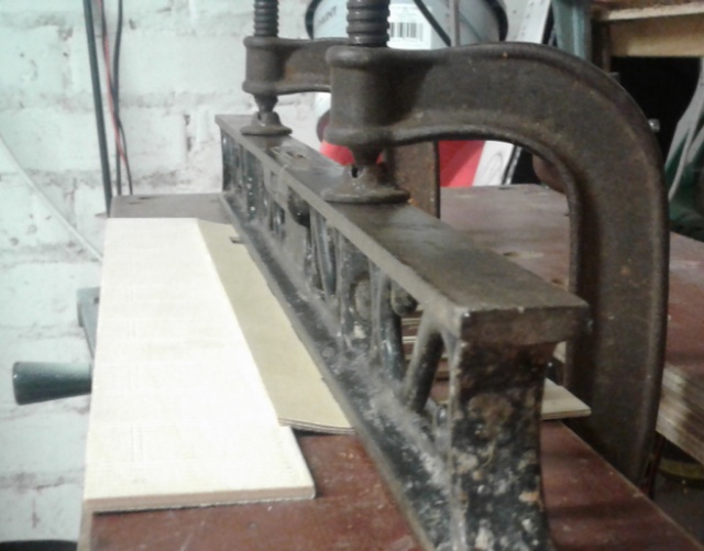

Latest update from yesterday.
I felt it time to attempt the tumblehome. In a previous post i mentioned that when i glued the middle layer to the outside layer i left the lower 15mm unglued. Now it was time to open these two layers a little with the end of a metal rule and push glue between with a fine artists paintbrush. This side was then cramped down on to the surface of my workbench with a piece of 3mm ply under the lower edge to form a curved edge hoping that this laminated curve would stay permanent once the glue had dried. Moving on to this morning i glued the stained inside panel to last nights work to form the third layer of the lamination using edible weights and bulldog clips to hold the panel to the tumblehome curve while the glue set. Now dry i am very pleased with the result, bearing in mind i had not attempted a tumblehome before. Due to a slight spring in the plywood i have a bottom edge that is about 2.5 mill curved inwards from the vertical which looks a good representation of the real thing shown in photos and the plan. I also slipped in one of the droplights from the top and it held itself in position well with just a little friction, though they are still untreated wood. I think my next job is to work on the coach ends including copying the tumblehome curve onto them and finishing their beading.
David.
David.

- Posts: 5722
Re: NWNG Railways No.1
Now that I like...... just trying to think of a way to make the process work using plasticard.
- River Lin
- Posts: 411
- Location: Leicester
Hi.
I would have thought it would work. As long as the solvent adhesive between the layers of plasticard stays liquid long enough to allow you to form and cramp the curve before curing you should end up with success. The layers need to slide over one another as the curve is formed.
David
David
