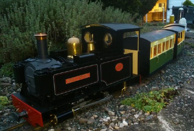

Post by tom_tom_go » Tue Nov 17, 2015 8:12 pm
Progressing with the body kit although I am still trying to perfect my soldering skills:
The mini blow torch I bought does not get the solder hot enough and cuts out so I have gone back to the larger Go-Gas torch although having to be careful not to get everything too hot.
Having a wet rag to hand to cool parts after soldering seems to help.

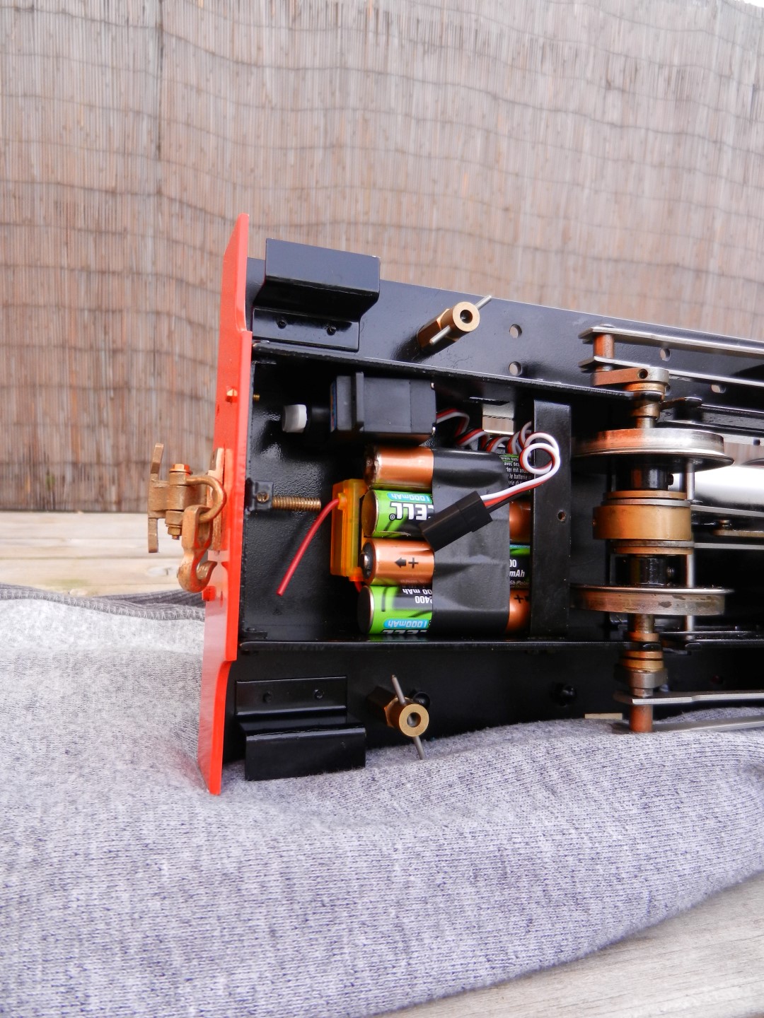

Post by tom_tom_go » Sat Mar 19, 2016 5:00 pm
I think I am finally happy with all the R/C gear.
The charge socket is flat against the body so you cannot see it:
The regulator servo along with the receiver, battery pack and on/off/charge switch is all hidden below (took a while to figure out the positioning of components, however, nothing touches the loco body and it's been fine during testing with no loss of signal/overheating:
