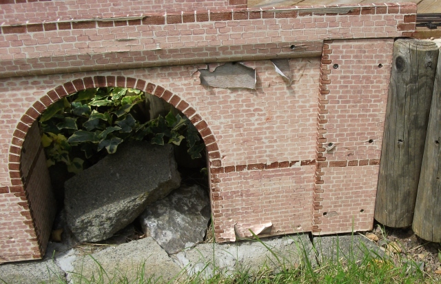

The original three arch bridge was made of plywood in 2008. I took a lot of care in treating the timber before priming and painting it, finishing off with varnish. But still the damp got in and made a mess of the paintwork, and it has started to rot the timber. Some may say 7 years is not too bad.
A couple of pics to show the state it was getting into. I used to use it as a stage to take photos of rolling stock.

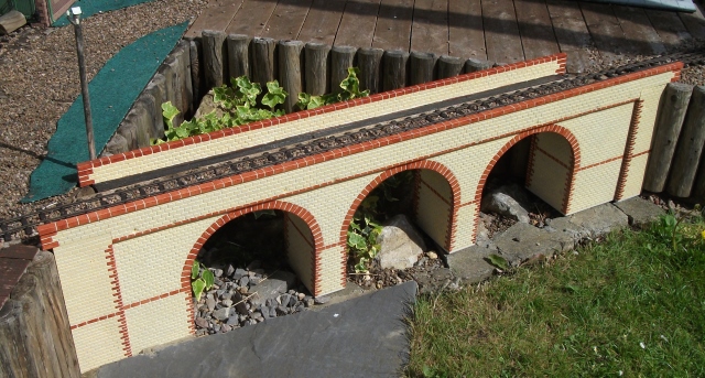

The replacement is made of Foamboard with stone joints pressed in, painted with B&Q stone paint sample pots. Looks quite bright at the moment, but I expect that it will tone down in time.

That viaduct looks very good indeed and as you say I am certain it will tone down a bit over the next few months. You could try and help it with a wash of very dilute black paint, but patience is a virtue as they say, let nature take its course.

Looks good. I had a similar problem with wooden based buildings, no matter how hard you try to seal it water gets in.
What is foamboard and where can you get it?
I tried perspex which is fine for smaller buildings but looking for alternatives for something bigger.

The Board is Foamed PVC – used a lot for signs and displays.  There are other Foamboards, some of which have a paper surface, not suitable for outside, and not so easy to glue together.
I have been getting mine from http://www.foamboardonline.co.uk/5mm_Fo ... oam_PVC_A3
at a cost of £18.00 for Ten A3 sized sheets, plus postage, which is a lot cheaper than using thicker Plasticard which I used to do for my buildings.
I have been using mostly the 5mm thick material, building up thicker sections by sticking it together.  You can then file it, carve it, or press into the surface with knife or screwdriver or whatever.
I normally stick it together (and to Plasicard although you have to be careful not to melt it too much) with the plastic pipe solvent sold by Wickes (behind the counter and not on display due to the solvents).
I have also used Delux Material Foam2Foam adhesive, although this is not as good.

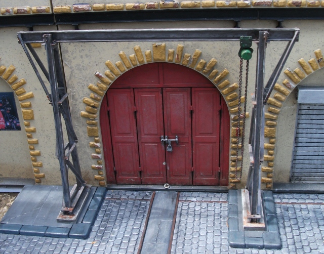

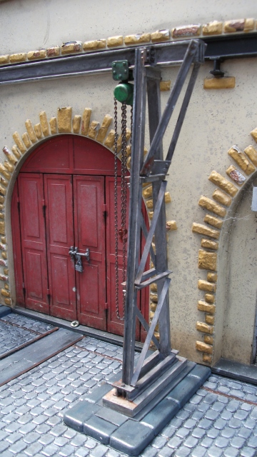

I’ve added another little point of interest, a gallows hoist in front of an arch doorway – as usual all in Plasticard but not the chains of course. These came from my parts bin and so may even have been from some of Erika’s (the wife’s) broken and discarded jewellery (‘Argos Gold’), but I painted them anyway.

Excellent John, beautifully made and looks just right in that location, exactly as it should be!
I have been toying with the idea myself and have a site outside my engine shed where it would be appropriate I think? When I get round to it I will post pictures. I thought of making it with a small truck mounted on rails at the top giving the impression of greater lifting capacity. I have probably seen something similar but can't remember where!

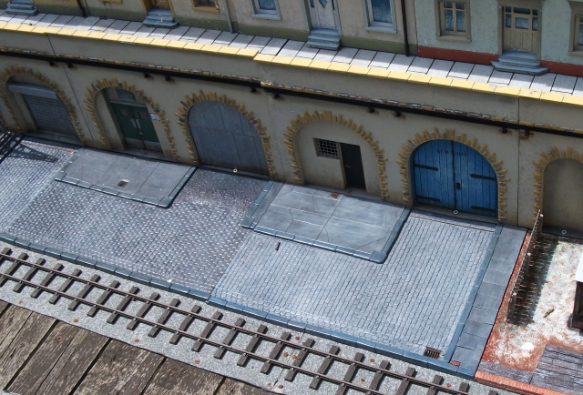

The POLA Station has been sitting there all alone for a few years, and so I thought it was time it had a bit more platform (in Foamboard). A ‘typical’ Germanic railway building was also knocked up with Foamboard walls and Plasticard roof and details to populate the platform (plus a cast metal ticket machine – I can’t remember if this came with the original Station Kit of was obtained separately). The doors, suitable marked Damen and Herren, face the platform edge, so cannot be seen from the normal viewing side – still I know they are there, much like the internal timber roof structure which you can’t see from any angle.

To finish up before the worst of the weather, some more areas around the Station Yard area were covered in Foamboard sheets. Mostly only 2 mm thick, this material was obtained as scrap from a local signmaker. Hammered with a small bit of paving stone to put random dents over the surface and then just a few passes with different coloured spray cans to tone the colour down a bit.. Adding a couple Locating Bases for the Water Tower and Coal Stage - these are not at left out at present, but then we have no Steam Locomotive on the FBGR roster at this time.
We have started to do some ballasting, not bad £10 for three 10kg bags from Mole. It has to be washed before spreading and is fixed down with diluted PVC.
With Winter now upon us, the completion of the Ballasting will have to wait for the Spring, and in the meantime, I have been looking at the state of some of the Fence Buildings and Retaining Wall, and will start to take them home, one or two at a time, for repair/refurbishment and repainting.

The ballast make such a difference and completes the picture. Certainly the weather is not the best for attempting this job but it will be worth waiting for Spring so you can continue.
Great pictures looking along the length of your railway, the structures set the scene beautifully.
