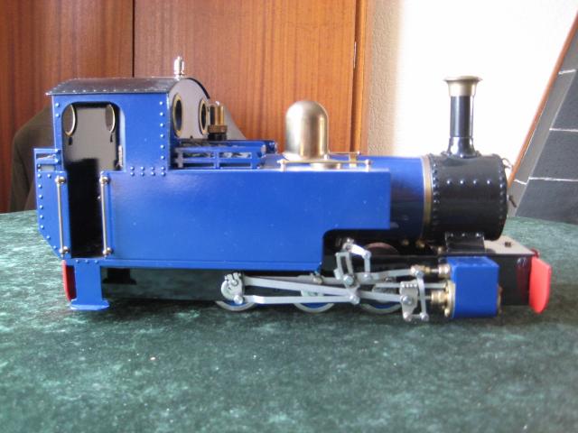

I have just bought a Roundhouse Lady Anne with Brake van which I could do with some advice.
I would like to know if anyone knows its maker? My other question is it is 45mm can I re gauge it to 32mm?.
It got a bit damaged in transit, one of the side lower pieces has broken off. Both were very well packed but the loco sustained a slight bend to the front buffer beam. So annoying because the seller spent a lot of thought and time packing them.
Very pleased with them both. Lady Anne was built for him for his 65th birthday and never run apart from setting up with air.

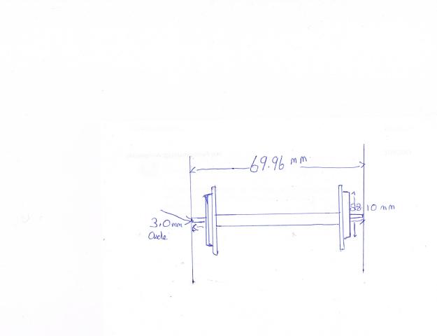

Any way I have removed a set of wheels and would like to know if anyone can suggest where to get a set o 32mm wheels and axles because present ones are 45mm.
Total lengh of axle is 96.96mm end thickness 3.00mm to be able to fit present axle boxes.
